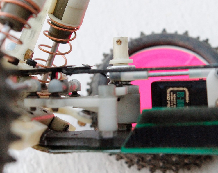

i forgot to mention the spring perches that cedric pointed out in your stealth thread. can those be made too?
- Attachments
- spring perch.jpg (7.3 KiB) Viewed 8057 times
