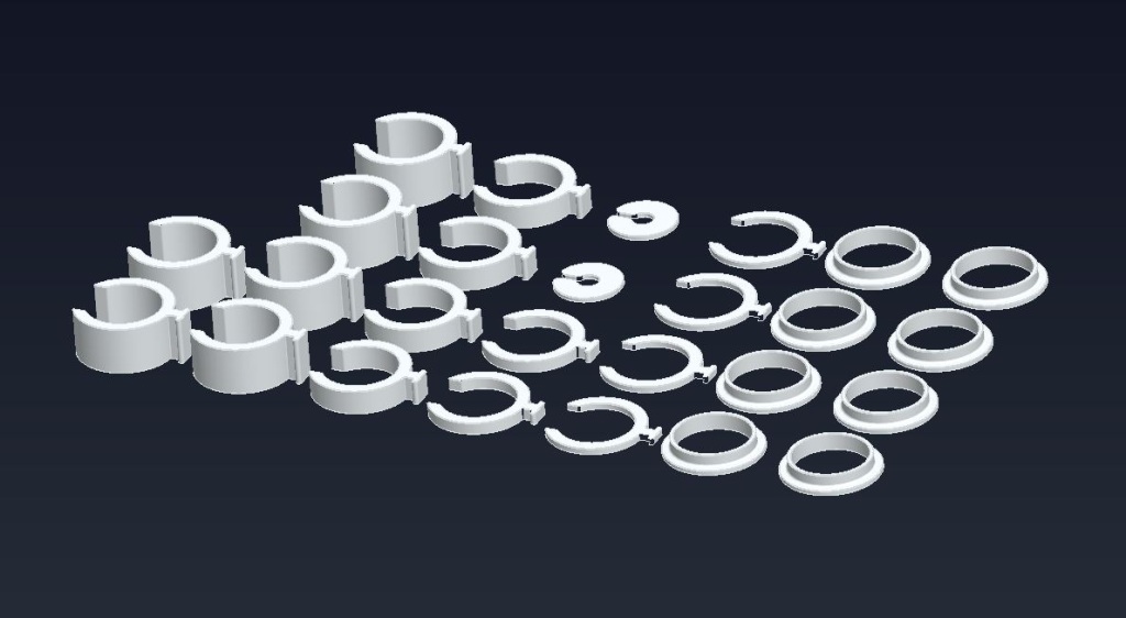

Shock prep set available now ! Clips are 7.8mm, 4.0mm, 2.0mm, 1.1mm. Thanks Peter.
Obviously I haven't tested these yet but I'm confident parts are OK.

Message from Shapeways considering current version of "Stealth Shock Prep Set SLS"
Reason: Model or Part Too Small
Description: This product has parts that are too small to be manufactured in this material. In order for us to print, clean, quality check, and ship your model, we must be able to handle all of the parts without losing them through various stages of manual and automatic processes. We therefore require that the smallest part of the product to have the sum of its dimensions be greater than 25mm. (X + Y + Z > 25mm).
All materials specified as dyed or polished are manually cleaned and then submerged in a circular vibratory tumbler full of thousands of ceramic pellets for several hours. Each pellet is approximately 4.5mm wide and 11mm long, and will exert a slight pressure on all sides of your model during polishing.
Any part that is smaller than the size of one pellet is typically lost or not polished consistently on all of its surfaces.

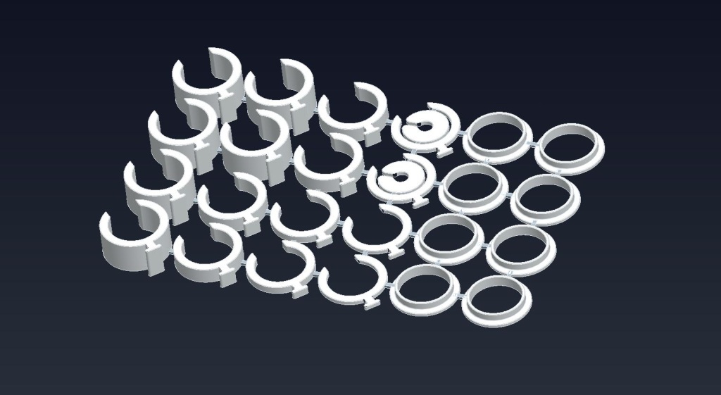

I will make a sprue for the parts... like it was injection molded. Just a moment...
-Niki-

OK. Now it's one single part. For those whos order was canceled, please you can now make a new order. Thanks.
