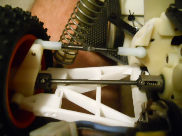

Re: NIX91 Questions and Answers
Stock dog bones do fit and should not be anywhere close to being too short. Post up some pics of your problem and lets see if we can get your problems sorted out. You are the first person I have heard of having issues with dog bones being too short.hugger19 wrote:well i was told that the stock rc10 dogbones would work but they are a little too short? any suggestions?
+1, I'm using them and they are perfect. What have you done outside the standard recipe? Are you using a spacer in the outdrive and a spring in the stub axle like you should be? Are you using the correct side inner mounts, with the pins inboard of the screws?

hugger19 wrote:here is the pic. used all stock rc10 parts hubs axle dogbone. am i missing something?
your a arm holders are the wrong way round, the pin goes in the inside
