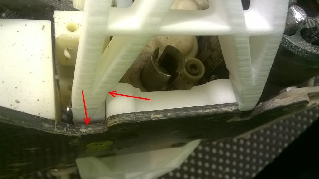

Make sure you fix the arm mounts as well. Those arm mounts have been designed to give 3 degree od anti squat and 3 degree of toe. If they are mounted wrong your car will not only drive terrible, it will look really goofy.hugger19 wrote:i have the springs on both axle and hub. ahhh i see well that would solve the issue. thanks!!!

With "Race" rear arms and mounts I had to use a little bit Dremel in these places to get full droop.
Nothing huge just a small tuning. It's 3deg/side toe-in and less than 3deg anti-squat that is causing it.
I didn't modify 3d-models/Shapeways parts. I do it if most of you think there is a real problem here.
-Niki-
-Niki-
