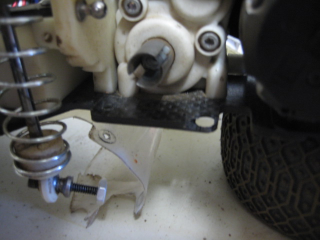

Re: NIX91 Runner - Mark Westerfield
Sadly, my rear suspension mount screw ripped through the chassis...
- Posts: 12336
- Has thanked: 1129 times
- Been thanked: 3919 times
Oh dang!
I wonder if a simple plate, g10 or aluminum, under the whole rear section there would get you going again. Basically the same way traxxas braces their tub chassis
Kicked up the rear end off a jump and cart wheeled several feet.
- Posts: 353
- Joined: Wed Apr 23, 2008 9:32 am
- Location: Connecticut, USA
- Has thanked: 14 times
- Been thanked: 39 times
I would recommend anybody with a runner to glue the chassis edges and counter sinks.
Will do!Mark Westerfield wrote:I would recommend anybody with a runner to glue the chassis edges and counter sinks.
