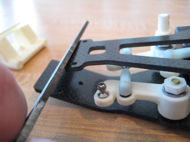

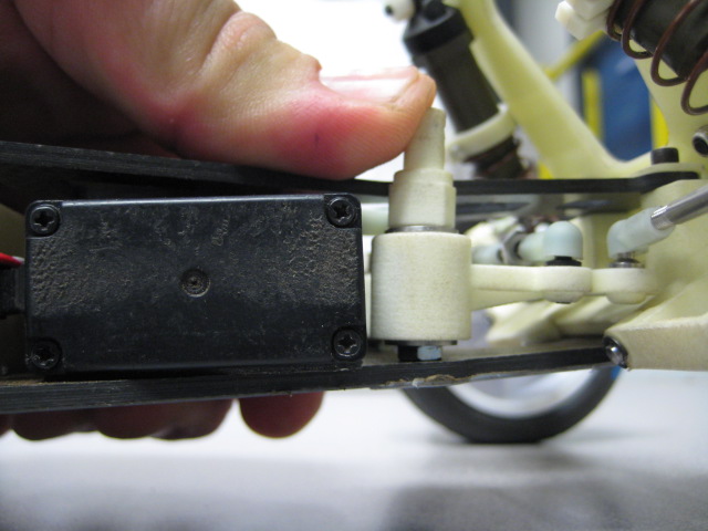

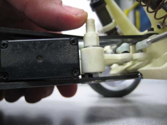

I've just finished putting my car together and noticed that with the race arms front arms and steering, there isn't any clearance for the steering cranks when the suspension is compressed. Should I shim the steering upwards and has anyone else thought that this is an issue?
Another problem was the steering part with the body post sheered off when I was screwing it on, with only really light force. I've replaced the part with another part from the Re-re worlds steering and now I'm going to do the same for the other side.
The Steering 3d printed parts seem a bit fragile to me. It would be great if someone out there could make some alloy steering parts.
Cheers
David

David this was actually an issue that was found on the original car. if you look at some of the pictures, you can see where the front arms were ground down in the same area you are having a problem with. The issue is that the front is really cramped for space. You will find that car has quite a bit of steering and depending on your track or driving style, you may need to take some of the steering out of the car.dj_kilroy wrote:Hey there,
Post up some pics once you get it going.
Jake
