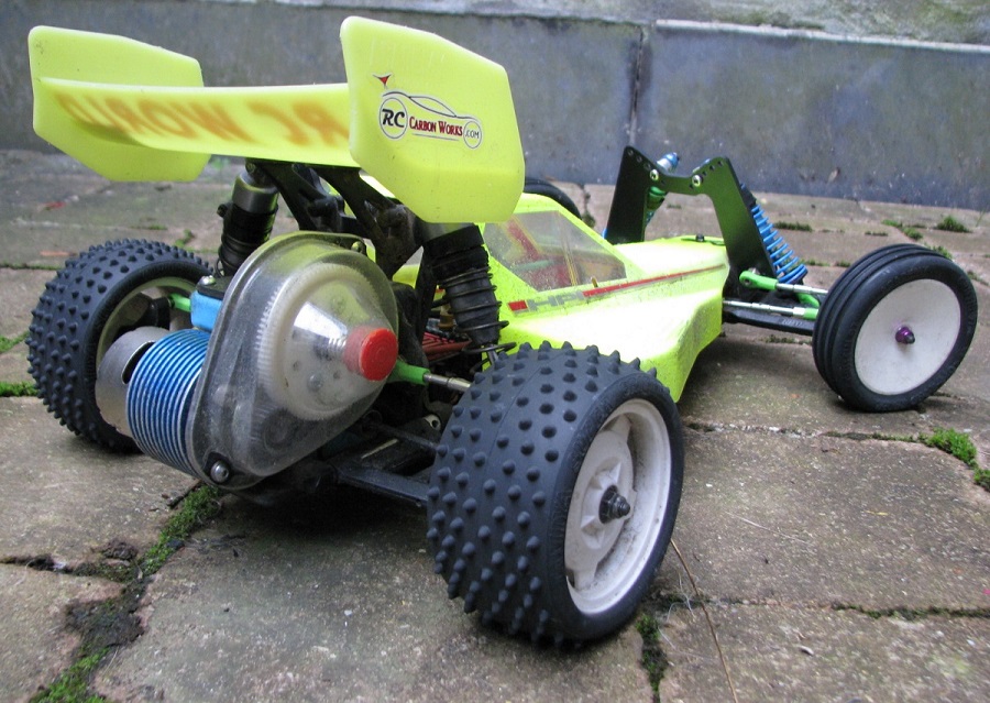

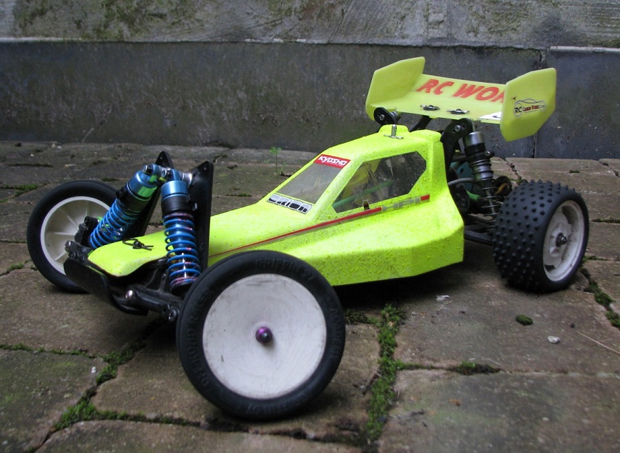

I'm just putting up a couple pics of the cars I ran during my radio-silence.
There were more, but these are the only ones which are still presentable.
And finally: my current runner.

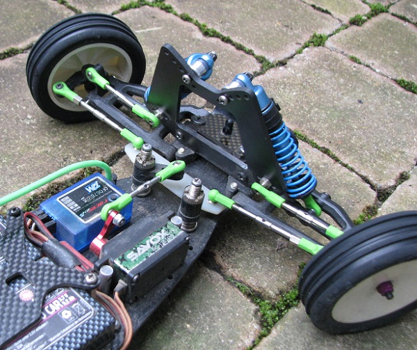

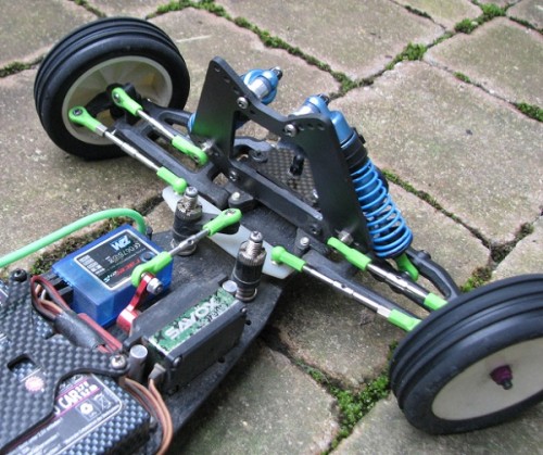

I took an easier road on this one and used the A&L transmission designed for this car.
Also went back to a double belcrank for the steering system: slightly modified version of the academy wyvern ones as I have a large stock of those.

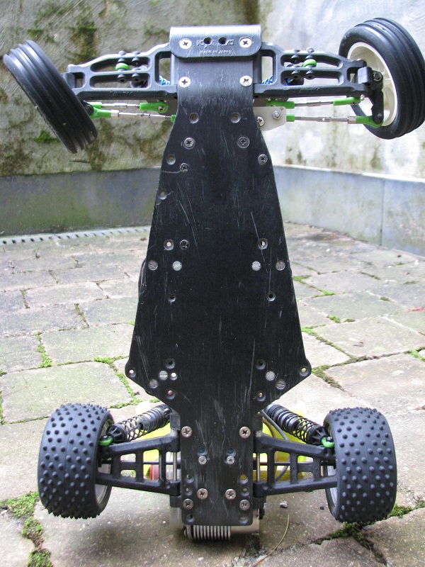

this way the servo sits further back= better centered. shock mounts are Losi parts, and shocks from 2 different Tamiya models link them to the arms: RPM for Losi in the front and ... RRP? for the optima in the rear. Academy universals for the extra width and standard ultima rear hubs.
The rear is legal, but the front needs some reworking: too wide
The front axles are standard and use 8mm bearings and older shumacher wheels

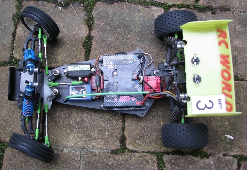

just noticed I forgot to add the top shot showing off the new layout:

Nice, I like that steering layout...looks like how I set mine up with the OptiMutt car, with the servo horn inboard instead of the usual, outboard orientation. Keeps things nice and tight on the inside.
