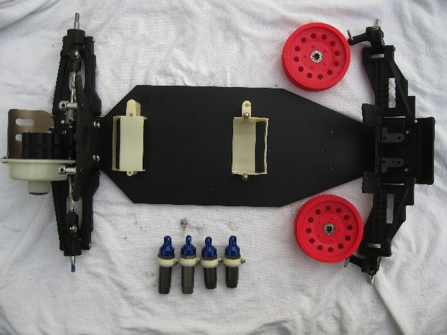

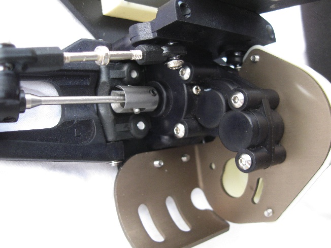

Howdy,
So I am having a revision here and am rebuilding this TRX-1. So far I've got the transmission rebuilt and I pressed on a steel top gear. It was a little notchy so I beveled the idler gear slightly and ran the trans in with a drill. It spins super-free now. I will put a HobbyWing 17.5 combo in this. I also have some parts to dye black. I have some lighter colored shock bodies and the lighter blue caps for it also.
Mark

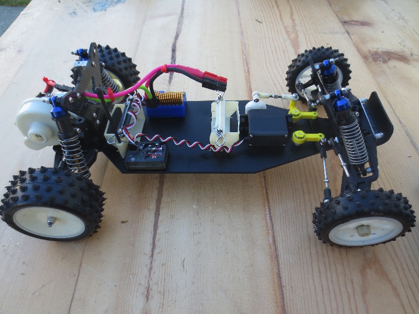

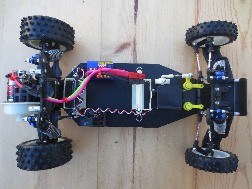

Just an update with my TRX-1 "ish" runner. Just got it finished up with the electronics. Need to put some shorter shocks on the front. Was thinking about double deckering this thing somehow. We'll see.
Mark

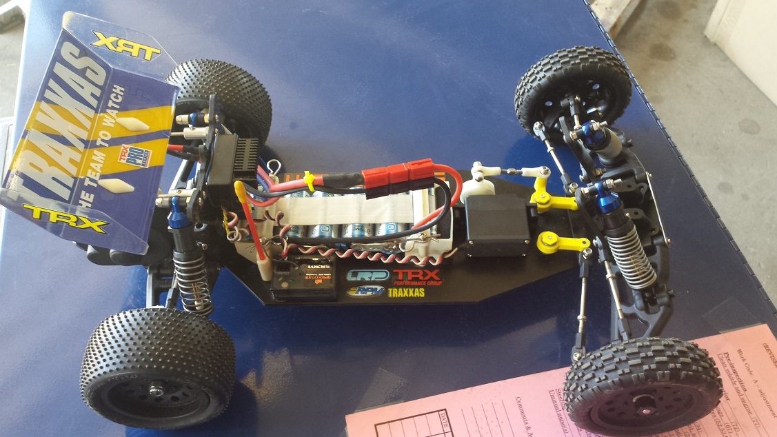

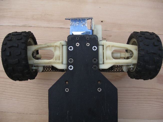

Well so here is an update:
Slammed an LRP Indy 600 in it and I have converted the front end to SuperWideTrack. We got RPM Nitro Rustler Front Arms with TCP caster blocks, SRT knuckles / steel axles. RPM rear arms, Raborn (10T) slipper, Thorp gearset, MIP CVD, Tamiya Dirt Tuned, with a crummy pack I soldered up.
Mark

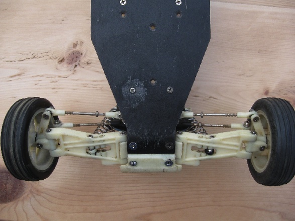

Just messing around. I want to set this thing up for carpet "off road". I was putting together my version of the TCP wide front configuration (the arms are impossible to find).
So the TRX-1 front can run short TRX-3 arms, regular long 1931s, and xlong RPM nitro rustler arms.
Mark
