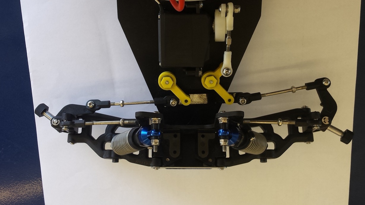

Slammed an LRP Indy 600 in it and I have converted the front end to SuperWideTrack. We got RPM Nitro Rustler Front Arms with TCP caster blocks, SRT knuckles / steel axles. RPM rear arms, Raborn (10T) slipper, Thorp gearset, MIP CVD, Tamiya Dirt Tuned, with a crummy pack I soldered up.
Mark

Just messing around. I want to set this thing up for carpet "off road". I was putting together my version of the TCP wide front configuration (the arms are impossible to find).
So the TRX-1 front can run short TRX-3 arms, regular long 1931s, and xlong RPM nitro rustler arms.
Mark
