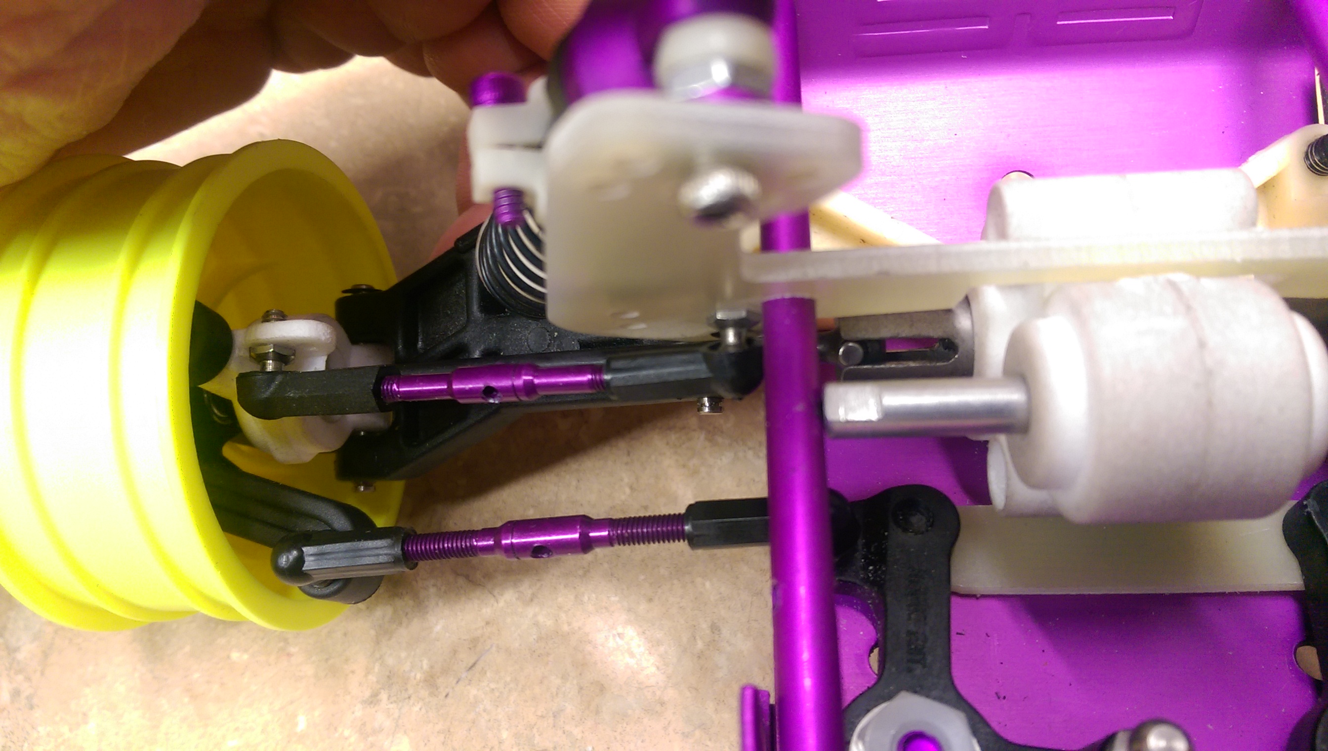

how about mounting the turn-buckle on the front, but then there's no room for the shock
unless the shock tower was wideee...... :(

I tried that already and Jeff quickly reminded me about the shocks :P :lol:

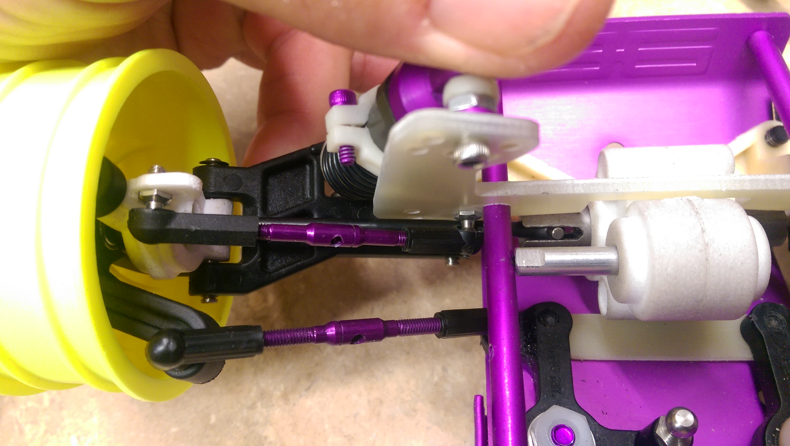

Caster blocks with offset ball stud mounting. This should solve the steering interference

That would be the left side, right ?

SnoopMaxx wrote:That would be the left side, right ?
Yup! 8)

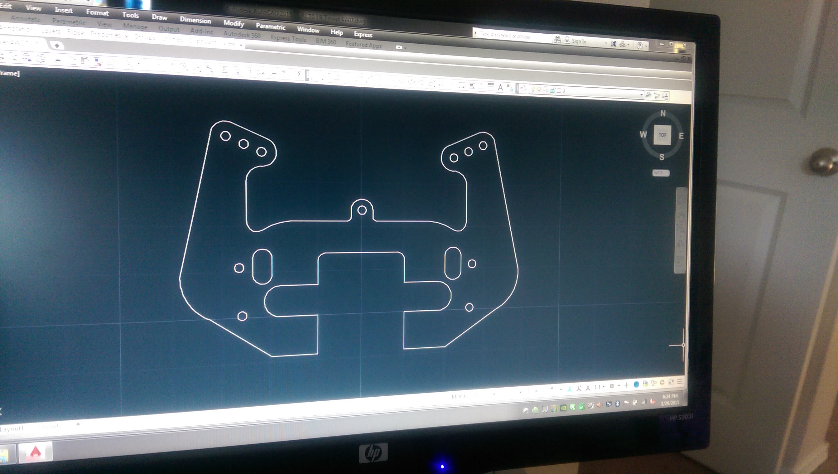

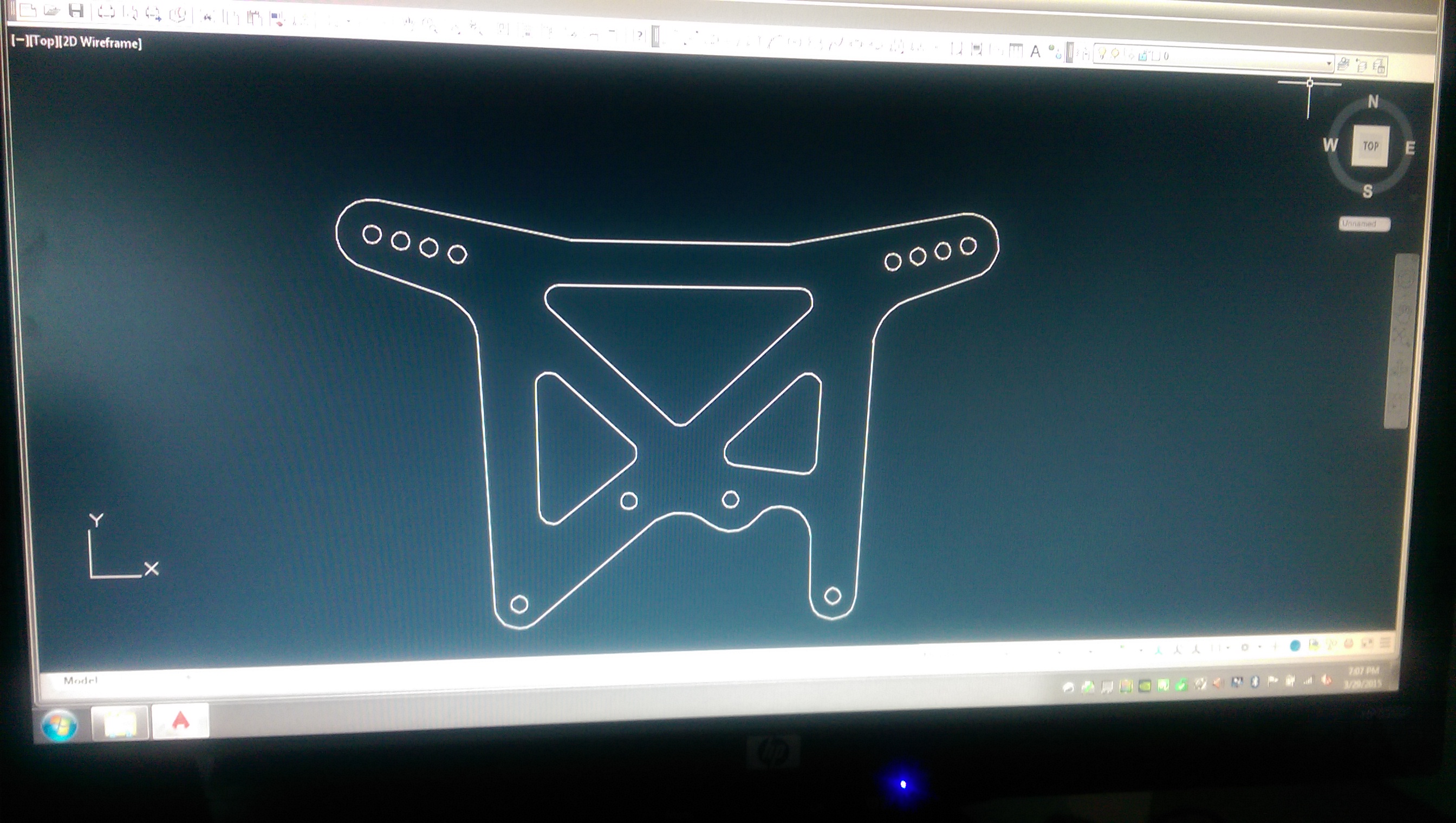

And just to show I have been working on it too.... :mrgreen:
Not finalized... But fitting just fine 8)
Note the body can use worlds hole or front hole (both shown in use) without making new holes. If you want to run the world's post just cut or break off the nub on the tower. The tower hides under the stock body so with the body on it appears stock
