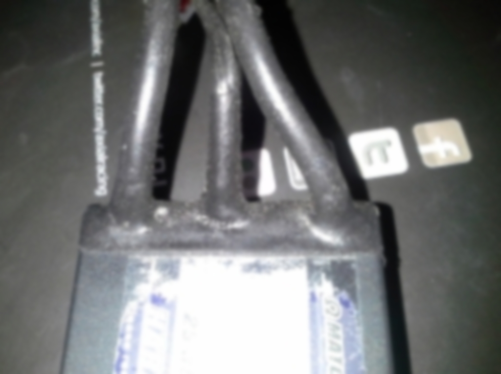

I could google it, but I would rather discuss it here. I went out and bought a fresh can of Plasti Dip and did some ends of a few of my batts.
I have my first SCX10 Rubicon built and running, waterproofed everything and I have done this with a few lipo's before with no issue.

Re: The Plasti Dip for the battery ends, I was thinking of doing the exact same thing! How did that turn out?

Re: Charging LiPo's for storage
It always turns out well, I have even done the seams on hard case packs.
