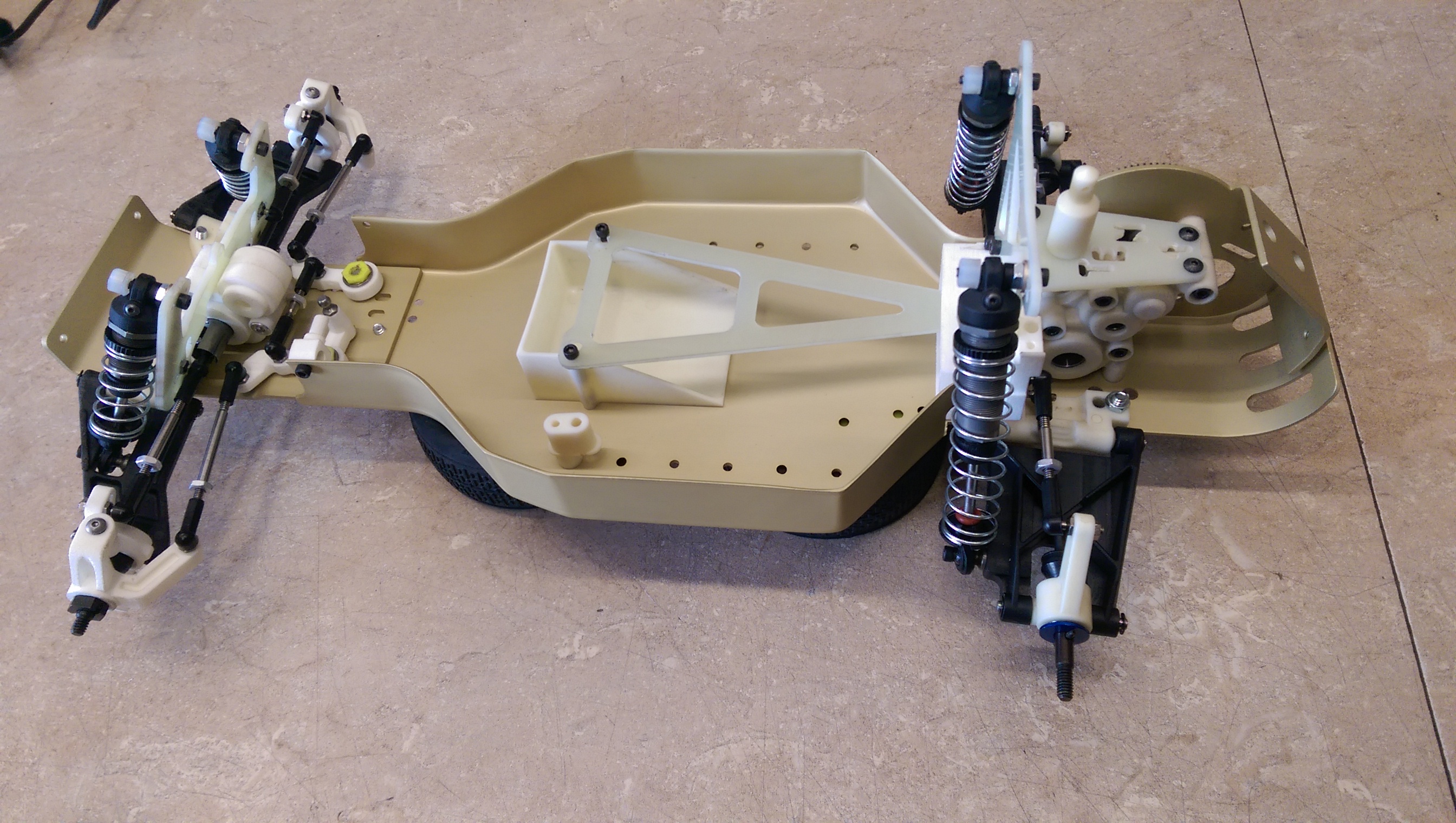

Re: Ten4: the 4WD RC10 project

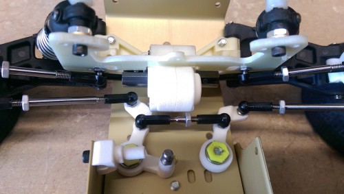

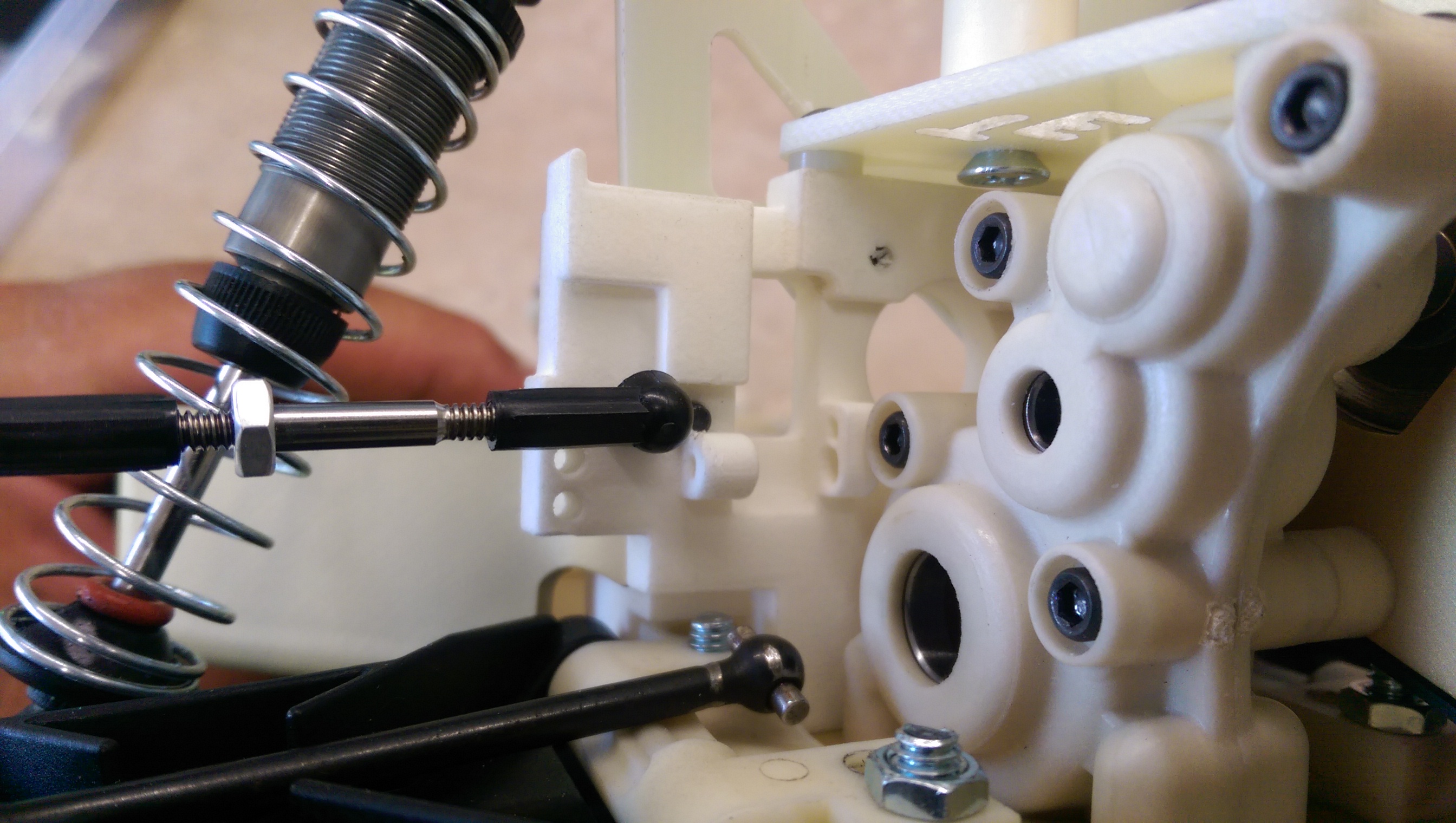

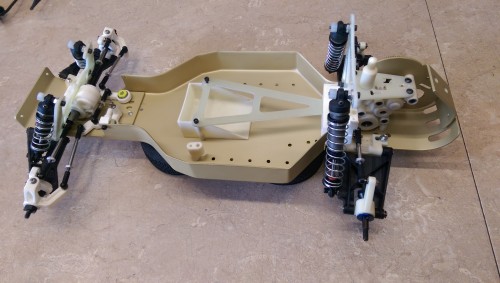

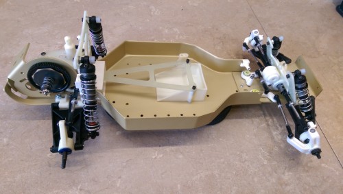

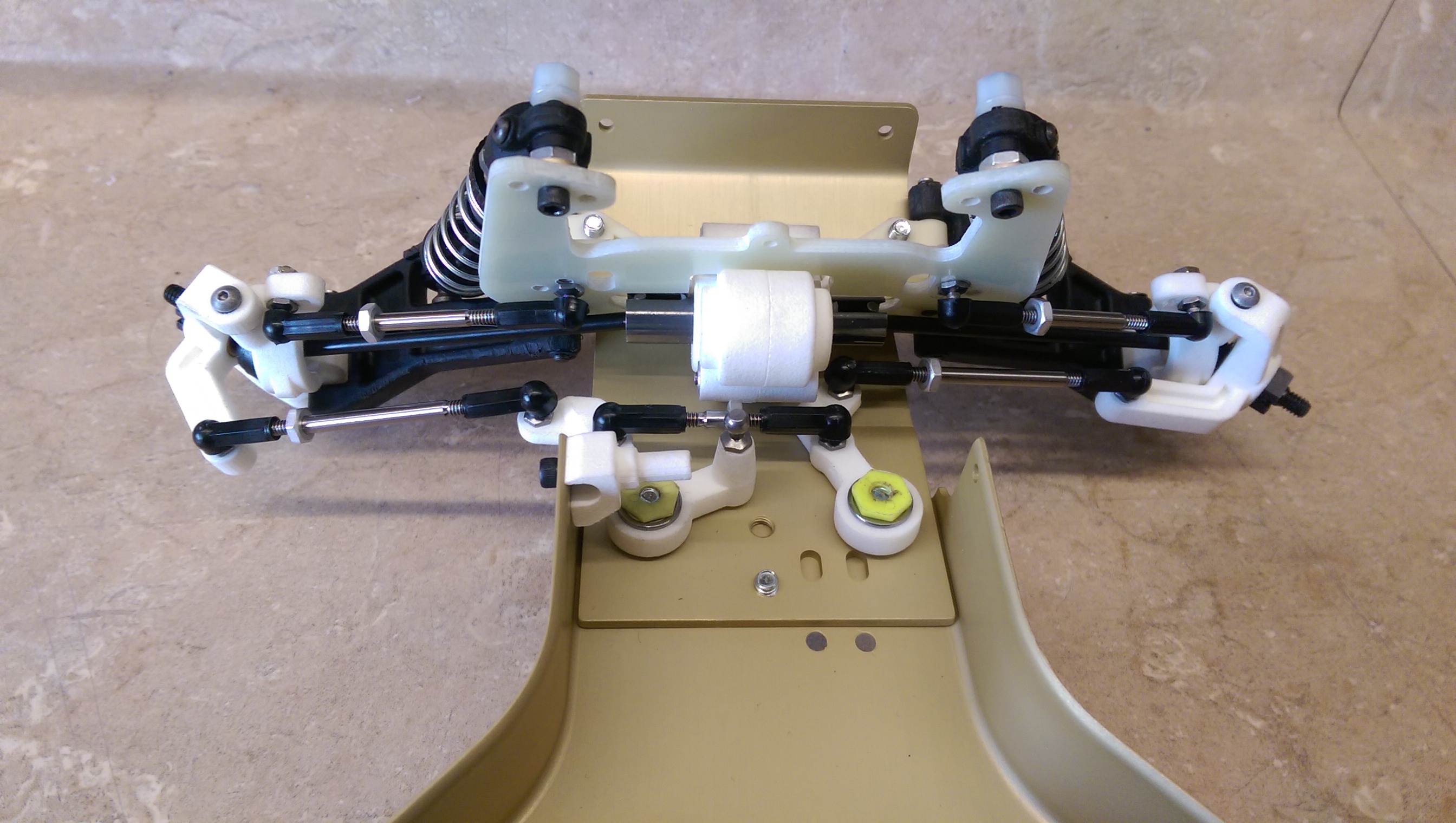

Only a couple minor tweaks needed. Even the front drive shaft plunge is perfect on both compression and droop. I'm stoked!
Need to disassemble and dye it all black, but that's the last step
Looks great guys! You both have done a great job on making this project come to light. Thanks in advance from all of us that always wanted one of these kits and for some reason was not able to get them in the past.
Mmmmh purdy! I actually like the black and white look of it, makes it more genuine and in line with the era it mimics. Can't wait to see the RR parts.

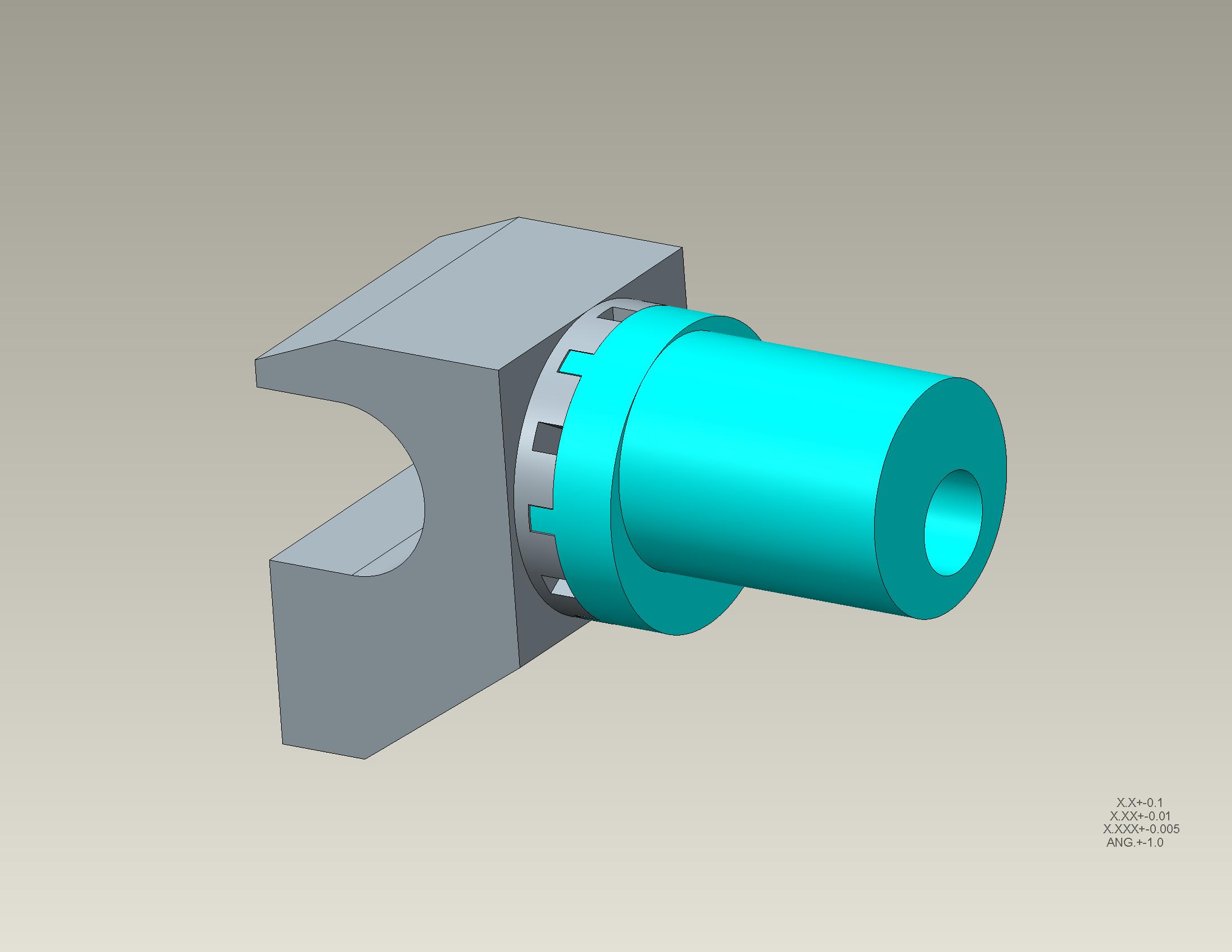

Just a small update. Based on Jeff's feedback, I made some final tweaks/improvements on several of the parts. I also designed an adjustable front tensioner. I couldn't bring myself to ask you guys to adjust the belt by shimming the nose tubes like in an MIP kit
The tensioner has .080" of adjustment in it and locks into position.
I'm going to order these updated parts from shapeways and once I test fit them all I will release them for sale. Won't be long now!
