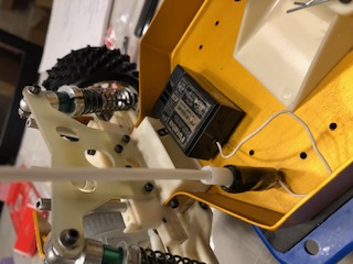

My original thought was the mount would have a wide base for stability. However in this RC10 photo (no heat shrink), the diameter appears to stay the same.
Since the length protrudes from the body, it would get additional support from the hole, not needing a wide base.
I am going to try and find the right size tubing and see if it works. I will post if successful.

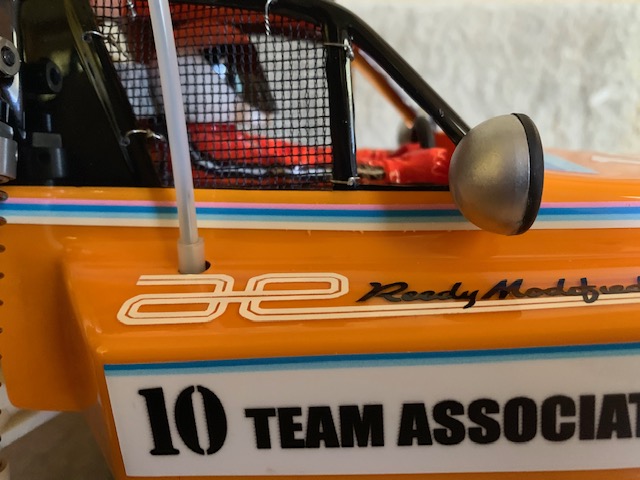

As promised, see pictures of rough prototype box art antenna mount. Next I will work on height and correct yellow shrink wrap. The nylon tube wall thickness should be thinner, so I will do some research on standard sizes. Wrapping the excess wire is tricky. I will need to experiment further on this.

I didn’t have much success making the antenna base out of nylon tubing. I couldn’t find tubing with the right OD/ID to match the Box Art proportions. I ended up machining the base out of nylon rod, incorporating upper and lower raised ridges (similar to a thread spool) to wind the excess antenna wire. I am pretty pleased with the final result.
It’s tough to add to the great work displayed on this site. I hope this posting is helpful. If you’d like dimensions, drop me a note.

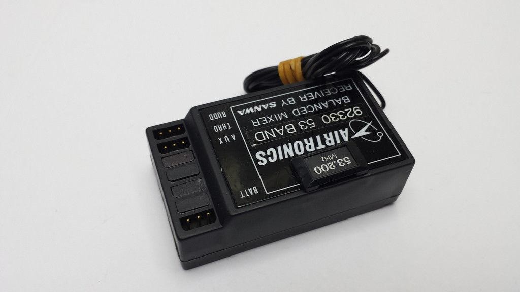

This is the receiver I settled on. It shows the Band 53 on the label, has a black crystal cap and Black antenna wire.Asso_man! wrote: ↑Fri May 06, 2011 4:22 am I am a bit stuck on the build as I am too lazy to take out the dremel and modify the front kick-up plate (sanding the AE logo, rounding the corners and mill the two front tube screw holes). In the mean time, I found a brand new Sanwa/Airtronics RX that looks a bit closer to the box art one as this one says "balanced mixer receiver" where the previous one only said "2 channel receiver". The frequency, ref.# and color of the antenna wire are still wrong though, but that will do for now, I'm quite happy with it![]()
