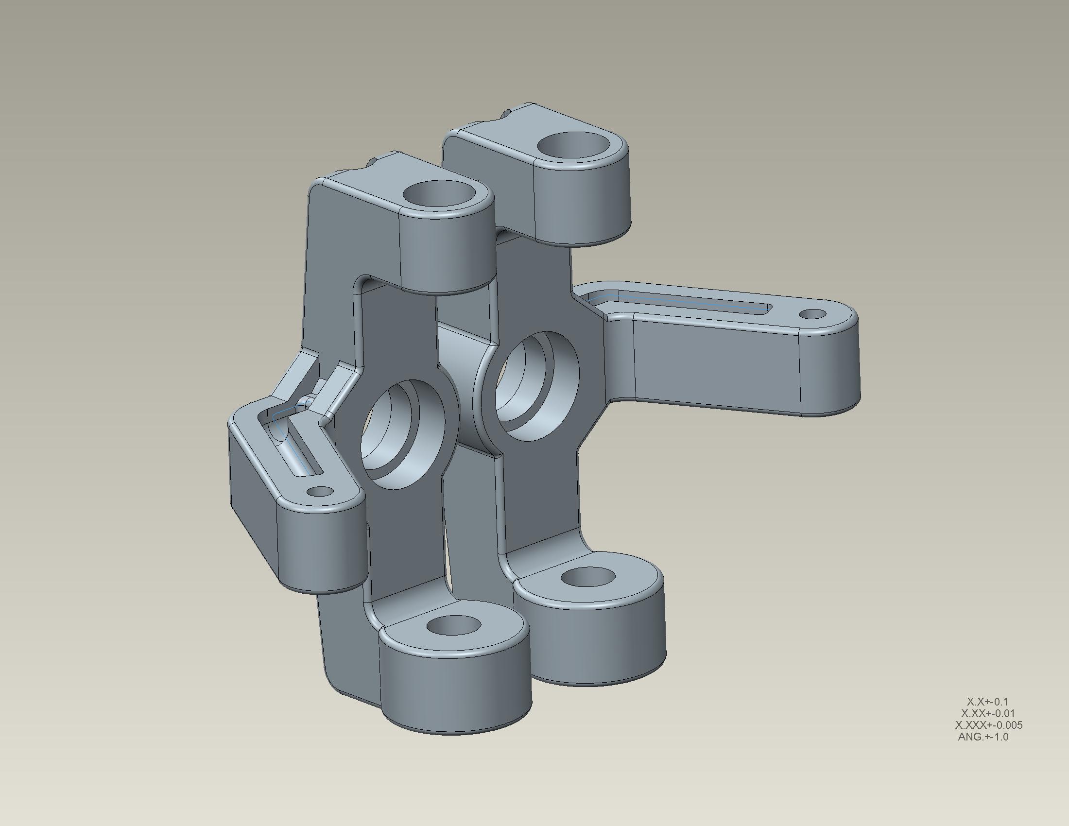

Well guys, sorry to say there is going to be a bit of a delay in the release of the Ten4 kit. The first big double I took it off I landed pretty hard and broke both front caster and steering blocks :shock: I think the steering blocks are what broke first and they took the caster blocks with them. The good news though is that there is plenty of room to beef them up where they broke. I'm going to update the CAD models this morning and order parts today. Then hopefully in a couple weeks I'll have her back on the track.
This is why I wanted to abuse the car on the track before releasing it. Those parts never would have broke in a million years just blasting up and down the street.
What I can say though is that the car seemed to handle nicely and it jumped really well.
Sorry to disappoint you guys with the delay, I know a lot of you are eagerly waiting to build your own. But I want to make sure the kit can take the rigors of racing before releasing it into the wild.

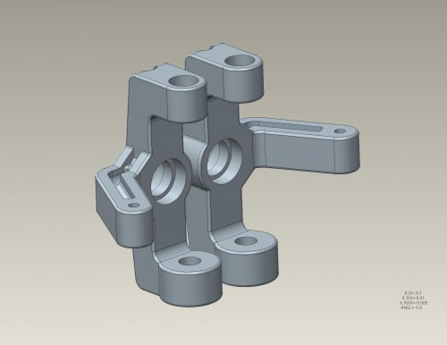

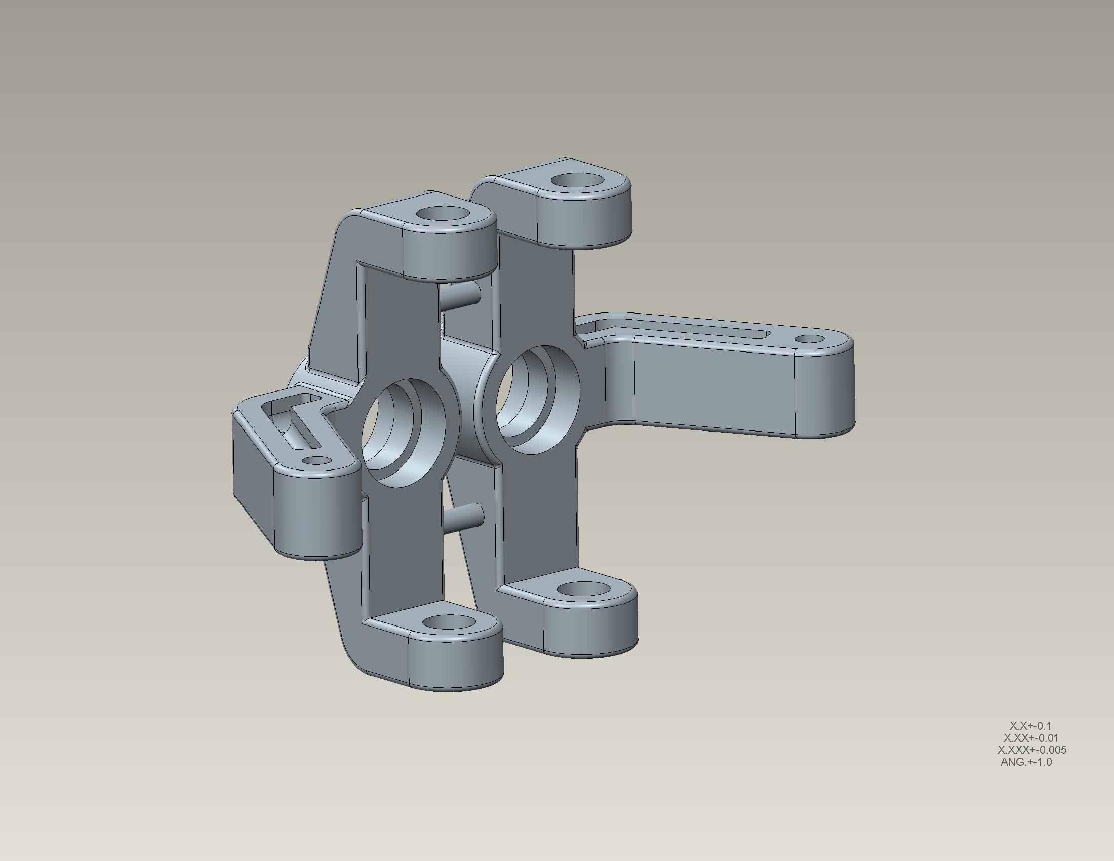

Waaaay beefed up:
Old:
New
The old ones broke on that bottom tab where it attaches to the caster block. The new ones are 50% thicker there and the bottom one, which carries most of the load, is 40% bigger around. We'll see if I can break these! :twisted:
I also beefed up the caster blocks, but I think the only reason they broke was because the steering blocks did first. Doesn't hurt to make them stronger too, just to be safe.
I should have the new parts in about 2 weeks.
I may 3d Print my own in the mean time, but they will be ABS so I don't want to put too much stock into how they perform.
