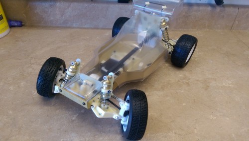

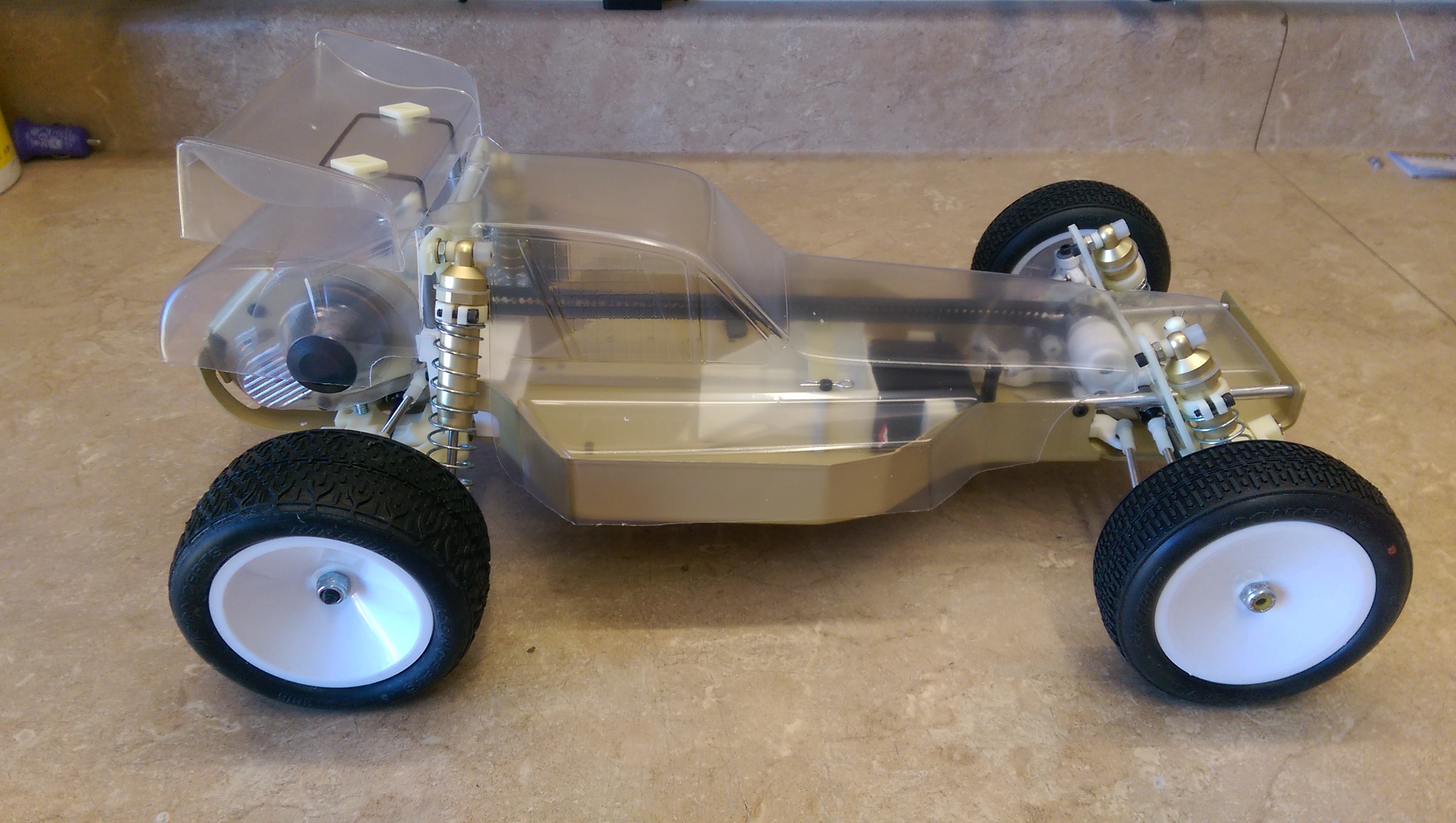

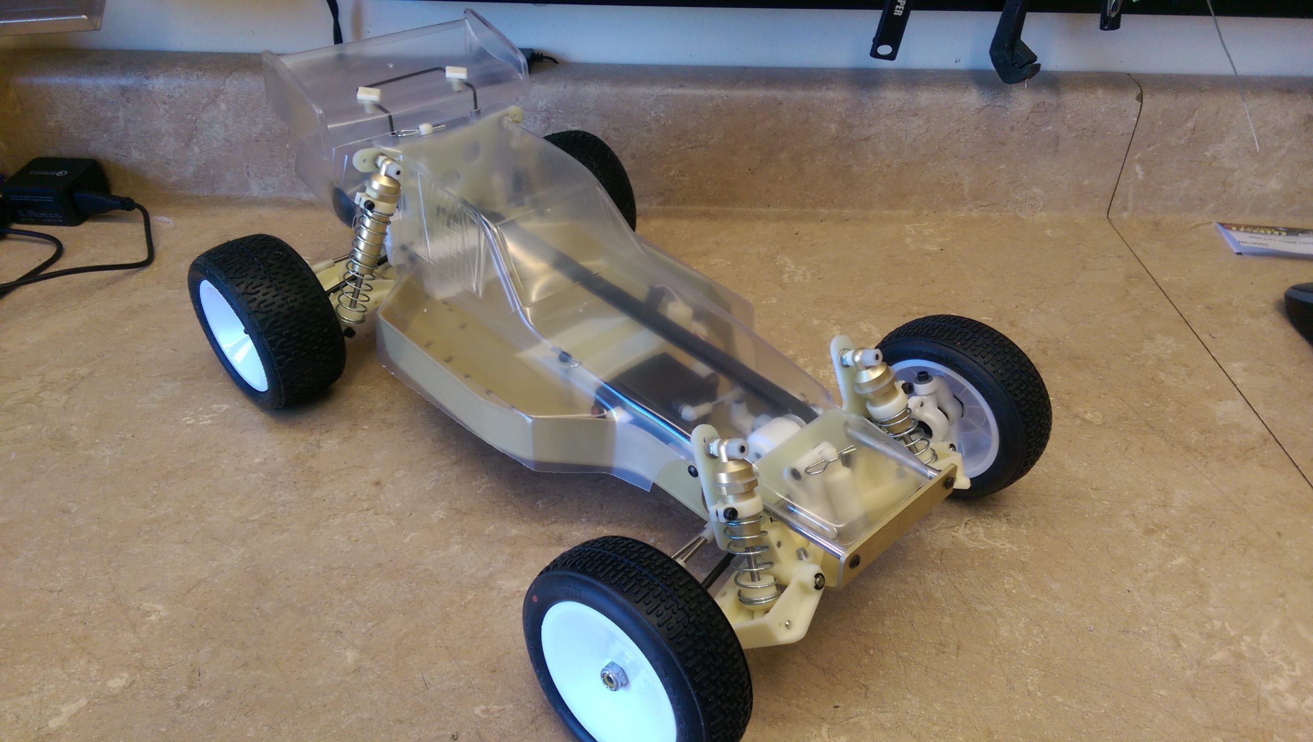

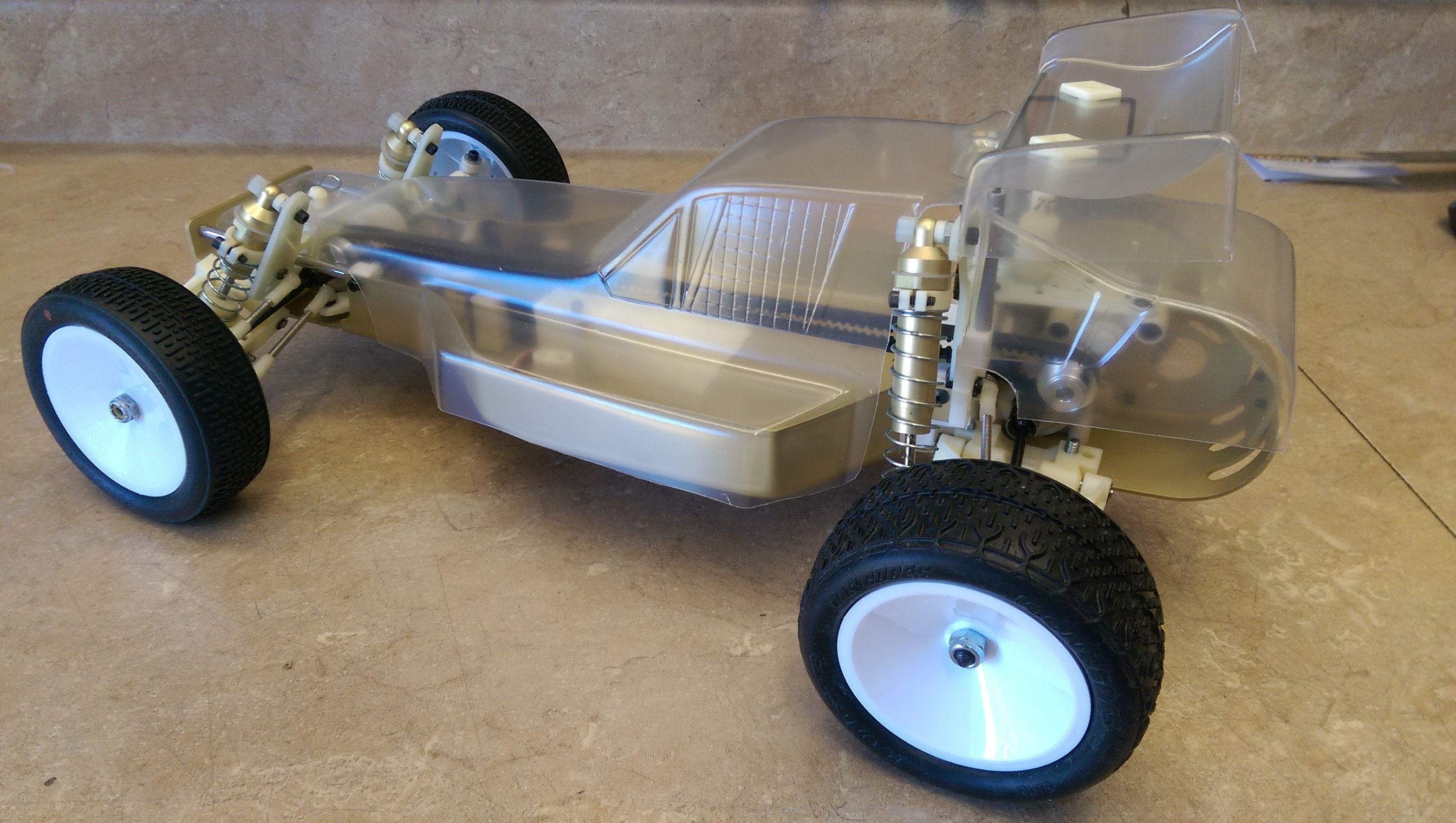

More short wheelbase short arm pics :mrgreen:
alien3t
Posts: 588
Joined: Wed Oct 03, 2012 2:17 am
Location: Murrieta, California
Re: Ten4: the 4WD RC10 project
Post by alien3t »
Now that makes for a killer sleeper.
limestang
Posts: 990
Location: Fort Worth, TX
Has thanked: 100 times
Been thanked: 249 times
Post by limestang »
Love the shade of gold!
Posts: 12336
Been thanked: 3919 times
The anodizer calls it Champagne 8)
