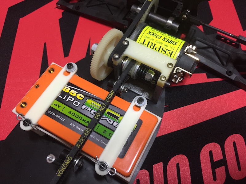

870C is almost done without a few parts like the white bulkhead caps and wheel hubs. this build is from the parts.
59burst

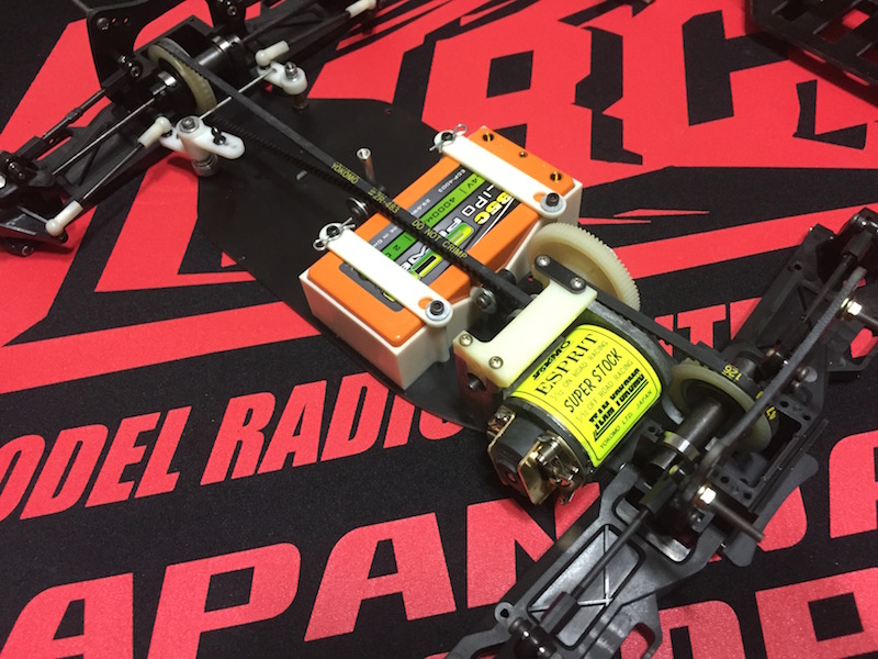

Hotdog4 from YR4 and works bits.
put RC10 battery cups and it looks great to me

59burst wrote:put RC10 battery cups and it looks great to me
Me too 8)

Post by 59burst »
forgot to tell about the clearance between the belt and the shorty battery.
I put 1mm spacers under the tensioners and it still has only 1mm clearance between them. I'm thinking replacing the battery straps to epoxy or graphite. epoxy would be nice with the white battery cups

Post by Mr. ED »
Mount the holders upside down and make holes in the bottom for the plugs. Then your cell will drop another mm and you don't need straps at all.

Post by 59burst »
Mr. ED wrote:Mount the holders upside down and make holes in the bottom for the plugs. Then your cell will drop another mm and you don't need straps at all.
it might work. but I'd take a cool looking. thanks for the idea though

Post by klavy69 »
cut the bottoms outta the holders and it'll drop you another 1mm. 2mm is still a lil too close for my tastes though but it does look good so far.

Post by 59burst »
klavy69 wrote:cut the bottoms outta the holders and it'll drop you another 1mm. 2mm is still a lil too close for my tastes though but it does look good so far.
though about it too. but I'm not sure if it's strong enough for running. or I can simply buy a thin shorty battery :lol:

Post by Mr. ED »
On my yr4 I put the shorty in the length: so the belt doesn't run over it. I'll try to make a picture later today.
