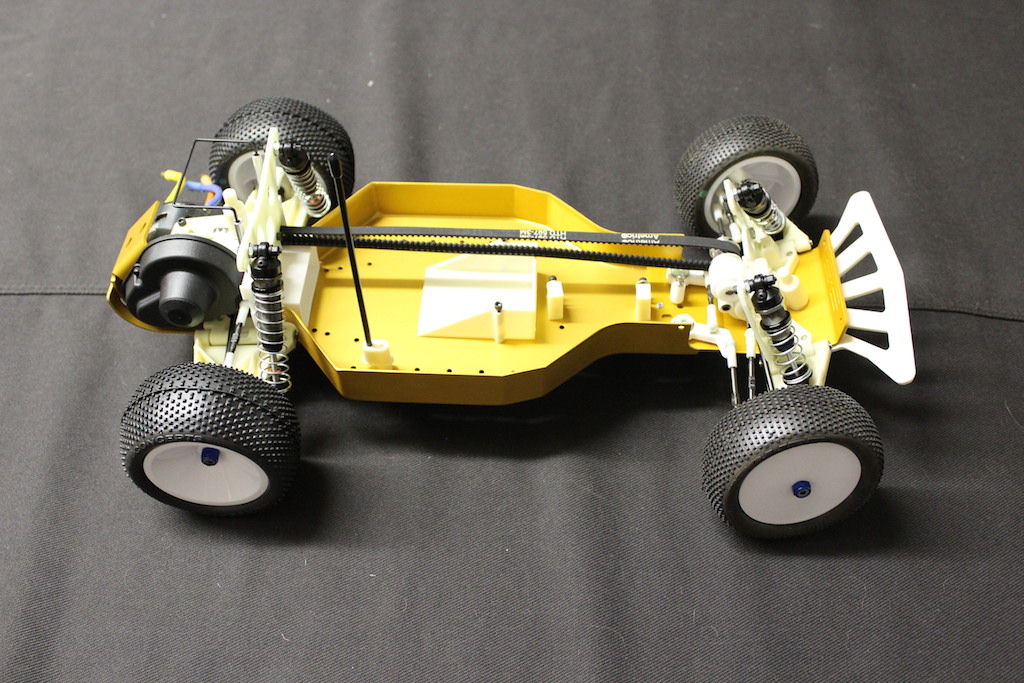

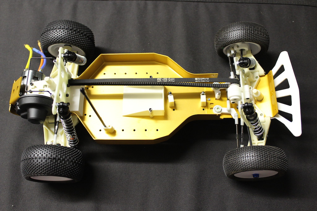

So just a few more minor adjustments and I should be ready to hit the local track. You weren't kidding about the front end fitting together like a puzzle. I'm sure I'll have more questions/comments as things progrees. Here's a picture of what I have so far.
Thanks again for your efforts.

If you think it fits together like a puzzle, imagine the look on my face trying to make it fit! I'm shocked it all fits where we wanted it to, the mip setup was half the size and took up similar space

Fits like a glove. A very tight glove. A very tight glove that requires you to put your fingers in in a very particular order, lol.
Going back to the first mockup I did with a cardboard "shock tower" and the 1st version of the front trans case I knew it could be done though. Hard to say how many hours of design, prototyping, test fitting, redesign, etc etc we have in it between Jeff and I, but I hope you all like the result

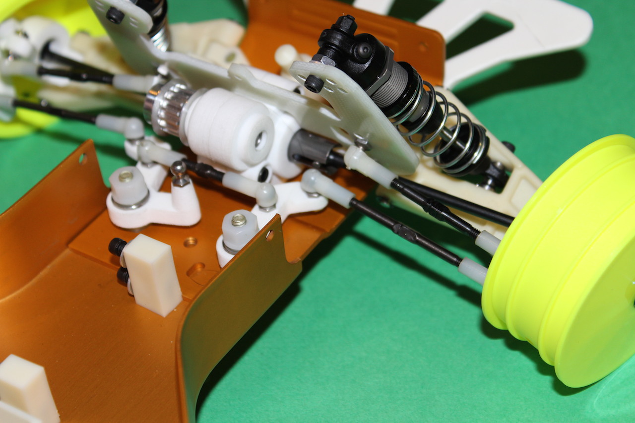

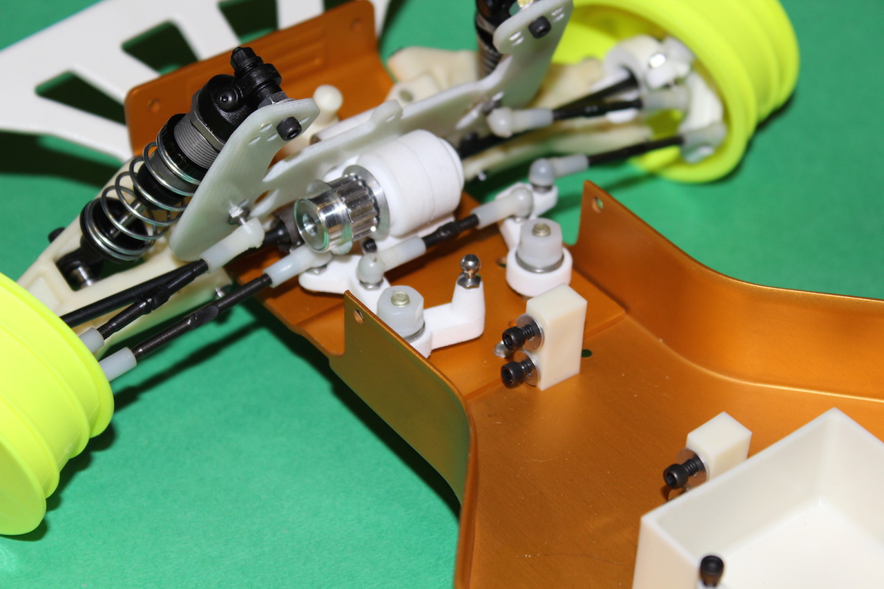

I made some good progress assembling the Ten4 Project. My compliments to Brian and Jeff on all of the great work and long hours making this possible.
I am on the waiting list for the nose tubes and hardware from Brian. I don't seem to be getting a great deal of turning radius.
1) Carrier hits arm, if suspension arms angled down.
2) Bell crank hits trans housing.
I probably assembled wrong, or ordered incorrect bell crank for this configuration. I ran out of time this weekend to debug. Let me know if you see something obvious.
Fixes worked - Thanks Jeff & Brian! Next Steps: Belt Tensioner, Nose Tubes, Body & wing.
Thanks, Mark

Install it worlds style, no nut below the steering arms. The nut goes to the top and no need for the additional nuts
