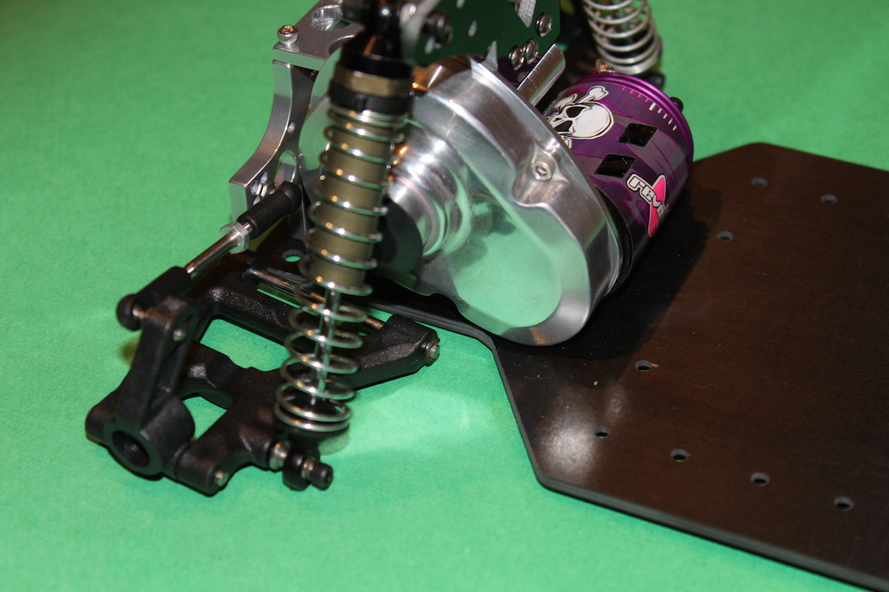

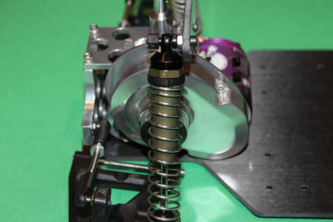

What gear cover you using? Can you take a closer photo of the clearance? I am using the Worlds ReRe shocks with big bore springs and I can't find a gear cover to fit.

Re: Limestangs Advanced Racing Build
Gear covers don't really work too well on these. I had mine built with bottom load shocks and still had contact with a stock Caddy gear cover. It was minor contact and the springs only touched the cover at full droop, but with big bore springs or a gear cover for a modern slipper I got to think it'll be too much interference.pumpkinfish wrote:What gear cover you using? Can you take a closer photo of the clearance? I am using the Worlds ReRe shocks with big bore springs and I can't find a gear cover to fit.
The gear cover was designed for a Traxxas Stampede/Rustler. It attaches by just the upper screw.
http://www.ebay.com/itm/ALUMINUM-GEAR-BOX-COVER-S-TRAXXAS-2WD-RUSTLER-STAMPEDE-BANDIT-SLASH-VXL-ALLOY-/380697636837?hash=item58a358efe5:g:HgcAAOxyBLBSCh88[url][/url]
They are common on eBay and look cool. I will add a close up photo shortly.

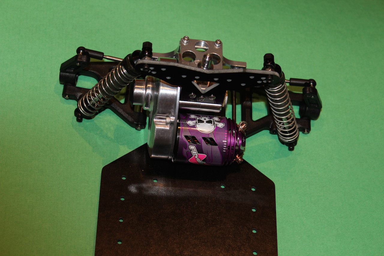

Made a few of the planned installations/upgrades; Silver shocks, Litesink motor mount, Plastic battery straps (for now) and custom Bellcrank thumbscrews/nuts. Not sure whether or not to keep the litesink blue. Black and Silver would bet a better match, but I would need an anodize source:)
Mark
