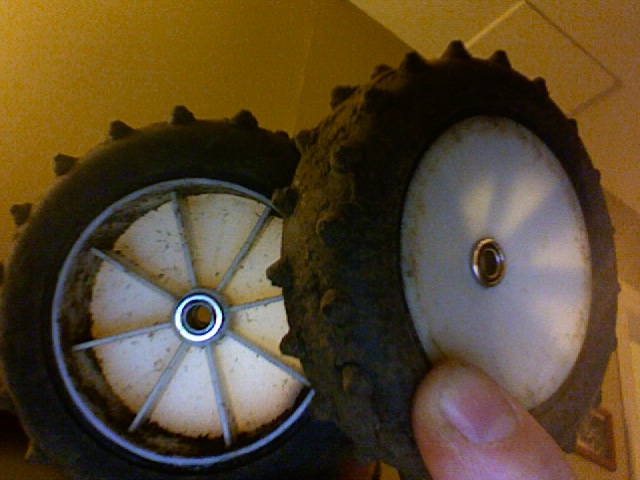

My brother and I pulled our Gold Pans out of moth balls after 22+ years of hibernation. My particular car is a Rc10CE with black parts and a stealth tranny. I have the 3 piece wheels from that vintage and I need new tires. The front wheels look to be about 2.5" in diameter and the rear looks more like 2.1" as in the pic below.
I am having trouble finding tires to fit both. Everything now looks to be 2.2" for the 1/10 scale buggies. I'd like to stay with the stock wheels. I tried to fit a set of Proline Dirt Hawg tires on the rear wheels, but they are just a bit too big for the wheels. Can anyone help take the confusion out of tires shopping for me? Or am I in a situation where I need to convert everything over to 2.2" wheels and glued on tires?

those wheels will have smaller tires, I believe 2.0" rears and 2.1" fronts.
ebay will have new old stock in the right sizes, there are also a few other places that still sell 2.0 sizes for rear. schumacher tires I believe.
it's really easy to pick up the new worlds wheels in 2.2" front and rear, or jcracing in the UK that are direct fit as well.

I would get new 2.2 wheels, as they are stupid cheap. Just make sure you get the right ones, for bearings in front, and you may have to order the "Worlds" ones online, they are the deep dish style. Then you can use anything new on the market.
On the Schumacher note, they make some of the best vintage style tires around. I recently got a few sets for my vintage cars.

Thank you both for the info. Schumacher looks to be UK, so not really worth the extra cost IMO. I guess the best play is to bite the bullet and upgrade the wheels. Then I can have a much better variety of tires available at a decent cost.

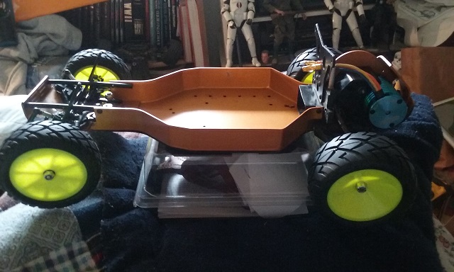

I went with these for my RC-10 Classic, know you didn't want to go to 2.2.....but hey its an option...
front
http://www3.towerhobbies.com/cgi-bin/wti0001p?&I=LXEAK7&P=7
rear
http://www3.towerhobbies.com/cgi-bin/wti0001p?&I=LXDWJK&P=7
have to do a little bit of grinding for the rears to fit, the cotter key that holds the rear hubs on older RC-10's are a little bigger than the RC-10B4's
like I said, just another option
HERE IS WHAT MY RC-10 CLASSIC LOOKS WITH THEM ON.....

Clhuke64. Those wheels are the direction I want to go. Got some on the way! What tires are those? Those look really nice.

They are Traxxas, for the Bandit.....I picked them up because Ean (the kid I'm making the RC-10 for) will be driving mostly on pavement.....couldn't see putting on a dirt tire to be worn off that much quicker.
fronts
http://www3.towerhobbies.com/cgi-bin/wti0001p?&I=LXRLP0&P=7
rears
http://www3.towerhobbies.com/cgi-bin/wti0001p?&I=LXRLN9&P=7

clhuke64 wrote:I went with these for my RC-10 Classic, know you didn't want to go to 2.2.....but hey its an option...
front
rear
In the attached photo from this post, what tires are those? I've been using street-dirt tires and my kid's been eating them alive. I'm going to have to go to the 2.2's myself and those looked grippy for asphalt and possibly tough enough to handle rough concrete?

Those are Traxxas Anaconda street tires.
