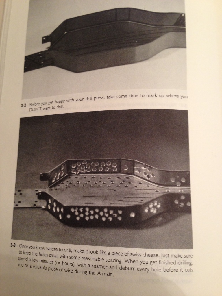

Post by Jirka »
I have one "Trick Tip" ;)
Jirka
LosiXXkid
Posts: 757
Re: Easy Hinge Pin Restoration Method
Post by LosiXXkid »
Jirka wrote:I have one "Trick Tip" ;)
Jirka
That's so it can double as a colander!
Jirka
Lol, I can't believe people ever did that. I'm sad to think of all the destroyed vintage chassis out there.
Jirka
LOL, I could definitely use that to drain cooked pasta.

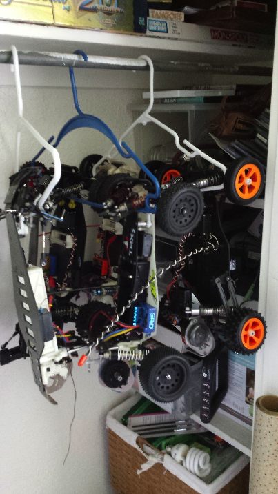

Post by TRX-1-3 »
Trick Tip: 2 buggies per hanger. No flat spots on the tires.
Actually it's another Pit Tip from RCCA bitd
