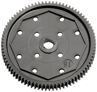

I ordered the slipper setup from tower. Here is their breakdown.
LXEAC1 Associated Top Shaft RC10B4 1 $7.79
LXZWK1 Associated Factory Team V2 Slipper Hubs 1 $9.99
LXZWK2 Associated Factory Team V2 Slipper Spring & Washer 1 $1.79
LXEAC7 Associated Slipper Pad RC10B4 (2) 1 $6.59
LXEAK2 Associated Kimbrough Spur Gear 81T 1 $4.69
