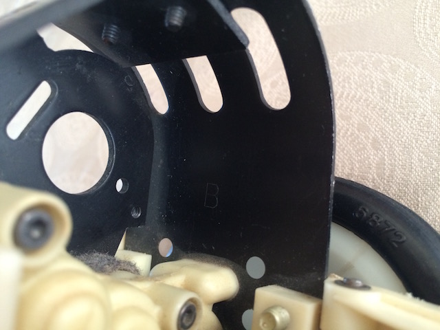

B stamped chassis
B stamped chassis
Plenty to asphalt/concrete rubbing
