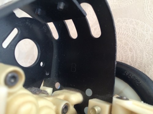

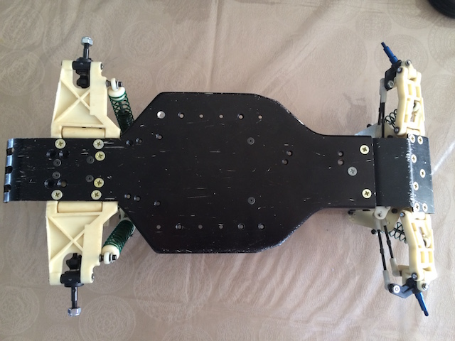

B stamped chassis
B stamped chassis
Plenty to asphalt/concrete rubbing

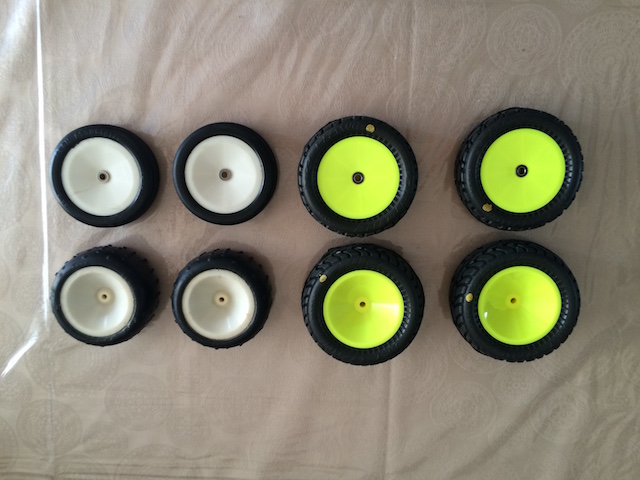

The car had little traction since my rear tires were pretty bald (like my head). So after doing a bit of research it looked like a good upgrade path was to get the RC10 conversion kits so I could use 2.2" wheels.
Old vs new wheel and rubber
So I order and installed the following parts:

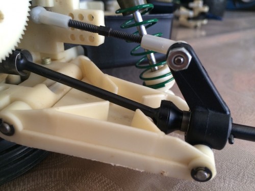

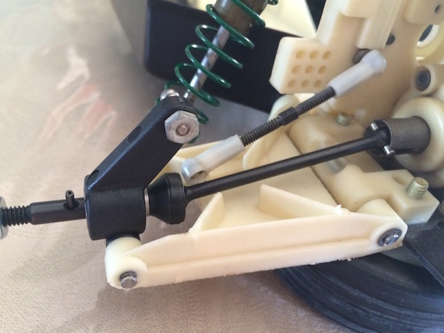

After installing the CVA, as others have already indicated, the Team Car's universal joint axles seem to be longer than the CVA axles. Requiring a lot of shims to make sure that the dog-bone end fits deep enough in the out-drive. Is that because the rear A-arm on the Team Car is different than older or newer versions of the RC10? I would prefer to use the recommended number of shims (and the wheel spacer, which I've ordered). I looked at the RPM rear A-arms, but they have a note that says it will not fit the Team Car. Is there a way to get the B4 rear A-arms on this car?
Shims? Lots of shims!
3 shims? Axle will pop out for sure

You are on the right path so far but no, there is no way to get b4 arms on this buggy without major modifications. Shim as you did and if you don't have limiters in your shocks you might want to put some in to keep them from going full out. That will keep your drives in the cup further. Thats just a surface scratch...the experts will chime in with details 8)

I've also ordered an extra set of shims so that I can shim the "shim" out of the other rear wheel. Then I'll be able to give her a try.
