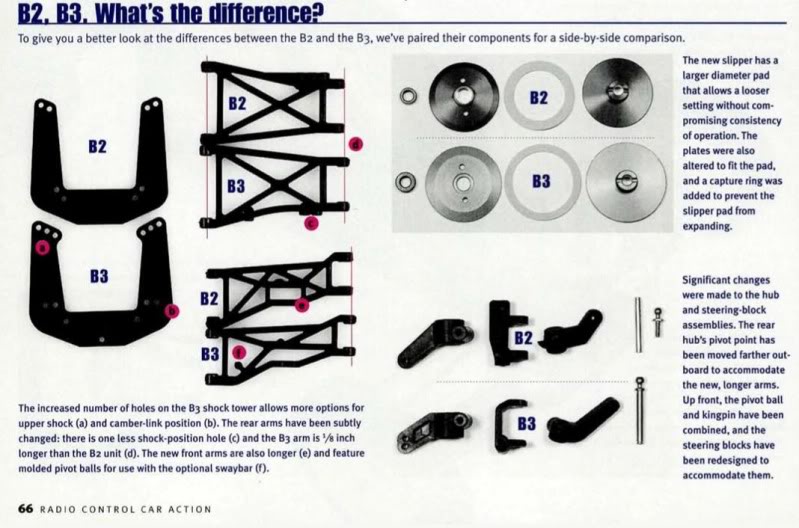

Thanks for the links! What were the parts you have in the first picture of your build thread?
Are they B2 parts or B3/4? I know the hubs you are using are different than on mine.
A parts list would be great! Thanks for the help

Re: RC10 B2 CVA fitment issues - help please
I am using B3 rear arms and hubs (the B2 stuff is getting hard to come by and I use this car as a runner, so I wanted to have a decent supply of spare parts).
rear hubs ASC7366
rear arms ASC9258 (one sale https://www.teamassociated.com/parts/details/9258-ASC9258-ft_rear_suspension_arms_carbon/)
You have to use both or none. The B3 arms are longer and the hinge pin hole on the hub is moved to accommodate the longer arm length while still using the same length driveshaft.
rear hubs ASC7366
