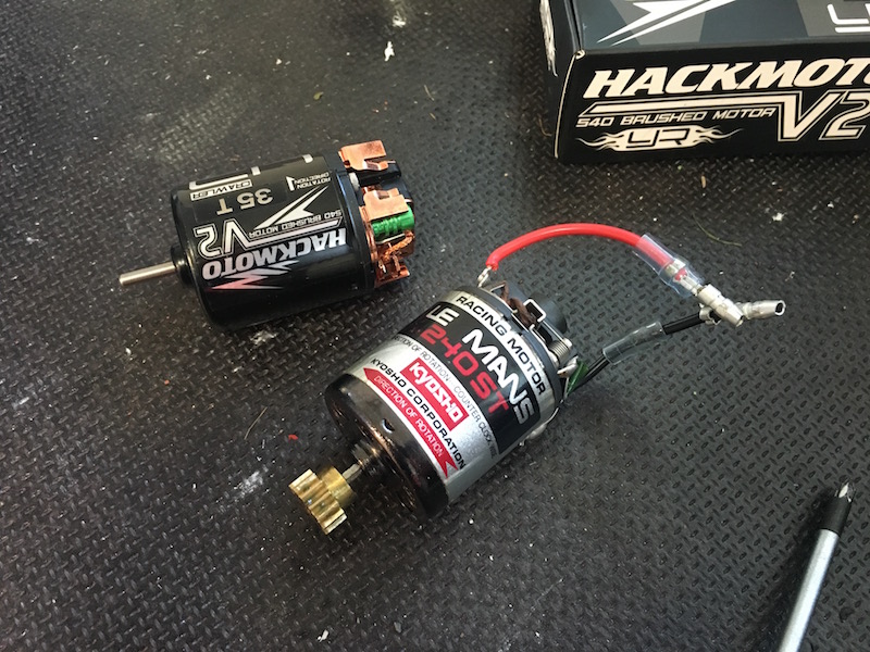

The order of two 35T motors went extremly fast, got them by post within 12h ! So yesterday after a bit of bed-in, I replaced one of the Le Mans of my kid with this little 35T and ????? Well, still way too fast ! I don't have the feeling it goes much slower than the Le Mans 240ST which is a 22T.
So back to the internet and ordered 55T this time !
Do you think I will get what I intend or if I really want a SLOW buggy, I will have to work on the gearing as well ? The pinion itself is a 14 teeth thing... I have no idea how to replace that in a Rocky.
Pictures of the work, because we all love pictures !
Thank you !

Hello, got the 55T mounted. Finally, works fine as wished ! In mode "fast" (handset switch training mode) you get 11 Kmh and if mode "slow" is selected it is 6-7 Kmh. That's perfect for my sons !
Thx all to nice advices
