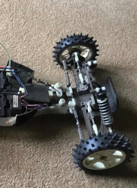

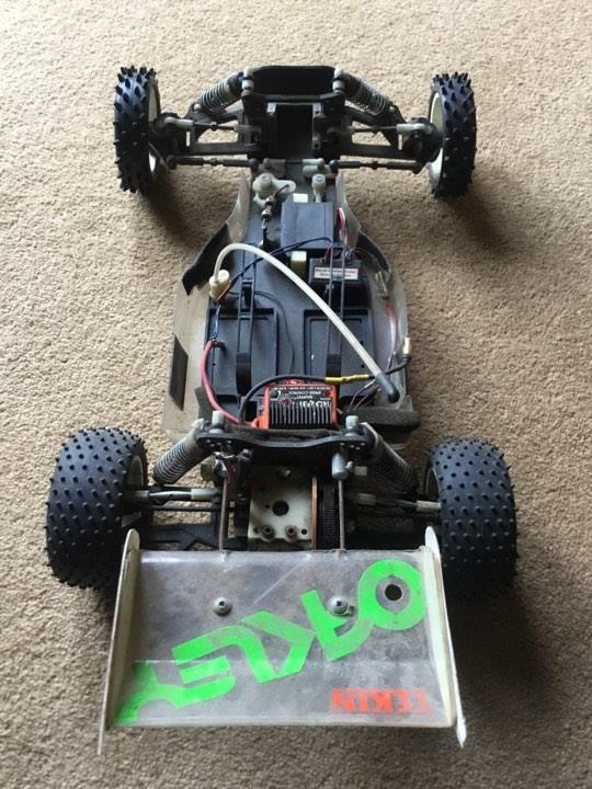

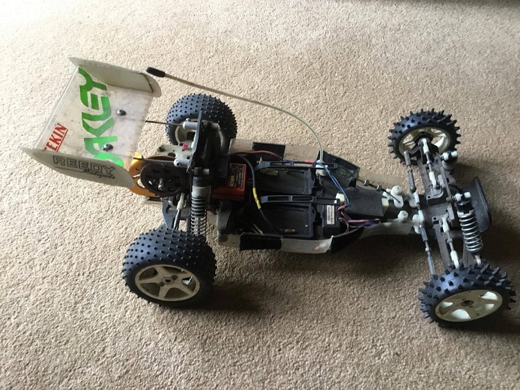

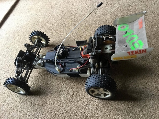

And here is the car, as found, having sat in the loft for the last 20odd years. Bit dusty, but you can see what it is and how it looks. Pretty unusual suspension set up, but it sure did work! It also meant many of the spares we carried were transferrable between this and my Works Yokomo which I will post up shortly in the required forum section.
Probably the best handling car I have ever driven.

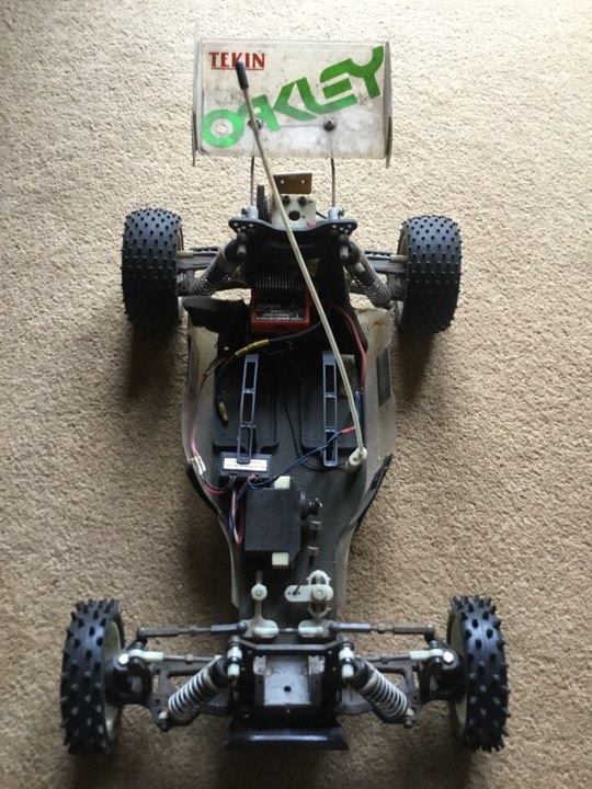

Front end.

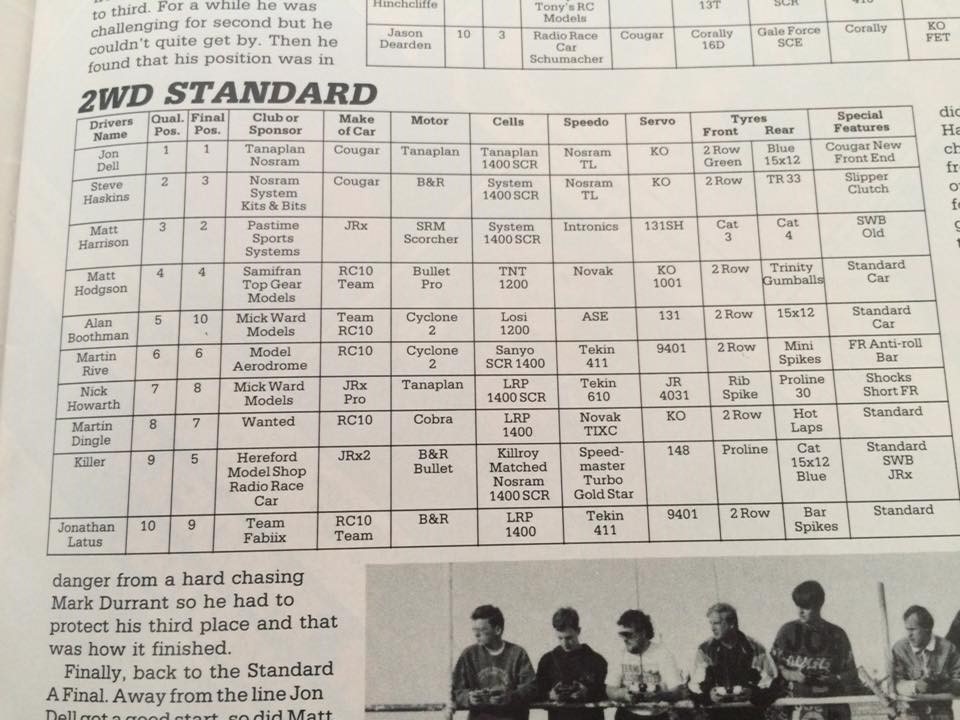

Found this online yesterday. The car gets a mention in the table pretty much as it currently stands.

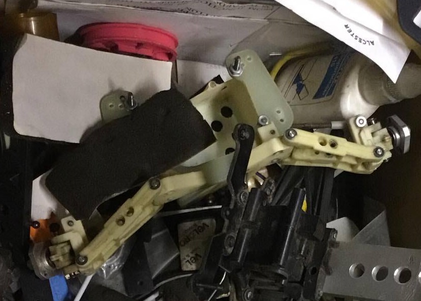

Ok, the plot thickens (a little).
Now I have this hub available to me for research I have started reading through the history and timelines for the RC10, in order to try to work out what I have (or originally had). I was a little concerned that my chassis wasn't an Associated version, but you can just make out the Associated symbol on the picture of the car where it is pointing away to the left in front of the orange Novak ESC. So it is the real deal.
I know we purchased the car very early in 1990, and it came with that chassis. The timeline for that appears to be correct from what I have read.

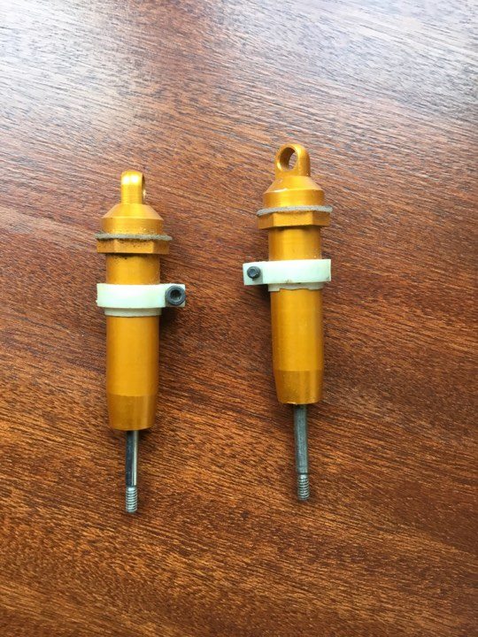

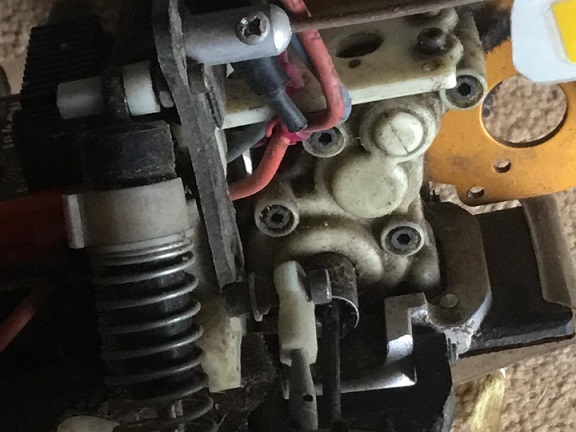

Poor pictures I know, but from the mish-mash box of spares I can make out the following.
The front suspension we received is the wider track version with longer, in-line arms. The suspension mount also has the 'newer' 4 hole feature at the top for shock mounting.
From this (admittedly very poor) picture of one of the rear suspension arms what jumps out at me is that is has the 'new' UJ drive shaft set up.
I was mistaken when I said the car came with dark, hard anno shocks (I guess I switched over to Yokomo items looking at my car today) and we have just uncovered the original gold anno shocks. Well the fronts anyway - the rears look to be still attached to the rear wishbones in the spares box at the moment.
Also - we definitely purchased the Stealth gearbox upgrade separately as I still have the box for that, and the original larger gearbox.
So where does that leave me? Can any resident RC10 experts comment on the above and work out which model this is based on the parts shown and compared to the box it all came in? There was definitely no gold pan chassis with the car as purchased.
I will try to get better pictures of the suspension components sent out to me and will update the thread accordingly. I am considering purchasing another chassis to mount these suspension components on to create a 'shelf' car, and really want to source the correct chassis for them - be that a gold anno version or another Graphite so any comments or feedback very much appreciated!?

What you had is a standard 6 gear RC10 graphite. But if you bought that 6000 kit brand new, you cut the factory seal on it, and that chassis and those universals were in the box, then there was a screw up at the factory during packaging. It should've had the gold tub chassis and dogbones.

Thanks for the reply scr8p. Great info.
The more I look the more I see the Graphite car spec here. I can also see the adjustable turnbuckle arms on the front wishbones. I need to check the original transmission to see whether it has the black idler gears and also whether there are the additional top shock mounting holes on the rear shock upright next.
The car was purchased new and my father and I built it up together - we wanted the Graphite spec. I am still suspicious that the model shop in question (you can see the price and the shop name on the lid) made a switch for us to lower the price of our purchase. If that was the case then the box(es) must have been opened in the shop and the contents switched - seems a lot of effort when they could have just discounted the purchase. I do definitely remember a deal being made in the shop on the day but it is very very hazy.
It looks like we have the complete package, but the box doesn't match. I believe from what I have just read we have the #6025 spec car here??
I have everything from the original car. Were these shock uprights specific to the Graphite model or was there an orange tubbed chassis version with these also?
If I want to build a shelf-spec car with these components do I need to be looking for another Graphite chassis if this is the case?
- Posts: 16816
- Has thanked: 36 times
- Been thanked: 1318 times
Re: RC10 Graphite - Heavy Custom
If your car had bushings it's a 6025 kit. 6030 with bearings.
Shock towers were the same between the graphite and gold tub CE. Biggest difference would been 1 piece tq wheels with the graphite kit, 3 piece wheels in the CE. And as i mentioned in the earlier post, uni's in the graphite car, dogbones in the CE.
