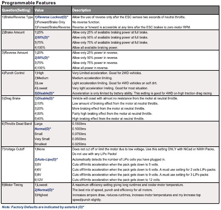

Program card looks like it has all the most basic functions. Just for comparison, here are the programmable functions of the Leopard Toro; the Turnigy was almost identical. The Bullistorm I mentioned earlier had even a few more options.
