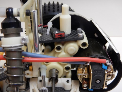

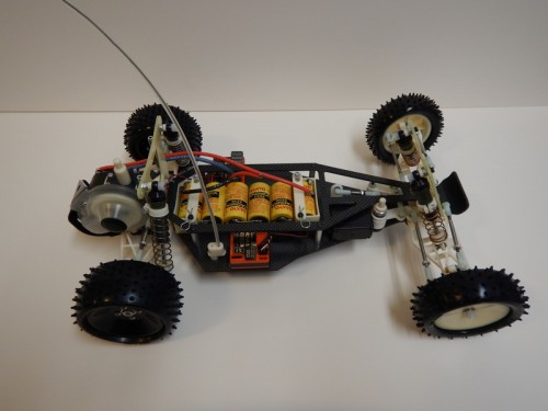

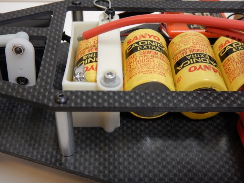

So I did a bit of work on the car the last few days. Got the battery boxes cut, and rear box holes drilled in back to remove soil and debris. Made a Sanyo 1700 sce battery pack with what I had.
Installed the Airtronics 94151 servo

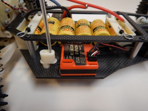

Installed the original Cliff Lett owned Novak NER-3FM 27mhz RX

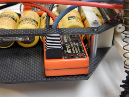

Sadly the ESC Cliff gave me was a later model than used at the 91 Worlds, so I restored and installed this correct Novak M1c with what I think is correct switch and zip tie placement.

Something interesting I found out when I visited Cliff and Curtis at AE. The rear springs used were not Yokomo, but only four sets were custom made buy a guy in Detroit just for that race (they could not remember his name at the time). If I remember what they said correctly, they were made the night before. So I took the Copper colored Yokomo springs off and placed these on.
