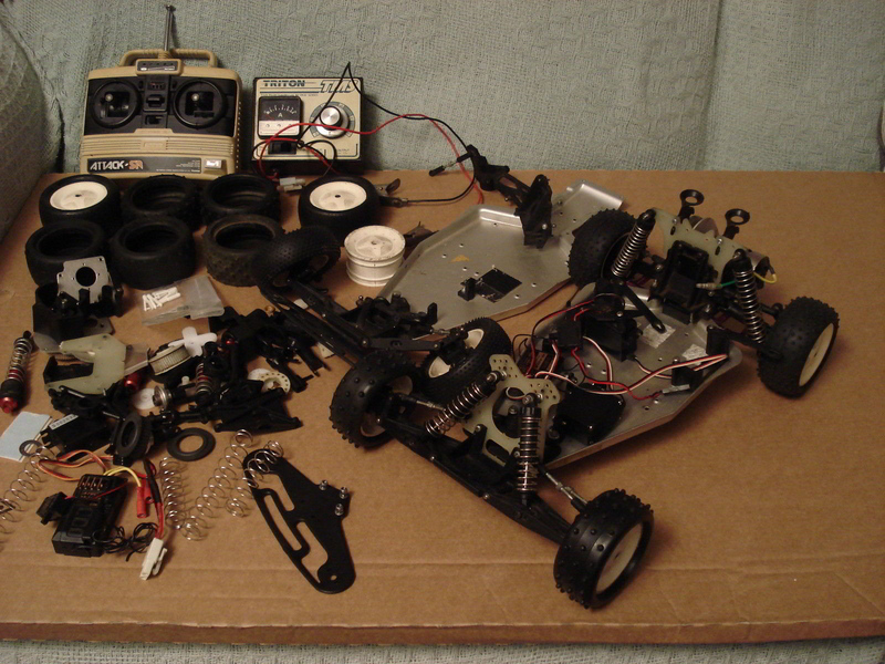

I'm entering two cars into the The Brett Davis Vintage GP at the end of month the Club 10 will be my 2wd entry.
When I bought the chassis and spares in the first picture below I wasn't sure which model cougar it was, it was just listed as “Schumacher cars”. Upon inspection I think I'm correct in identifying it as a Club 10 its shocks have black plastic bodies and the chassis looks to have the holes drilled for a mechanical speed controller.
Their are a few nice spares in the pile of parts that came with it, the second chassis is in much better condition than the one on the complete car which is dented and bent. There is also a complete set of red vari shocks, a spare diff, wishbones and other useful parts to keep this cat racing :) all in all I'm very pleased with the haul.
I decided to build the car with a brushed motor and wanted to keep the car as Schumacher as possible including the electrics. I have found an FH1000 esc and a few choices of Schumacher motor to power it and to future proof the car it needed a slipper clutch so I ordered a cougar 2 works transmission for parts.
I will be using modern radio and lipo batteries so a big part of the build has been finding a neat way to hold a shorty battery.

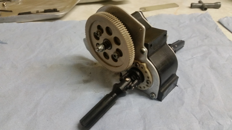

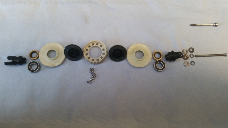

Between the Cougar 2 works transmission and the Club 10 lot I ended up with three identical diffs, can anyone tell me which spec it is I don't think they are club 10 or works spec the diff washer carrier is plastic, I think the works ones are alloy?
The Slipper clutch needed a new race for one side of its thrust bearing, the pic shows original snapped in two :shock: but other than that it was just a case of cleaning and giving it fresh silicone grease and it was as good as new.

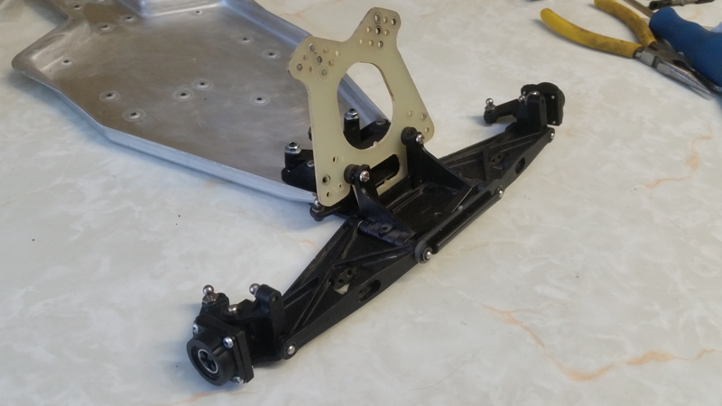

I had hoped to use the front shock tower that came with the car but when I fitted the red vari shocks found that the shocks were two short. I guess I need to keep an eye out for a set of rears to get it to work. Thankfully I have a Cougar mk1 one project which came with a home made shock tower, after much measuring I found only one set of holes to be evenly spaced so although it looks like I have lots of shock set up options any other position would leave the shocks at odd angles.

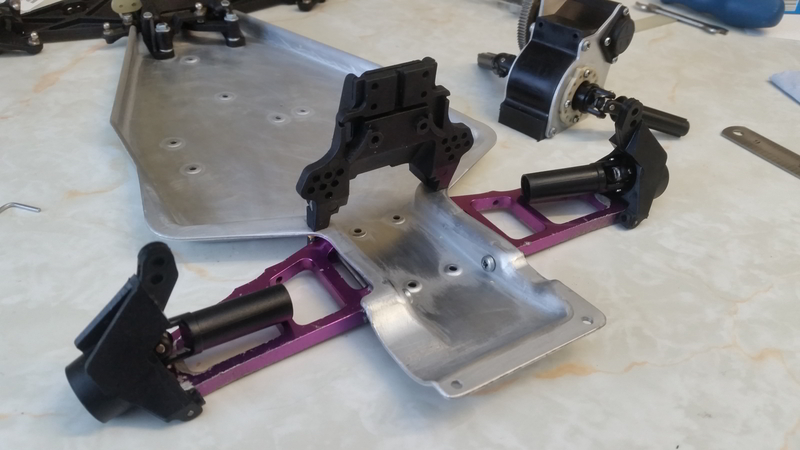

Anyone recognise these purple alloy rear wishbones that came fitted to the car? When fitted with a single washer between chassis and pivot block it gives the wheels mad toe out, I would need to use lots of spacers to get 1 deg toe in which would probably leave the suspension with lots of unwanted flex. I guess they are for a different car, perhaps they would work better with a Cougar 2 works I figure it has a different chassis to the other early cougars, my works transmission certainly wouldn't fit on my chassis with out drilling new holes.

The red alloy shocks would have been the standard shocks for the club 10
Yes the works gear box should have a pro diff with alloy carriers, looks like you only have a trilobe (sport)diff unfortunately so you works box may just have been a conversion kit.Schumacher did a works conversion kit that had a fibreglass template to drill the chassis for fitting. If I was you I would use the works box as it moves the diff slightly to the rear of the buggy to straighten out the angle of the driveshafts.
The works chassis is exactly the same shape as the chassis's you have except for no holes for manual speed controller, gearbox mounting holes and a small checkout for more travel of the rear arms.
The alloy rear arms look to be an option part for 1 of the nitro vehicle where the engine is in front of the shock tower and the shocks fit on to the rear of the arms meaning yours are back to front hense the toe out.
As for towers you can get carbon 1's for fibre-Lyte new
http://www.fibre-lyte.co.uk/fl/cars/schumacher/fl_cougar2.html
Hope this helps out and good luck 8)

Thanks Adrian that helps a lot, I will have to buy a nito car to put those purple wishbones on :D
