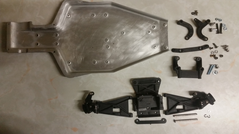

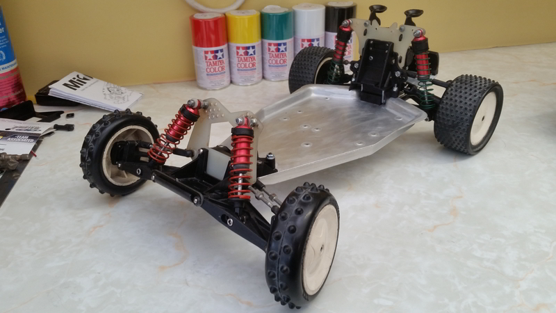

When I bought the chassis and spares in the first picture below I wasn't sure which model cougar it was, it was just listed as “Schumacher cars”. Upon inspection I think I'm correct in identifying it as a Club 10 its shocks have black plastic bodies and the chassis looks to have the holes drilled for a mechanical speed controller.
Their are a few nice spares in the pile of parts that came with it, the second chassis is in much better condition than the one on the complete car which is dented and bent. There is also a complete set of red vari shocks, a spare diff, wishbones and other useful parts to keep this cat racing all in all I'm very pleased with the haul.

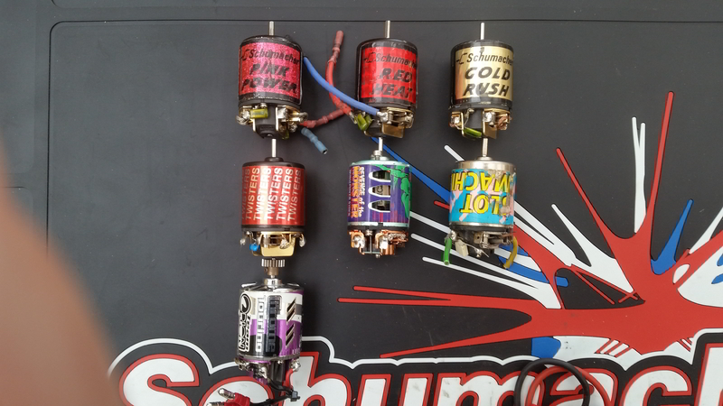

I decided to build the car with a brushed motor and wanted to keep the car as Schumacher as possible including the electrics. I have found an FH1000 esc and a few choices of Schumacher motor to power it and to future proof the car it needed a slipper clutch so I ordered a cougar 2 works transmission for parts.

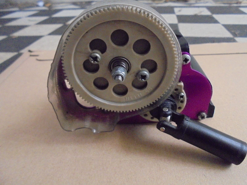

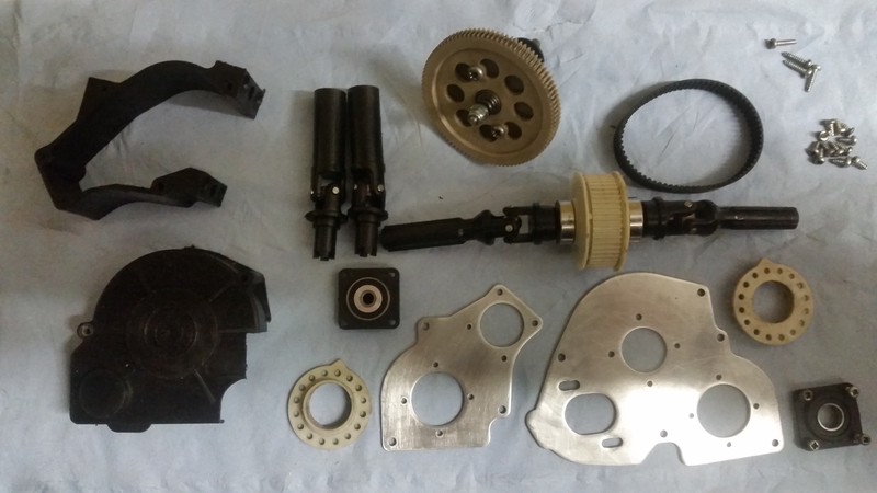

Between the Cougar 2 works transmission and the Club 10 lot I ended up with three identical diffs, can anyone tell me which spec it is I don't think they are club 10 or works spec the diff washer carrier is plastic, I think the works ones are alloy?

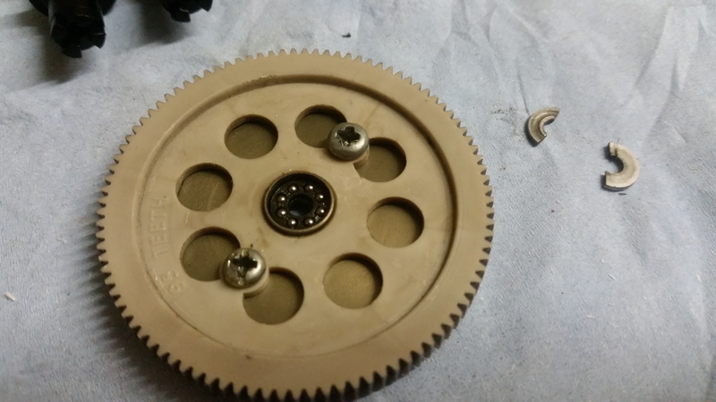

The Slipper clutch needed a new race for one side of its thrust bearing, the pic shows original snapped in two but other than that it was just a case of cleaning and giving it fresh silicone grease and it was as good as new.

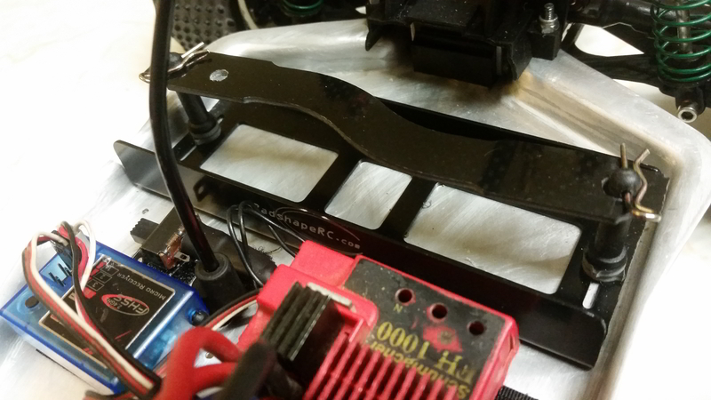

The shorty battery has been secured with a cut down Radshape battery holder and mission posts and strap I have added a little hole in the strap to get a balance lead and lipo low voltage sensor fitted. I will use foam to stop the battery from moving and shearing off the balance lead.

First off welcome to the wonderful world of Schumacher
To answer a few of your questions
The red alloy shocks would have been the standard shocks for the club 10
Yes the works gear box should have a pro diff with alloy carriers, looks like you only have a trilobe (sport)diff unfortunately so you works box may just have been a conversion kit.Schumacher did a works conversion kit that had a fibreglass template to drill the chassis for fitting. If I was you I would use the works box as it moves the diff slightly to the rear of the buggy to straighten out the angle of the driveshafts.
The works chassis is exactly the same shape as the chassis's you have except for no holes for manual speed controller, gearbox mounting holes and a small checkout for more travel of the rear arms.
The alloy rear arms look to be an option part for 1 of the nitro vehicle where the engine is in front of the shock tower and the shocks fit on to the rear of the arms meaning yours are back to front hense the toe out.
As for towers you can get carbon 1's for fibre-Lyte new
http://www.fibre-lyte.co.uk/fl/cars/schumacher/fl_cougar2.html
Hope this helps out and good luck

Thanks Adrian that helps a lot, I will have to buy a nito car to put those purple wishbones on
Unfortunately I don't have a complete cover for the gears as I want to race the car I will have to wait till I find one before doing the gearbox upgrade.

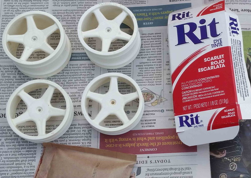

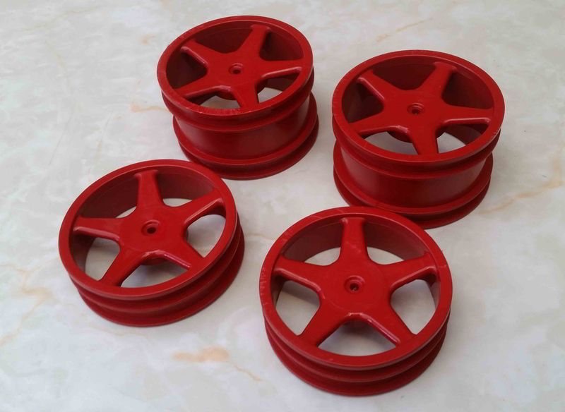

I had a go at dyeing some wheels today, it proved to be a satisfying experience. I followed the instruction, adding, vinegar, detergent, half the bag of dye and a kettle of boiling water. It took about 15 mins and they look a nice deep red

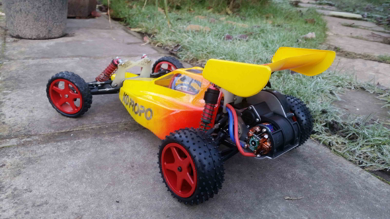

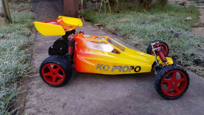

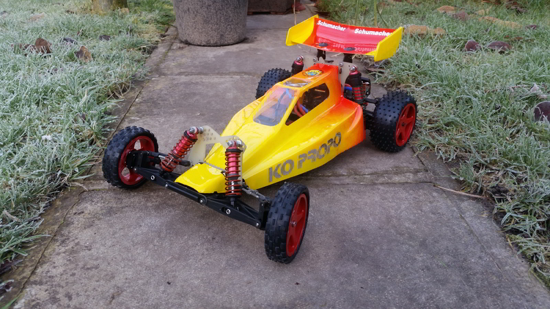

The Car is ready just need to get the ProCat finished now.

First off seeing the wheels by themselves I was thinkin you made the same mistake I made a long time ago with one of my 1/8 scale buggies. I dyed the rims with the same color dye and had regrets.
THEN, I seen it on the car. That looks great. A little blood red action going on and it ties in with the body fade quite well IMHO. Turned out killer
Re: Club 10 Racer
Thanks Todd. I'm very pleased with the results, the red wheels and yellow body were requested by the organisers of The Brett Davis Vintage GP as a homage to Brett and Brum.
Really looking forward to driving it now hopefuly I can get to a track before the race to work on the setup.

I thought that one difference between the club 10 and the other cougars was that they had a geared transmission… but I like the belt trans anyway. I do wish cougars were a little easier to find on this side of the Atlantic, but just not so much.
