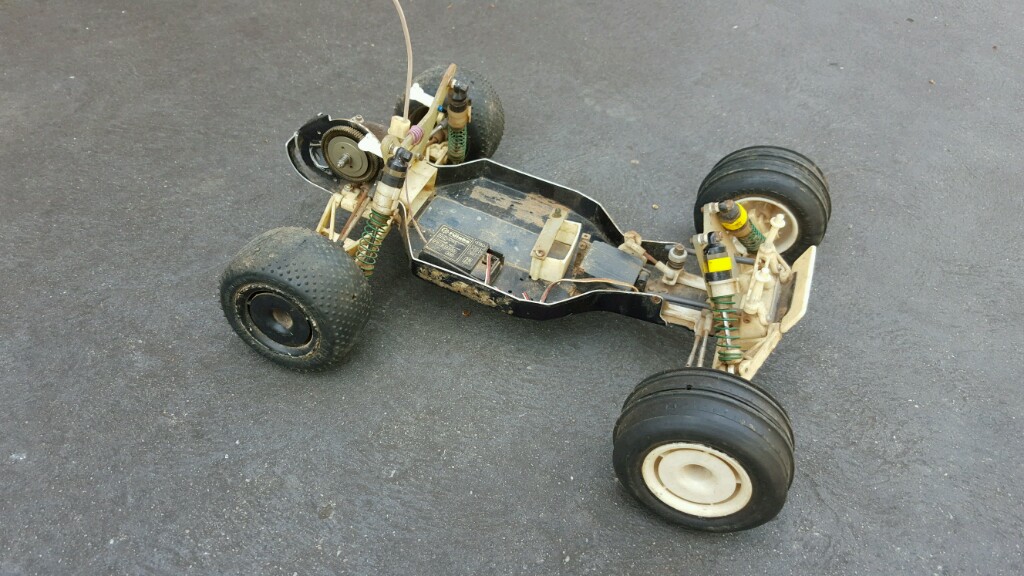

What I have so far is the accumulation of several eBay auctions. It is all bolted together.

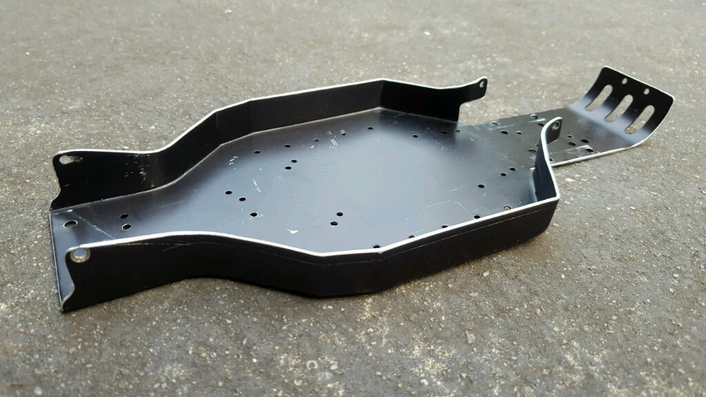

Some of the parts are in pretty bad shape, see the bend on the tub.
An RC10 is like a Jeep. The Jeep was made for WW2 and they produce every part for that Jeep and every Jeep since still to this day. It is not about if you can repair it it is about when you give up on it. I will straiten this tub on my press brake and make it a runner. As of right now it is all taken apart and is sitting in a cleaning solution.
The wheels and hub carriers will be upgraded to take modern 2.2" wheels. The tub will be drilled to take a Stealth Transmission. The Stealth tranny will be 100% new, with a B4 top shaft and VTS slipper. Will go with a waterproof brushless setup. Anyways this is the start.

You will get used to re-bending the chassis flat again :mrgreen: it's just part of ownership

Some wood, a clamp and a size 11 is the best tool :lol:

That's got to be the most bent chassis I've seen. I loose my shit when I get a chassis with the front end bent just a little, wow.

So I tried fixing the "A" Stamp chassis to no avail.
In the end I ended up stretching the metal and making it dish shaped. Could not shrink it back to shape...
But lucky for me I have a "B" stamped chassis as a backup. Really wanted the gold chassis but this is a beater build so ohh well...
I will put on the milling machine a bit to clean it up. At least I don't have to drill holes for the Stealth Transmission.

Try giving the chassis another go. As long as it's not creased or hairline cracked you can save it.
This was the most bent chassis I've had but with patience it turned out as square as a new chassis.

Unfortunately it is creased and dished. I hate that happened. But it is what it is. I may keep it to play with.
