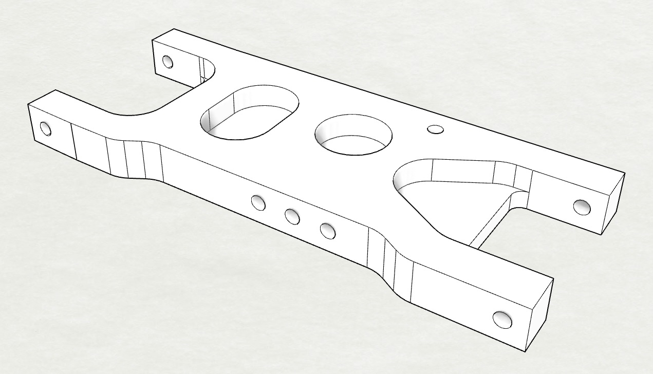

Anyway, This is the design for machining: in Delrin or nylon or whatever you can get.
A 3 axis machine would be enough and you'd only have to change the part orientation once since there's no machining from the bottom side.
(Slight disadvantage: left and right are mirrored = not symmetrical, which means 2 different milling programs and possibly higher charges than 2 identical parts)
I recommend a 12mm bit to do the outline and pockets quickly, and 4mm to finish the smaller radii. The holes for the shockmounts and hinges are 2.5mm. You can manually tap them for M3 and ream them for the 3mm hinges.
What kind of file would you need? I can do a step (stp) export, stl (good for printing I think), or a 2D drawing in dwg format for a laser cutter or waterjet cutter, or plain pdf with dimensions: for the folks who have no data exchange.
Both versions are available for free: send me a pm with your email and tell me what you need.
(But maybe wait a bit till I've got the rear ones finished also.)

Hi MrEd, can you do a .dxf file? Ive been toying with making arms on a manual mill, but would like to try sing my cnc. The material i have is too thick, so I would likely add a rough cut process to the mix, or possibly mirror the process on each side to produce symmetrical arms.
Mr. ED
Posts: 5483
Has thanked: 62 times
Been thanked: 62 times
Re: YR-4 custom buggy conversion
Post by Mr. ED »
Sure I can do dxf. That's just a variant of the dwg format.

And the machined version for the rear:
I've added 2° of toe-in at the wheel hinge.
That'll make it harder for the machined version, I know. But it made a world of difference on my YR4.

Wow Mr. Ed! I am thoroughly impressed. I better get my act together and buy that mill! You exceeded anything I'm capable of in 5 minutes. Let me see if I can catch up. :shock:

It took me quite a bit more than 5 minutes to do this . But it went pretty smooth. I'm glad you like them.
They are easy enough to modify, so maybe some day I'll make some slightly shorter ones to use with cvds and hex wheels with more neutral offset.
