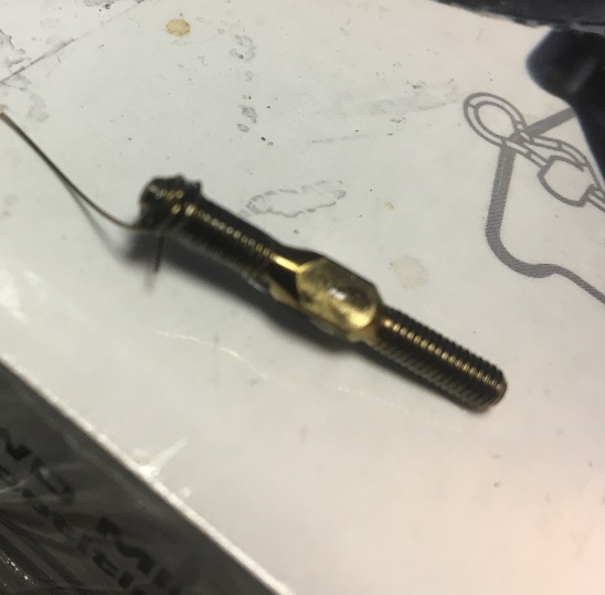

I wanted to start a thread to collect some advice, experiences, suggestions, etc from everyone's experience with working on the "metal pieces" of the RC cars.
Cleaning, Scratch Repair, Polishing, Plating, Coating, Anodizing... What does your setup look like? What's your process? Lessons Learned?

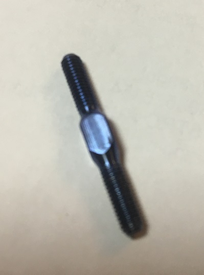

I've started to explore refinishing the metal bits of my RC10 DS project. I did a bath, bake, and quench on some steel ti-rods that look decent to me for a start. Looking at some DIY nickel plating and even trying some DIY anodizing. It really doesn't look to difficult (or even that expensive) to try... just a question of getting a process that gives decent results.

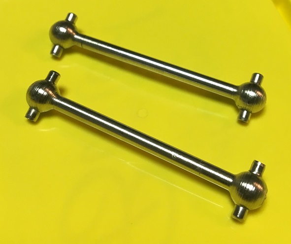

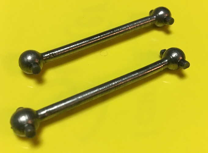

Some results for cleaning up some old dog bones. I was testing on some dinged up ones. I think some better cleaning/prep and surface work could have better results especially with the plating.
Both cleaned (vinegar bath, washed and degreased), heated to 450 for 20 min and oil quenched (vegetable oil). Gave a pretty nice and smooth dark finish. In light, some parts did have a faint brown tint. Then I cleaned one up again and did a simple nickel plating in my DIY setup with just some jewelry cleaner/polish. Up close you can see the imperfections but at first glance or a short distance they do look shiny.

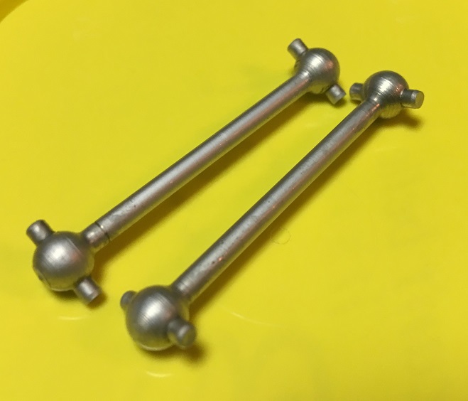

Actually took a little time to prep, clean, nickel plate and polish some DS dogbones. Results are pretty decent. Stating the obvious, but the time put into the prep dramatically impacts the quality of the finished product.
Step 1 - Cleaned Step 2 - Plated Step 3 - Polished

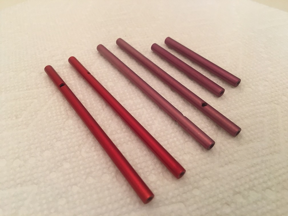

Re: DIY Metal Finishing - Plating - Anodizing
My best result trying some home anodizing. Just testing with RC10 wing and nose tubes...

If you don't mind sharing, what was your exact process for the nickle plating?lmw94002 wrote: ↑Fri Feb 10, 2017 10:37 am Actually took a little time to prep, clean, nickel plate and polish some DS dogbones. Results are pretty decent. Stating the obvious, but the time put into the prep dramatically impacts the quality of the finished product.
Step 1 - Cleaned
Step 2 - Plated
Step 3 - Polished
Rod Littau
- lmw94002
- Posts: 349
- Location: Boston, MA, USA
- Been thanked: 9 times
To over simplify the way I did it...
1) Make a nickel acetate solution. Can be purchased or it can be created with vinegar and a pure source of nickel. I made mine (requires power supply).
2) Clean the crap out of the part. I acid washed them, dremel wire brush, chemical degreaser too, rinsed, dried and polished w/ dremel.
3) Then you hang the part in the nickel acetate solution and connect up a power supply, one pole to the part, and another to a piece of sacrificial nickel.
The art is in making the solution and then finding the best current/voltage powersupply and length of time for the process. Very similar to anodizing, but easy to do IMO. Remember it only works on steel parts, not aluminum. I haven't tried a threaded steel ti-rod yet to see how bad the playing gums up the threads though, but it's on the to-do list.
For me it was really no cost other than finding a source of nickel because I had stuff laying around that I could use. Youtube has a few videos I watched to help get me going.

Just wanted to add a few pics of things I've been able to do in the Anodizing Department. Still working on being able to consistently reproduce results, but I'm making progress.
Titanium Anodizing... Aluminum Anodizing
