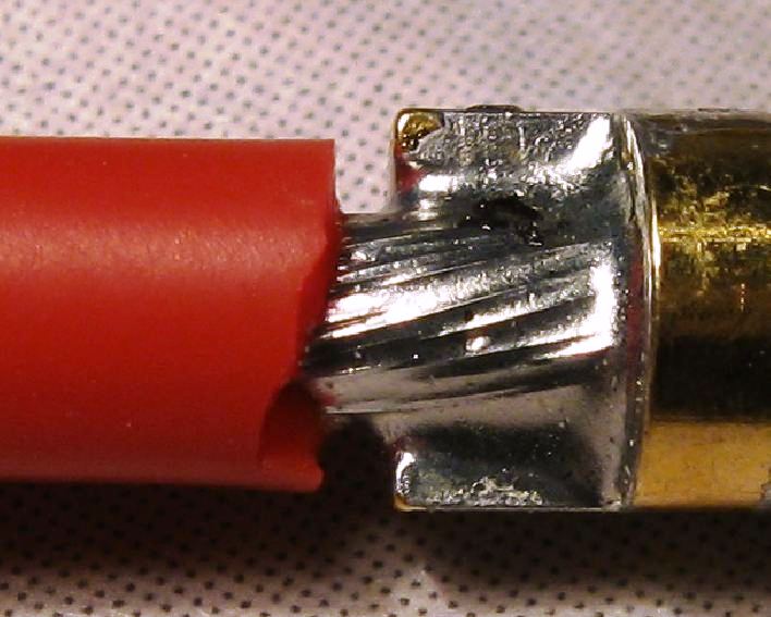

I would use the same bullet but remove as much solder as you can. Unsolder and remove wire from bullet plug, remelt solder on bullet plug and wipe off with damp cloth. If you use the same solder that's on the plug again and again you end up burning off all the flux and no matter what will be a poor joint.
As stated earlier heat is your friend, for large wires you want as much heat as you can, but not so hot that the flux vaporizes off the tip straight away. The parts being soldered have to be about the same temperature as the iron, hence the high and quick heat application. Anything that takes longer then about 5 seconds to solder is too long, either the iron is too cold or the tip isn't transferring enough heat.
When the iron is up to temp wipe the tip clean and tin it with some fresh solder, watch how it flows onto the tip, this is what you want it to do on the wires and plugs.
While the tip is freshly tinned bring the iron to the bullet plug and feed fresh solder into the spot where the tip and plug touch. Continue feeding solder untill there is a nice pool of solder and pull away.
Tin the wire the same way as the plug, the wire will suck up more solder then the bullet, so keep feeding fresh solder till the wire is "full" and tinned equally around the whole diameter of the wire.
Bring the wire to the bullet and without using more solder use the iorn (tip still tinned though) to join the two together untill the whole joint flows together. The ideal amount of solder is a nice flow between parts where you can still see the wire strands.
I couldn't find many pictures of good solder joints of wire and bullet plugs but these are examples of what a perfect joint looks like (taken from google)
