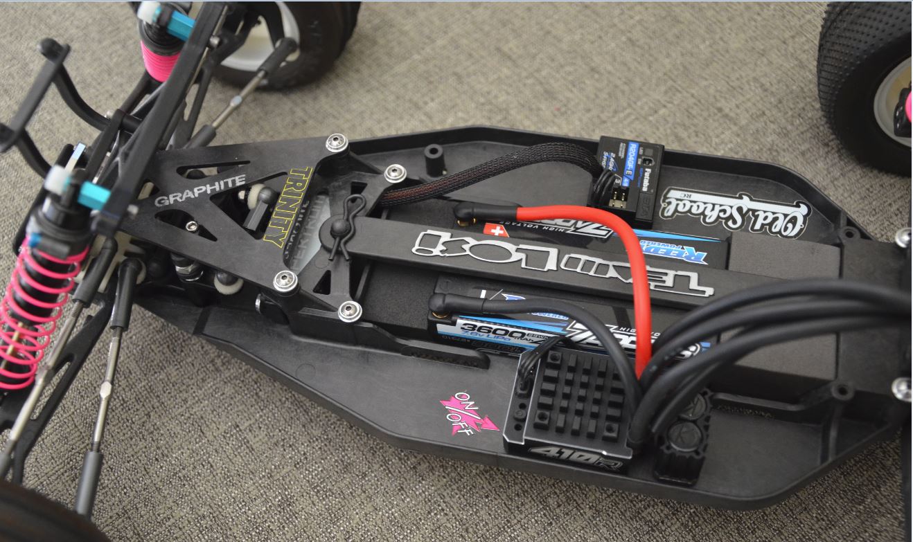

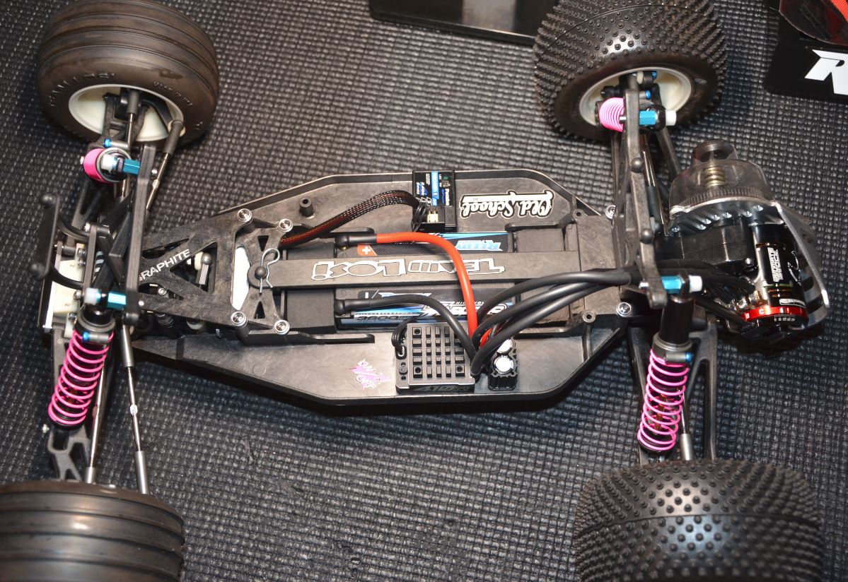

Couple of updated pictures. I am hoping to make it to Vonats this year.
