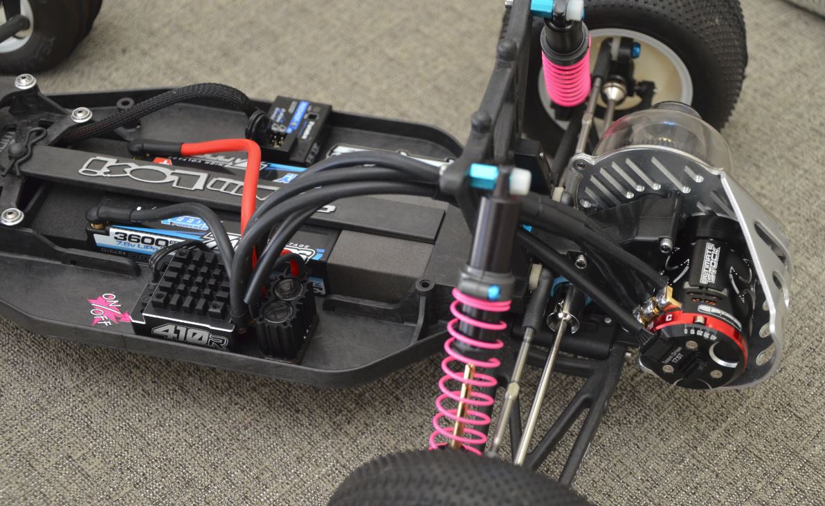

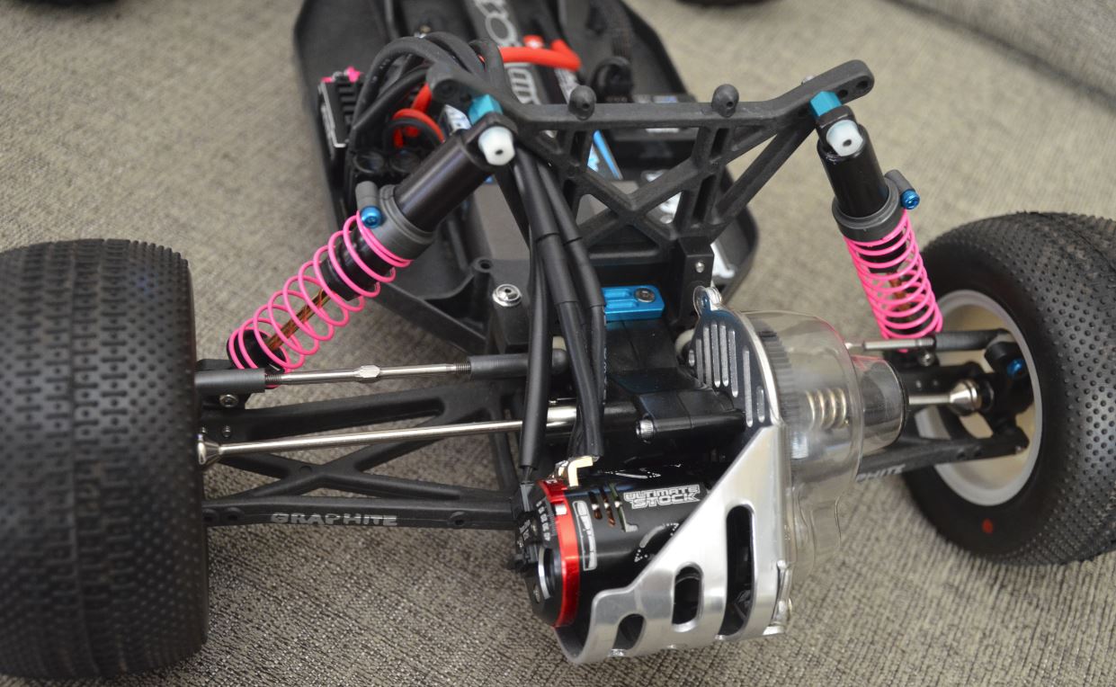

I changed out some of the electronics, and am much happier. After much messing about with the diff, I think it is working well now. I still have not driven it outside, but my few indoor tests felt good.
Just a few minor details to finish, and I need to order and paint a TBG body for it. I don't want to use any of my originals on it. I will post some better pictures soon.

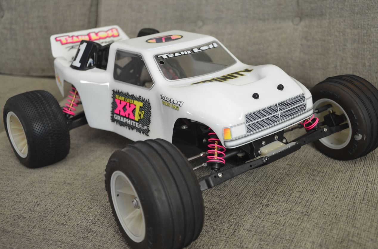

I finally ran the truck in my driveway, and was very impressed. It seems to handle great. I think it would easily be competitive in a modern stadium truck race. Very impressed.
LosiXXkid
Posts: 757
Re: Losi XXT CR Graphite Plus - Runner Build
Post by LosiXXkid »
lavigna wrote: Tue Feb 28, 2017 5:09 pm I finally ran the truck in my driveway, and was very impressed. It seems to handle great. I think it would easily be competitive in a modern stadium truck race. Very impressed.
Looks great! And practically like a new build..... 8)

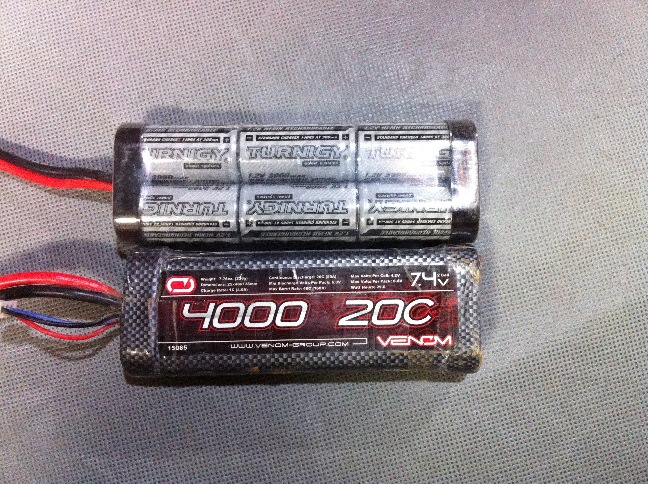

Item #1 was my culprit. Being that mine is a XXT Sport, I assume that it did not originally have ball bearings in the diff. Someone before me had put bearings in there and the one in the center of the diff gear was too thick. I fabbed a bushing for mine that matched the thickness of the diff gear and it now works flawlessly.
As for battery fitment issues, just search for different batteries. There are almost infinite battery possibilities out there and several that fit perfectly in a XX chassis. Here is what I use that fits just like the NiMhs.

i had a look at hobbyking and they have narrower packs in the zippy compact range that are 43mm wide, i can get up to a 4000mah pack which is plenty and it should slot in without any modification

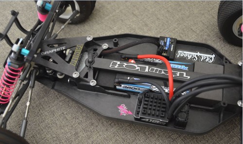

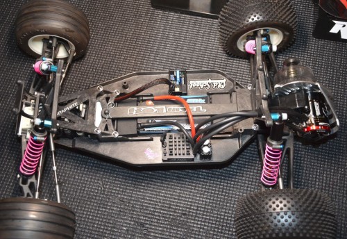

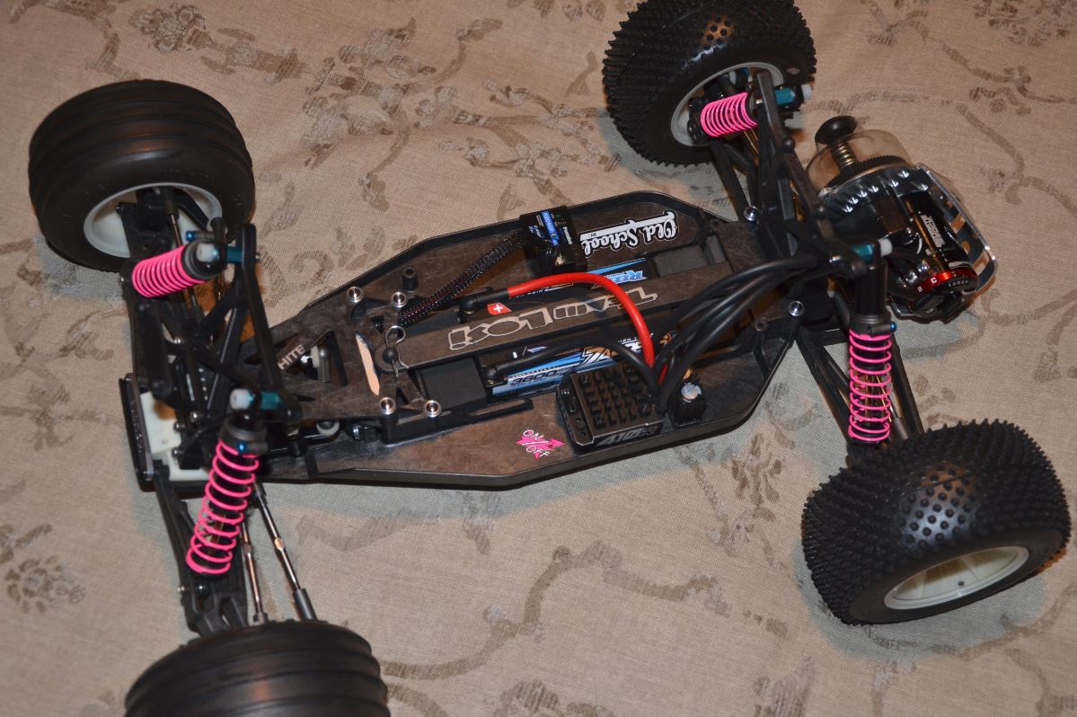

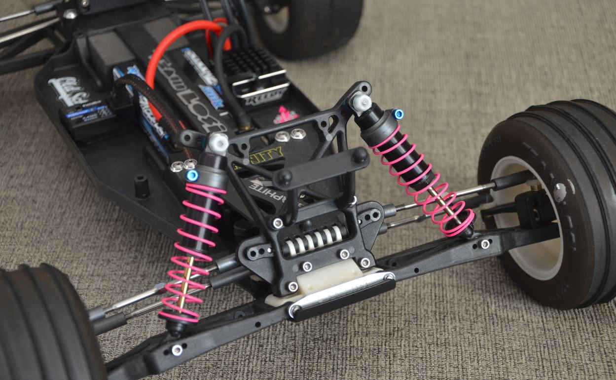

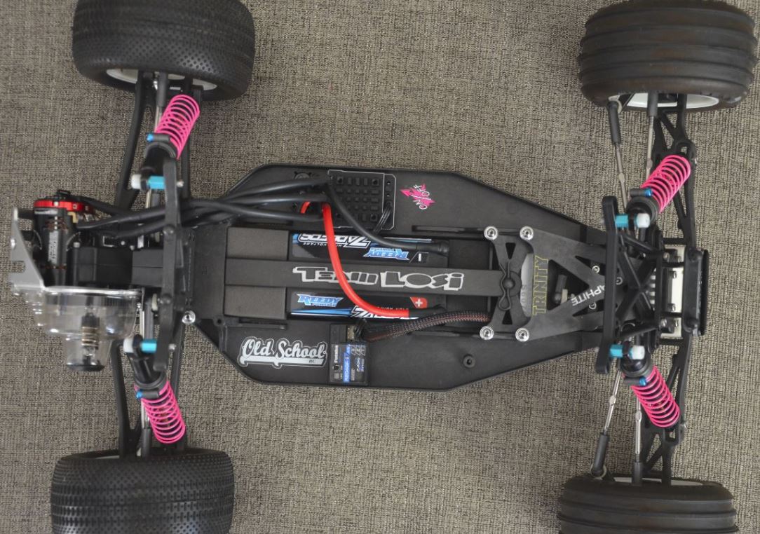

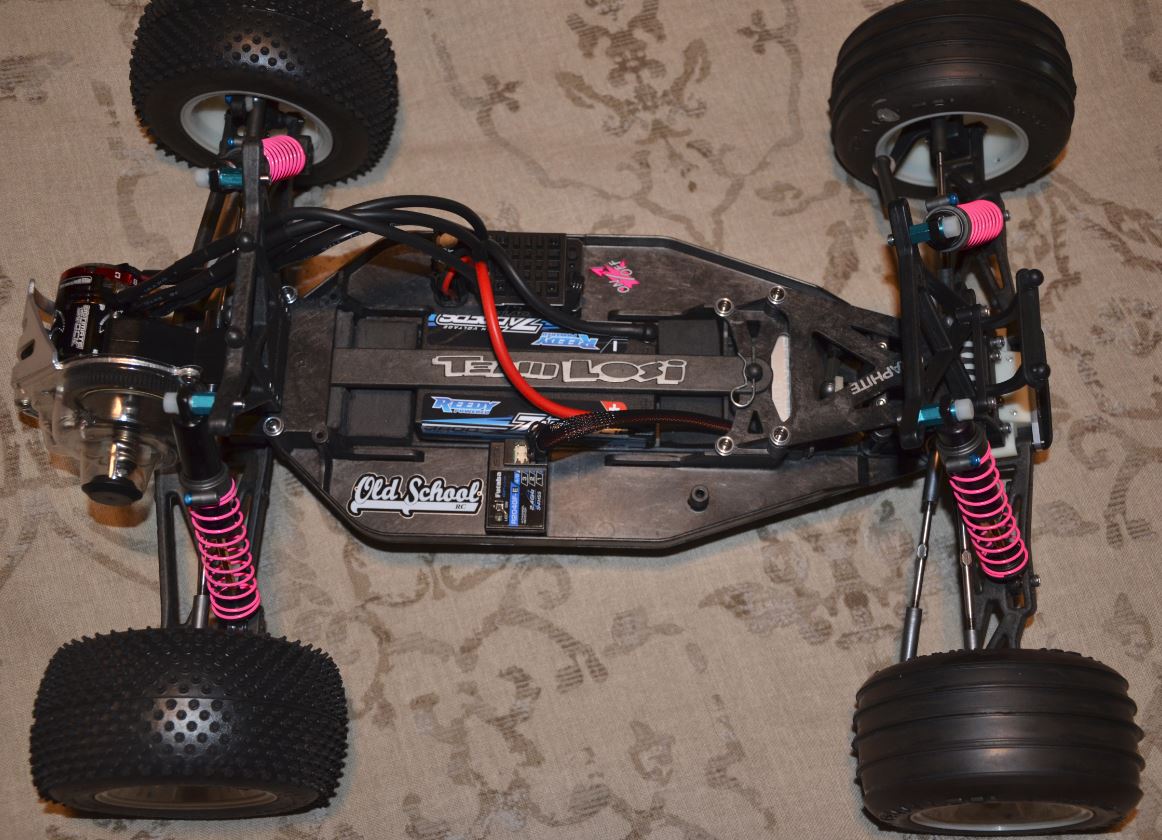

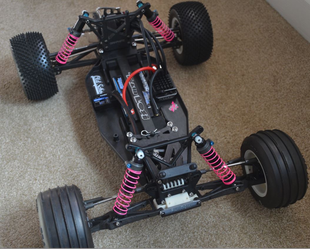

Couple of updated pictures. I am hoping to make it to Vonats this year.
