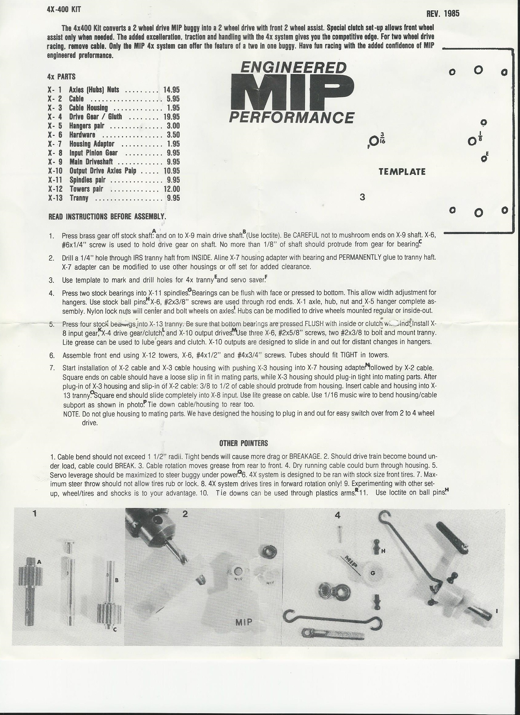

I have a questionsas I'm finally assembling my MIP 4x400 car too, using IRS-200 and T200 tranny with one of GoMach's awesome 4x Chassis.
It looks like you have used a housing adapter on the rear tranny that is similar to MIP part X-7, the housing adapter for front tranny that holds the cable in place. The T200 doesn't have such as adapter and no adapter for the rear tranny is included in the MIP 4x400 kit ( certainly not the one I have anyway). What is this part please, and without it, how do I attached the cable and housing to the T-200?
THANK YOU!!
THANK YOU!!

The X-7 housing adapter gets glued to the T200 case the front case has the adapter molded in.Meakz1973 wrote: ↑Thu Feb 08, 2018 11:15 am
THANK YOU!!
If your front case doesn’t have it then possibly it’s a later version or has been modified to run the chain drive. The chain drive requires you to cut the housing adapter off the case to make way for the chain sprocket and new top shaft.

Thanks Shodog. My front tranny case doesn’t have an adapter pre molded,and when you read step number 2 on instructions I posted it says to drill 1/4” hole, which I did, and then glue X-7 to front tranny case. What am I missing? Even if it’s a later version( I didn’t know / don’t know if there was more than one 4x400 cable version) then the instructions and included parts don’t accommodate an X-7 type housing for rear any tranny case. The front case hadn’t been modified in any way before I drilled the hole and this is a cable not chain 4x400 kit. Baffled...

Are these the instructions you have? Looks like they want the rear gearbox drilled for the adapter. They call the front gearbox case by part number x-13, but it says to drill and glue the IRS case in step 2

This makes sense now! For the record I was wrong, my front tranny case does have a pre molded adapter, as shown.
