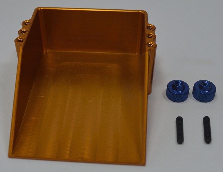

You mean something like this?
DHAWK makes the cup that has 3 bolt holes... I haven't tried it to know what exactly it gives you...

Re: New to me RC10 Team Car on the way
That's exactly the sort of thing I was thinking of. Where can I find out more?

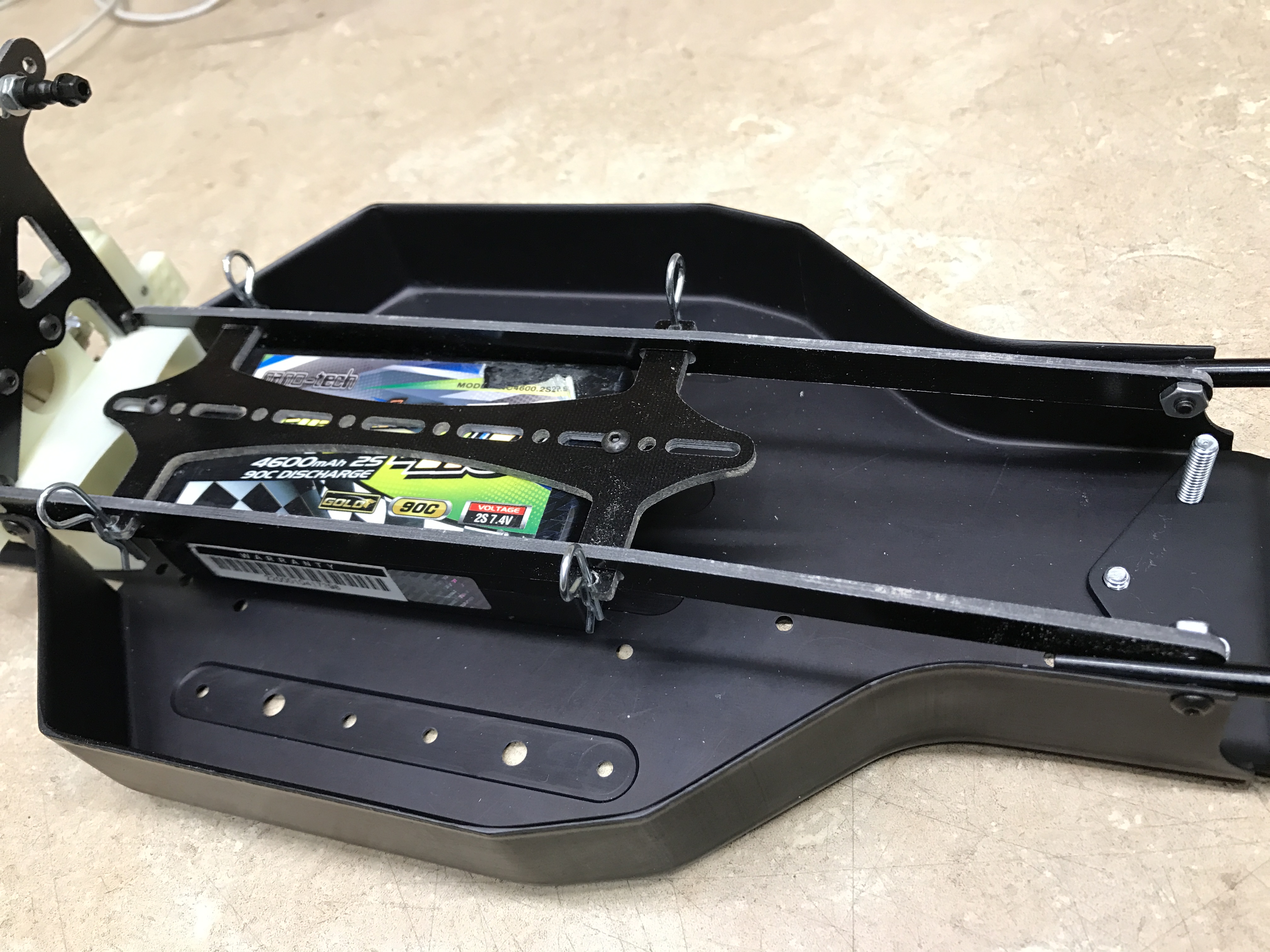

I used something a little different for a stick pack. I had a beaten up battery cup so I trimmed it down to just a base part. you could easily just trim the front out of a good battery cup. Then made a top plate that has some standoffs attached to stop the pack at the top. Using two, this will work for a lipo pack that has front exiting wires. if they are top exit wires, the top plate can be modified to avoid the wires.
worked beautifully at VONATS and there were some spectacular barrel rolls and crashes on my part due to lack of driving skills.
the front car has the brace I am talking about. the battery box holes are original. The rear car had the battery box moved forward about 1/4"(new holes)
