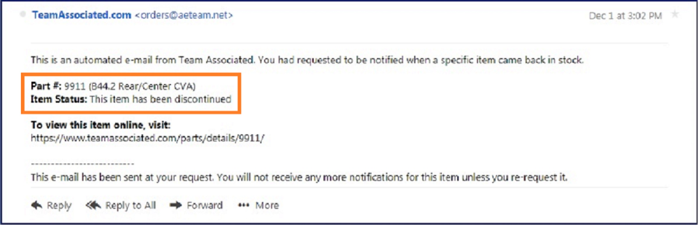

Post by XLR8 »
Just received this morning...

Re: B44 Dogbone #9911 is discontinued
Post by NomadRacer »
eBay results are sadly lacking, 1 hit for 1 each.
