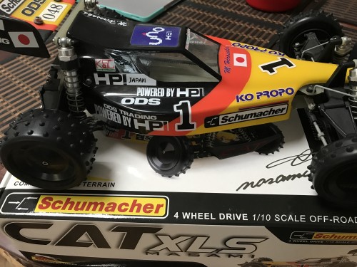

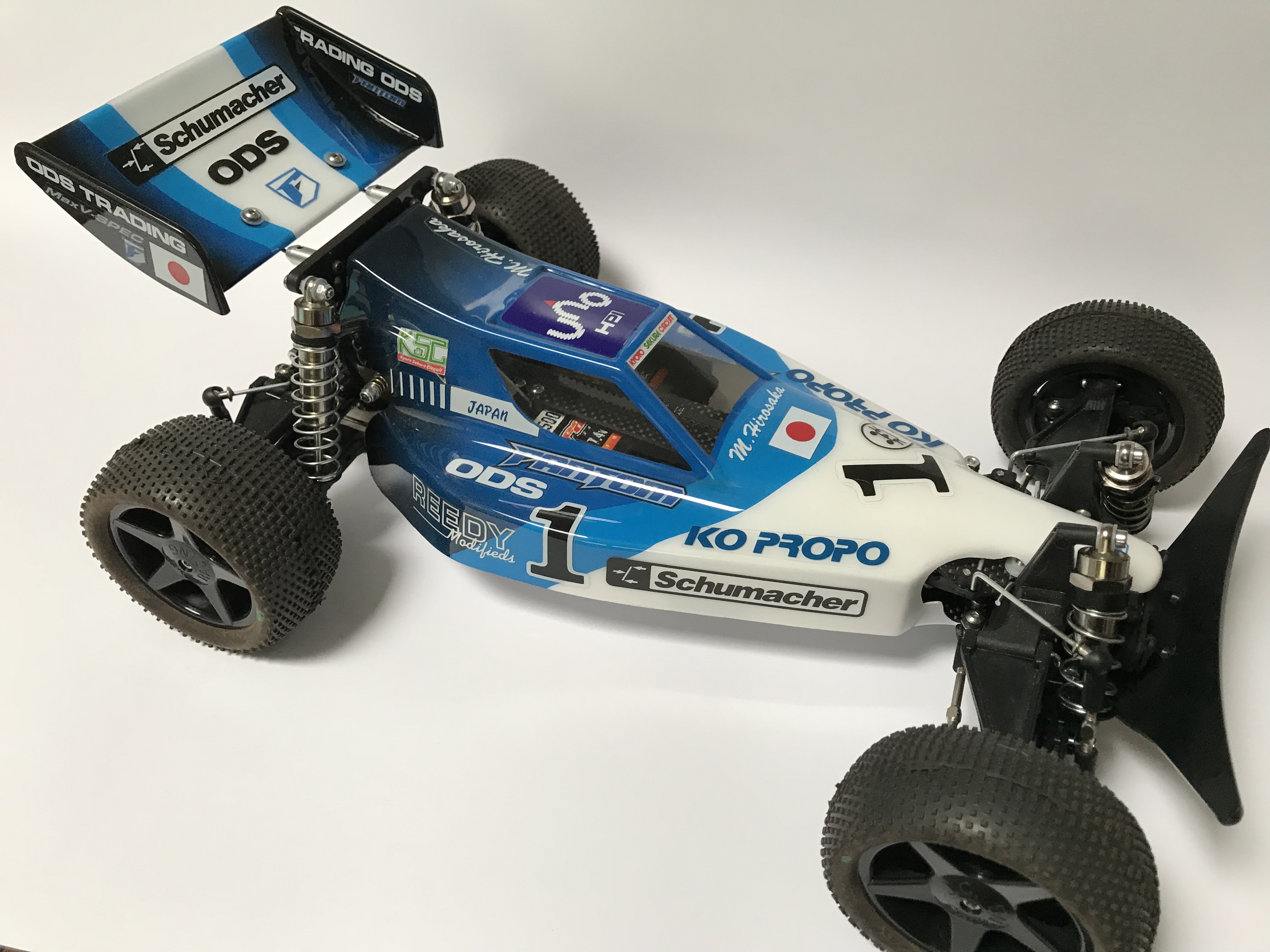

encountered some issues with missing parts. but was able to finished while waiting for parts.
exceptional support from Schumacher, sent them by accident the wrong address for the items. was sent another replacement parts with out cost..

Looks very good.

Nice color combination. Are you running the car? If so, then what battery and motor are you liking?

Hi there,
I am running a fleta 8.5 (Muchmore) with a 5000ma Fantom lipo.
This is my Masami replica using Tamiya PS6 & 7. Hope that helps regarding colours used.

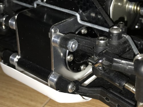

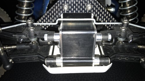

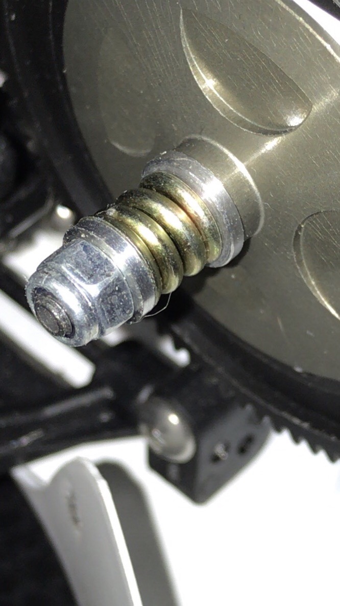

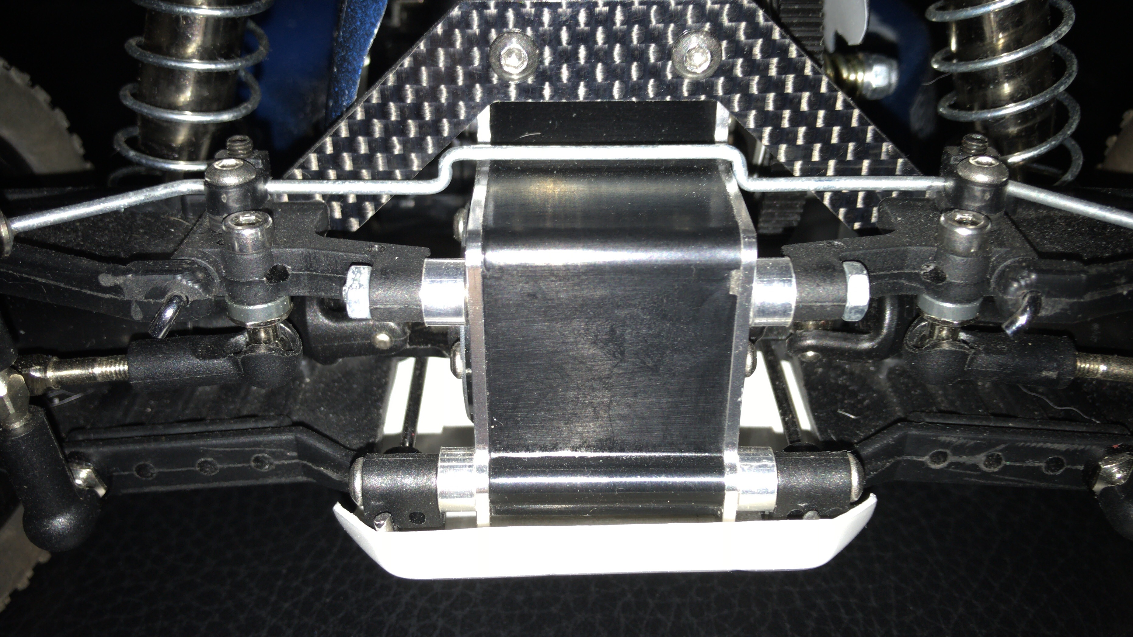

Just sharing some mods I have done for the CAT. I made some alloy spacers to replace the plastic ones for the suspension. I noticed that some of the CATs i had restored in the past the screws were bent. I assume this is through flex.....hopefully this mod would prevent this from happening.
I also made some stepped washers to centralized the spring and prevent it from wobbling about.

Nice upgrades uzzi. I see you've converted your CAT to hex hardware as well. Sweet! The back of your undertray appears to fit better than mine.
Not sure if the hole dimples were off or what happened but mine hangs-out on the left rear pivot mount. I'll probably just trim it and call it good
What are you running up front? I run the overdrive pulley (50t I think) and one-ways in place of the diff. I seems to tighten the car a bit on corner exit which suits my old-guy slow reflexes.

Thanks for the kind words XLR8, yes the dimples on the body shell are not accurate esp the ones near the rear. I line up the shell and marked it with a sharpie accordingly. Do the front first and use as the datum, then wherever the rest of the holes are is where I drill them.
The hex screws are from a company called Screwz4rc from the UK. They even provide the little ones for the eccentric bearing holder but you do have to drill them out as the little bolts are slightly bigger in diameter.
