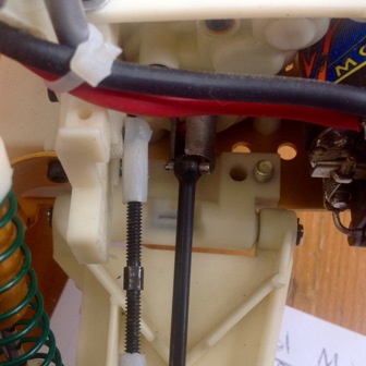

I installed these rerelease worlds CVAs on my championship edition and they appear to be a little short. During the first run it popped out like this. Does it look like they are not set up correctly? Are people successfully using the worlds CVAs on older RC10s.

Now that I can see your pic, yours is out a lot further than most that I see.

That pic is after it slipped out. It'll go back in the outdrive and drive for a bit. But is still too short and would come out again if driven for a few minutes around tight corners.
I have three shims on the inside and will try to add a few more to find the right fit.
I suppose I could add a fourth down limiter inside the shock to reduce droop.

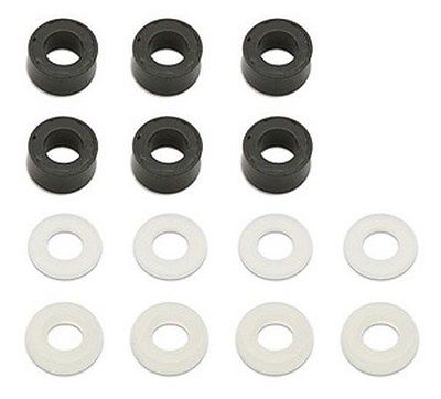

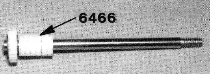

The shock down stops may very well help. When you say "add a 4th one", does that mean your down stop spacers are .032" thick? If so, there's a pack of thicker ones available. I'll come back in a few minutes and give you the part number...

Ok, Associated part number is 6466.

I'm using three of the thick shock downstops ASC 6466 in the rear shocks. They are built per the 1992 RC10 CE manual. They are likely the .125 (1/8") spacer but I'm not sure.
First, I'll try the b44.2 center bone ASC9911. I'll report back with pics of how they fit. Thanks for the advice
You can't see in the pic I posted, I'm using the rere worlds rear pin hub with the regular blue spacer between the pin and the hub/bearing.
