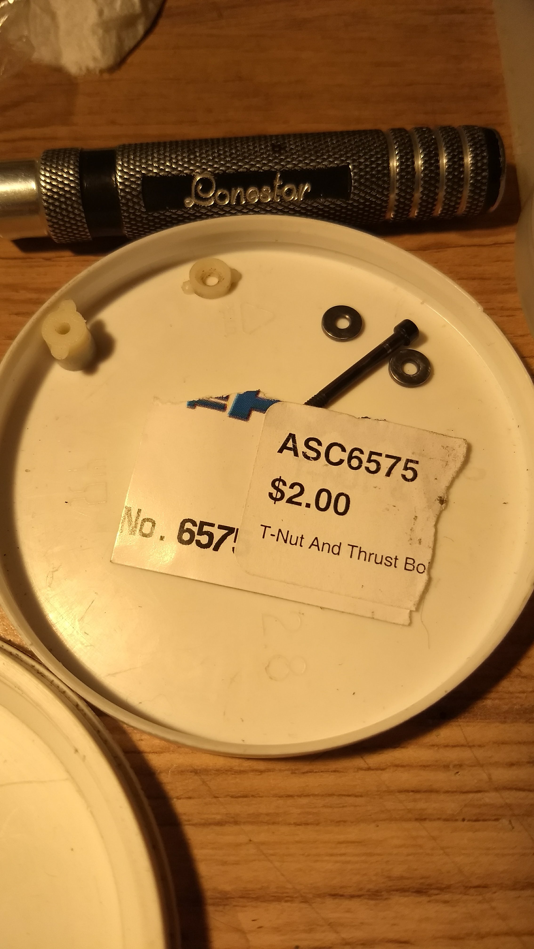

That'll set you back $30 :shock: Some of these prices have increased like crazy lately. Not only did 6575 used to include the T-nut + Thrust washers, but it was $2 not too long ago (vs. $13 today if you add 6575 and 6573's prices...). I mean, like a decade ago, not 25 years ago. See package I kept in stock, picture from yesterday's diff rebuild session:

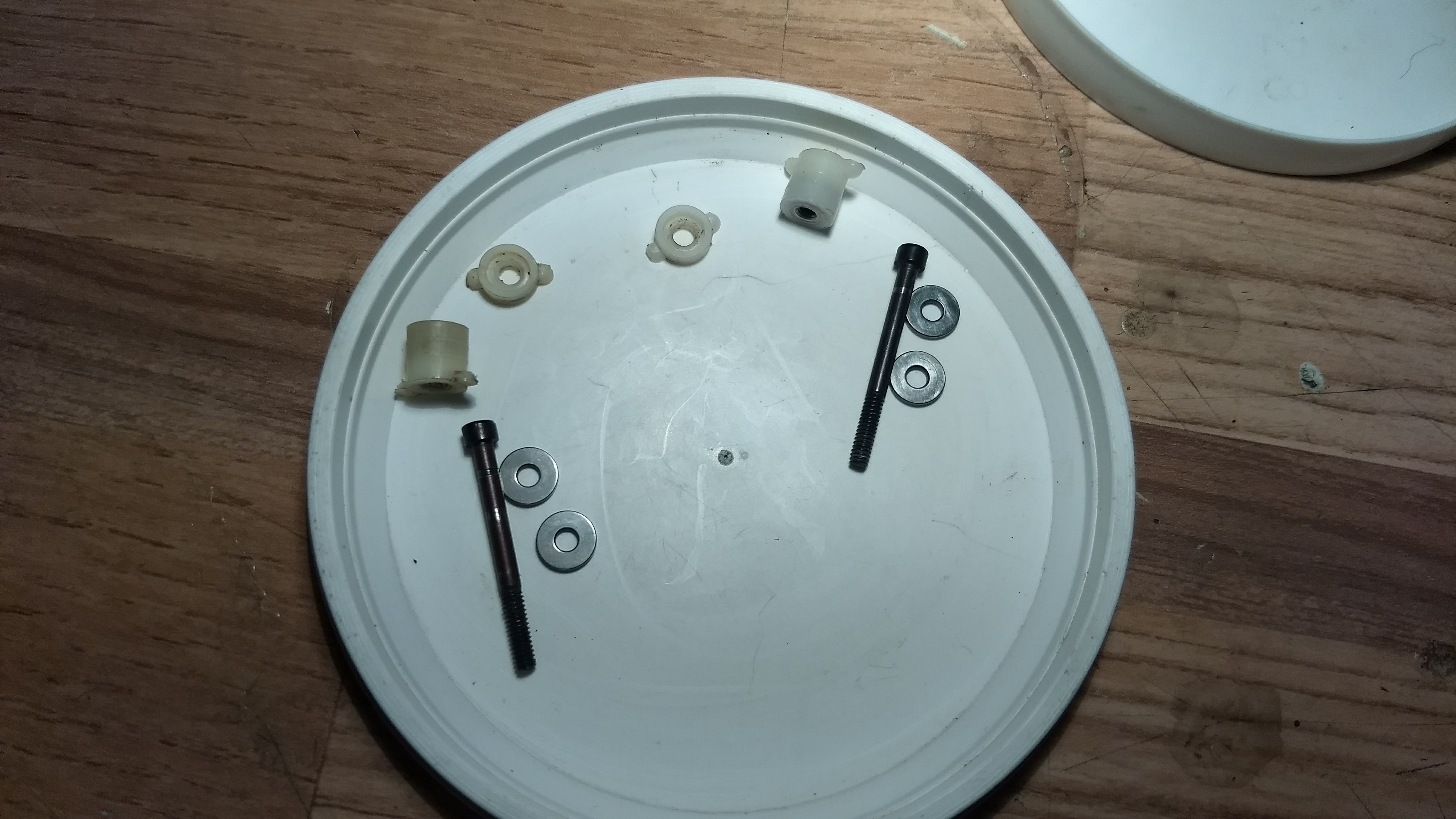

I have a few NIP MIP $2-a-pack 9151's at home... They are for the B4. Yesterday, I pulled out some used B4 diff parts I had, and proceeded to check whether they would fit in the original stealth outdrives. First, they look VERY similar (2.25:1 parts on left, 2.6:1 parts on right).
And the answer is: same part, fits like a glove.
Which means, one can tap into the more modern B4/SC10 diff parts supply to rebuild the original stealth diff :)
