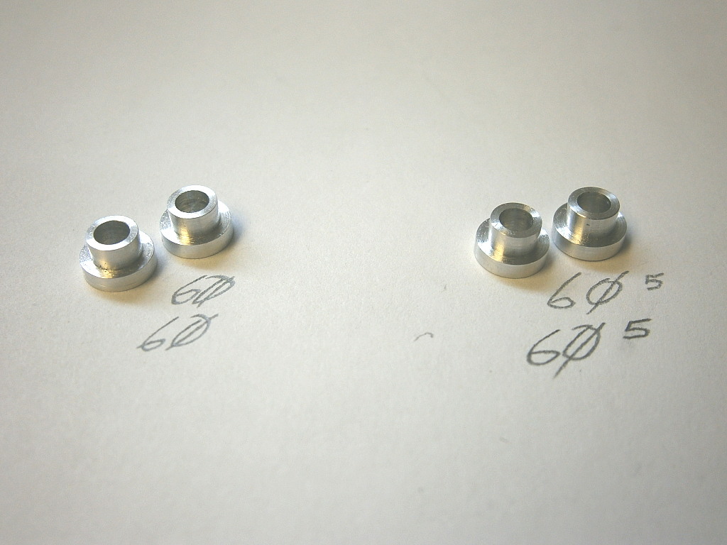

I get to the lathe this morning for some custom aluminum parts. I've turned a set (4ea) of Savox servo lug size washers. I hit my specs near perfect today, a good sign that I should make something else.

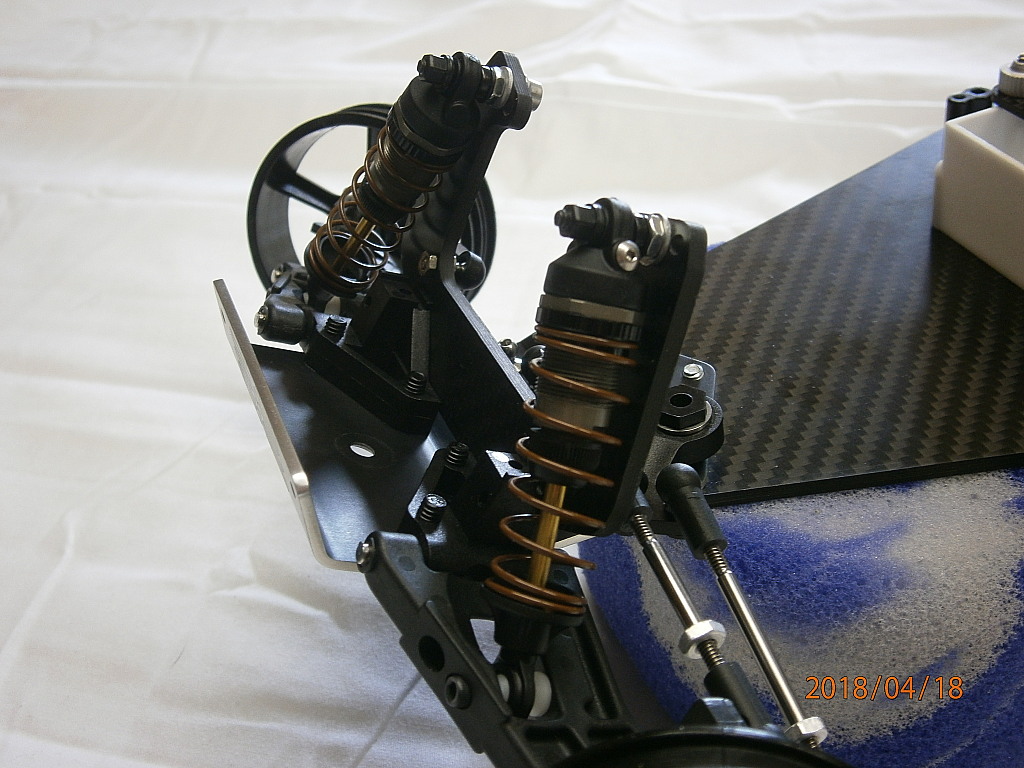

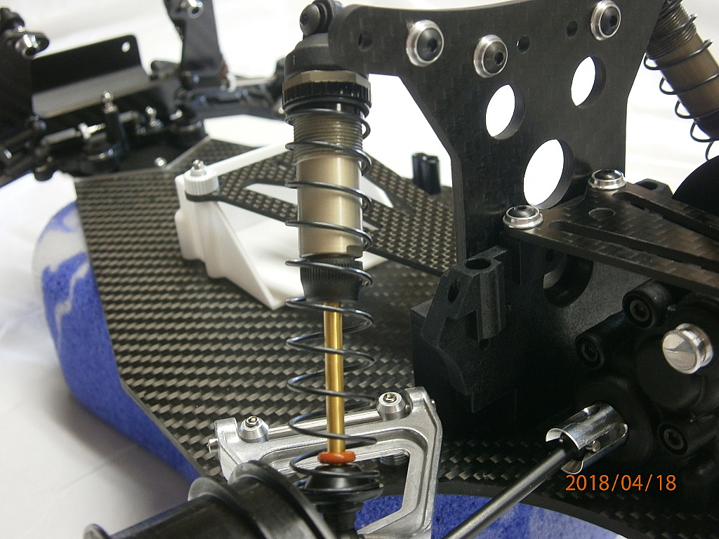

Shocks are done. I have 1.18" in the rear, .71 in the front. I used the gold shafts, because I like them. As you can see, I have good CVA to drive cup engagement in the rear, no down stops in the shock to get that with the 1.18" shocks! Due to the added thickness of the Factory Works front shock tower, I swapped out the 3/4" SHCS's with 7/8" long. I wasn't getting enough (for my taste) thread engagement with the nylon nuts. I've also made an adjustment at the rear shock tower for the same reason, 10mm vice 8mm on the shock mounting blocks. You can do, or not do that, it was my own preference.

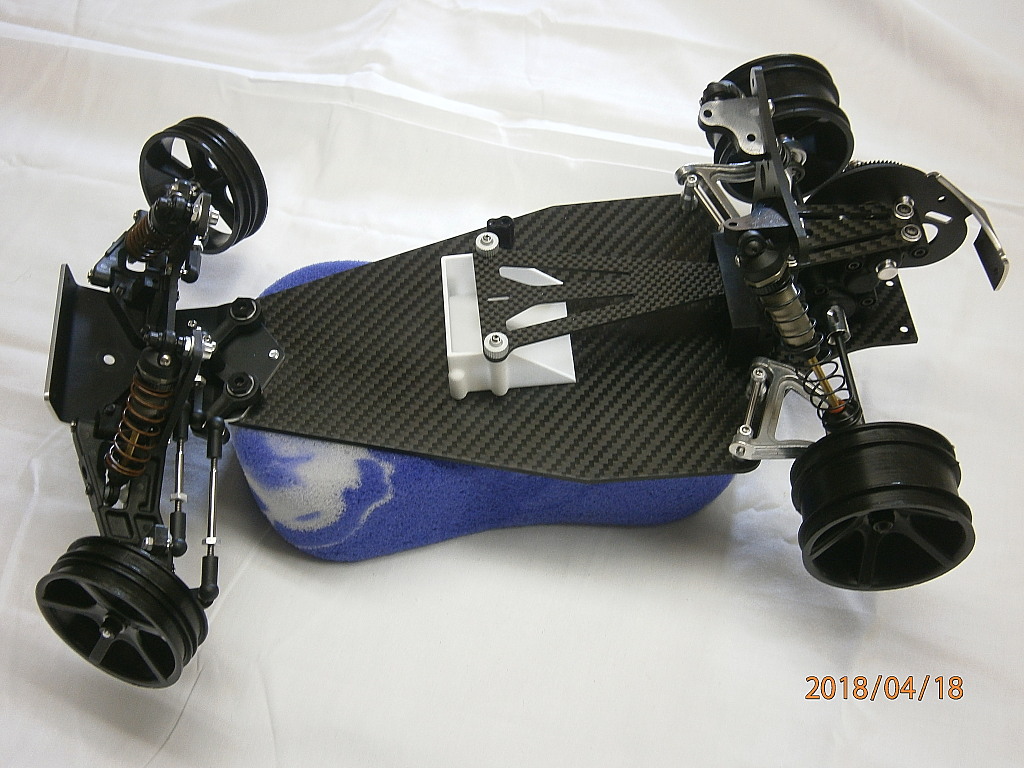

AN overhead pic, showing a single, CPD white "transverse" battery cup, Carbon Works CF battery strap. I stripped the blue ano from a pair of Associated thumbscrews. The battery cup will be dyed black.

Looking good Nomad. I wonder what those two unused holes in the rear top shock mount blocks are for? It looks like that entire rear top shock mounting assembly will ultimately reside inside the body shell. Is that how you see it?

Some strategic cutting around the the top shock mounting area of the body will be required.

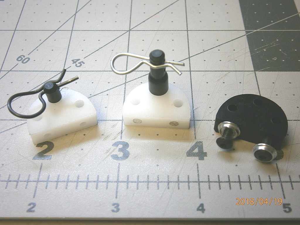

Here's a shot of the Factory Works rear body mount. On the left, as supplied in the kit (less clip). In the center, you can see a modified body post from a 1/12 scale on-road car. Lastly, on the right is my "standby", dyed black block, in case I need it.

Okay thanks. Actually, I was curious about the two holes in the shock mounting blocks.
Are these blocks also used somewhere else perhaps?
Anyway, the car is really coming together nicely.

I'm going to guess and say those holes are some how used in the machining process of the part.
