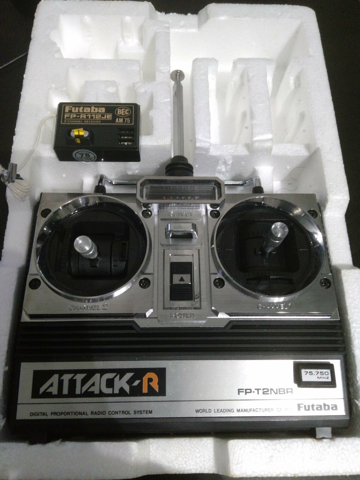

Running old school 75 MHz radio for this build.

I was surprised it wasn't easy to find a "How To" online. You would think the motor would come with something. My ESC came with a huge manual. I am using a Futaba Attack R, the same radio I had when I was a kid. Found one in mint condition.Timmahhh wrote: ↑Mon Mar 26, 2018 1:00 pmAhh, ok. In that case, the capacitors would probably be a good idea. Looks like the "how to" part is already covered pretty well above
