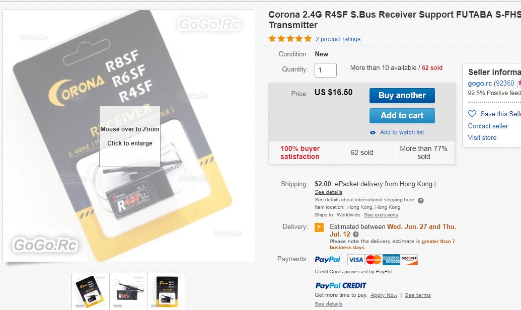

I agree completely, S148's are tough as nails.jwscab wrote: ↑Mon Jun 18, 2018 12:40 pm s148s are tough servos, it would be pretty hard for that to fail. I would suggest some entry level futaba servos, S3004, for 15 bucks, basic ball bearing servo, should be pretty bulletproof.
the futaba connectors should fit fine in the new radios(as long as they aren't 'G' exposed pins). You may or may not need to trim the small locator rib.
Hey Joe, I've been having good luck with these cheap Futaba knock-off Rx's but the instructions say they can't be used with analog servos. Any guess as to why they must be used with a digital servo?

not really sure. I do know some of the digital stuff uses higher resolution and can also change the pulse widths to be greater than a regular 45 degree throw(or, more precisely, 1.5mS, +- .5mS), so maybe the digital outputs (if a cheap model and not adjustable) can cause the servo to try and travel too far, making the signal out of the servo's nominal range causing damage?
I don't know what would happen if you fed an analog servo a greater than 2mS or less than 1mS pulsewidth, but suspect that might be what's going on.
EDIT** Looking at some web stuff for a few minutes, it seems to be related to the 'speed' setting of the receiver, it cautions that you need to set those to the 'slow' speed setting for analog servos. That makes sense as the analog servos are designed around 20mS pulse timing (50hz), they can operate somewhat faster, but if you go too fast they can't keep up and get confused leading to them reaching an end point and bind or buzz which will burn them out.

That makes sense. I recall reading in the manual for the Futaba 4PLS system about a high and low setting depending upon what type servo is to be used. The Corona instructions appear to sidestep this "high/low" setting option and just advise against using analog servos entirely. Maybe Corona was flooded with complaints (and warranty claims) for servo failures that were really the fault of the consumer not choosing the proper speed setting from the transmitter.
I may sacrifice a cheap analog servo with one of these Rx's (with the proper Tx speed setting of course) and see what happens. Thanks Joe!!
