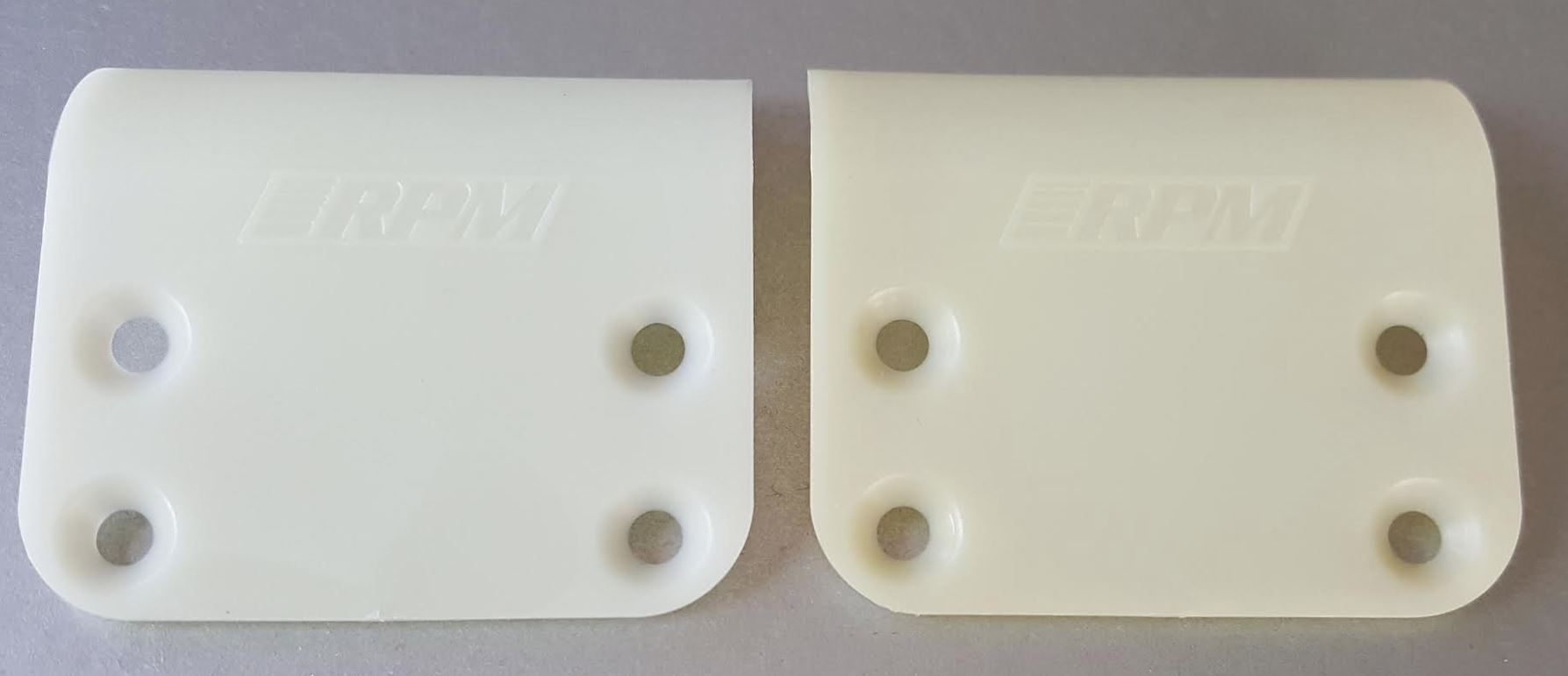

fst72vette wrote: Sun May 20, 2018 12:08 pm Its weird how these new parts yellowed over the years. I wonder if the plastic packaging or sunlight causes this .... makes you wonder ..... hmmmm
I have a feeling that the environment the parts are kept in have a great deal in determining how their color changes.

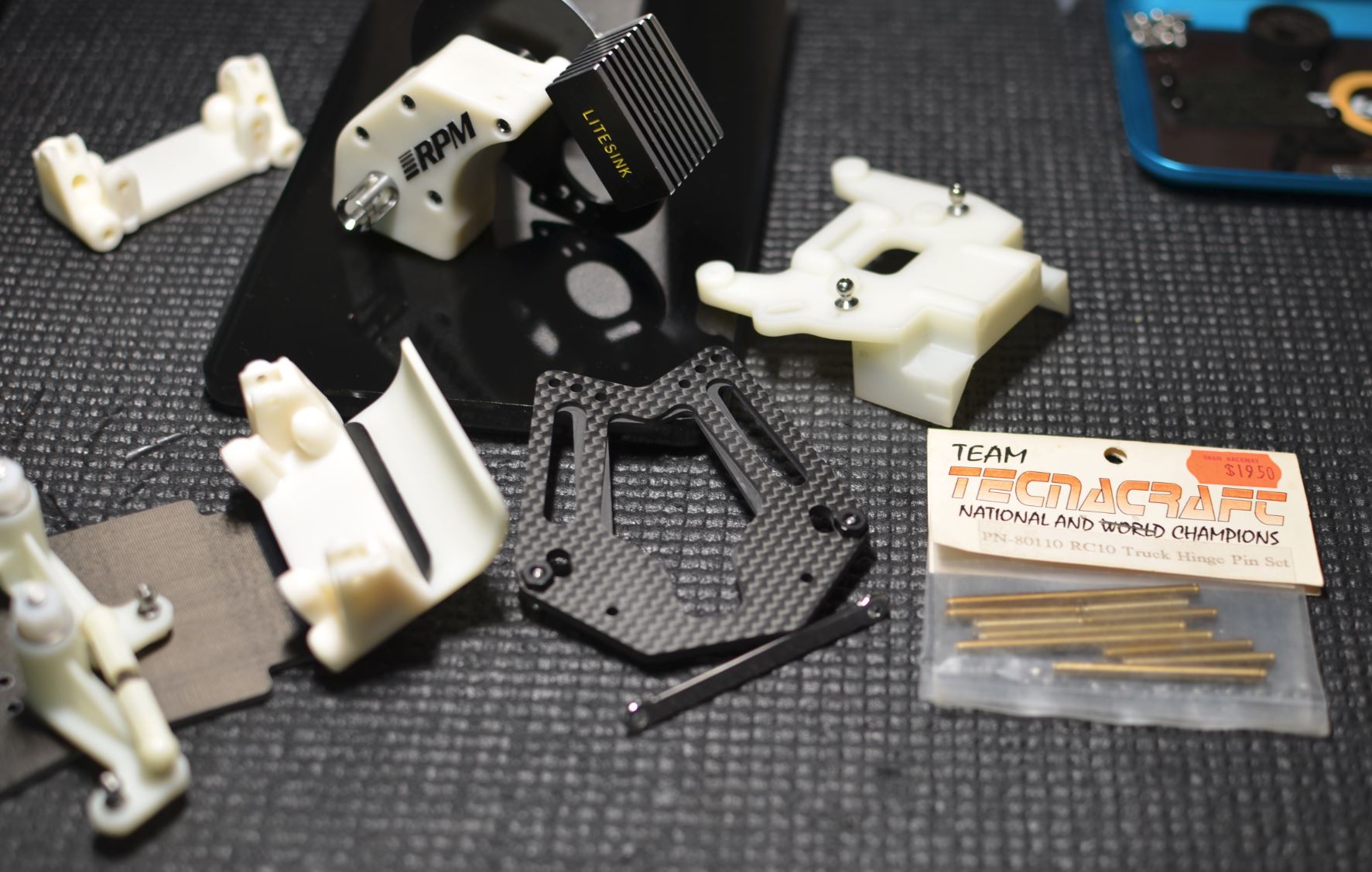

Update - I thoroughly and faithfully tried the Distilled H2O & Bleach technique today. It did not work for me. I cannot tell if the pieces are any better or possibly worse than before. The best I can tell is the bleach technique may have removed some green tint, but added some brown (pic below is comparison of test bumper after all my attempts). I tried 3 separate times, with new water/bleach & iced water each time. The parts began to looks worse to me. Plus, the process is quite nasty. I then boiled them in straight distilled water 2 more times to try and "clean" them out.
However, since I have stock pieces outside in a peroxide bath, I took a deep breath and dropped in my RPM transmission and front bumper. So far, no green, and the pieces are appearing to whiten. Crazy. I have had luck with peroxiding RPM parts before, but I have also had them turn green. Seems to be a bit of a crap shoot.

After trying the boil/bleach, lime/baking soda, and peroxide /boil methods on my white RPM pieces, they look worse than before I started. Pretty damn frustrating.

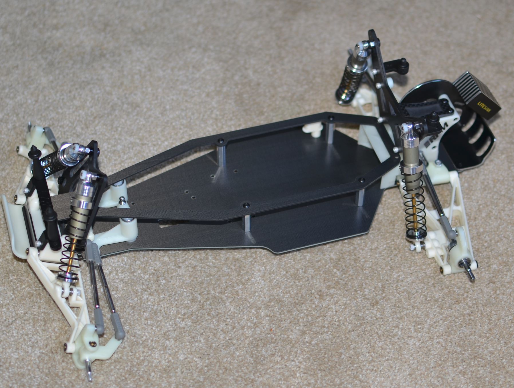

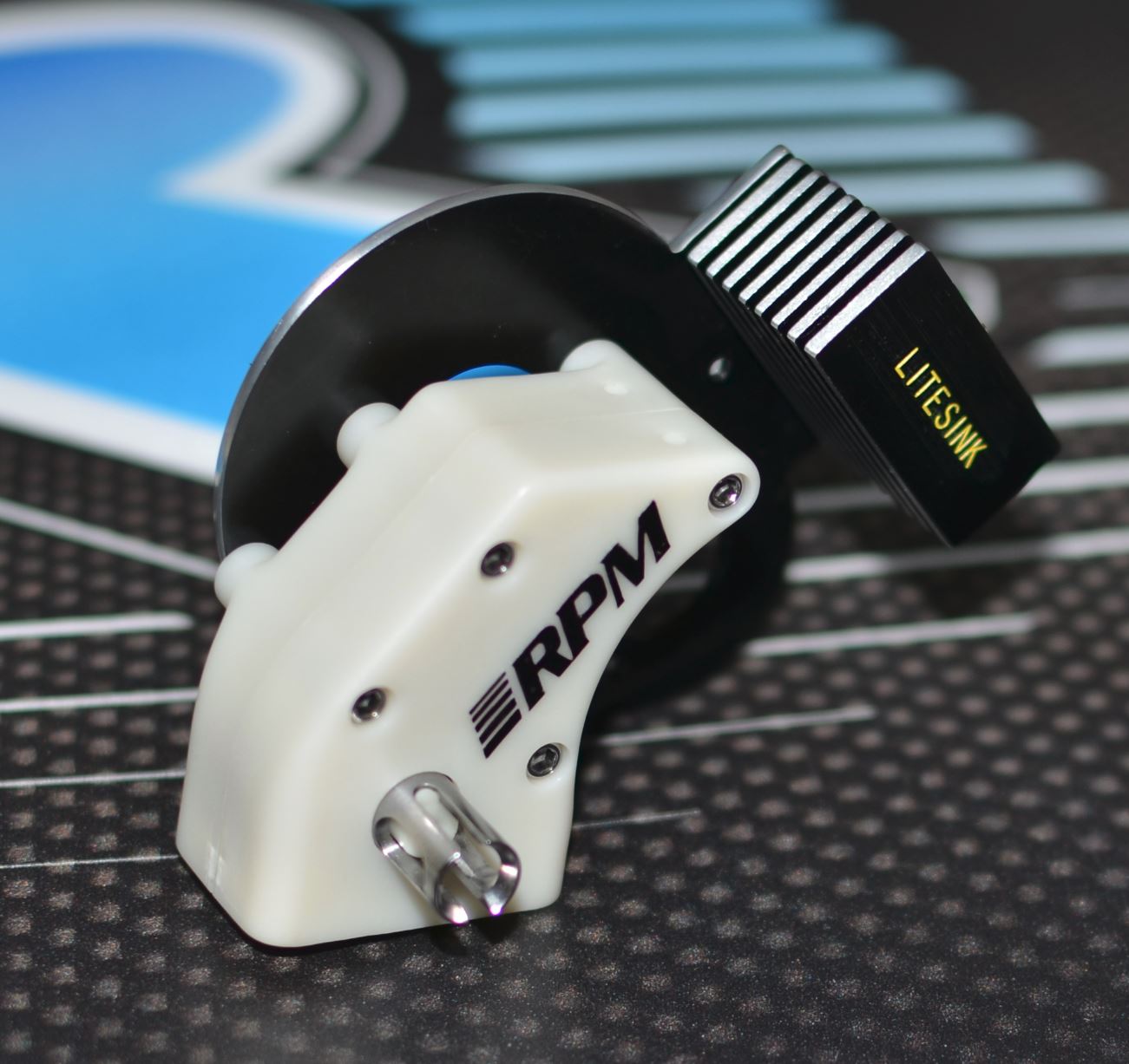

Still working to try and bring back some of the clear RPM pieces to at least their original brightness. In the mean time, I stole these rear RPM arm mounts from another build.
Here are a few progress shots. I was thinking of polishing the entire Litesink motor plate. However, I decided to smooth and polish the edges. I think is makes for a nice touch. It's more noticeable in person. MIP Litedrives have also been polished.

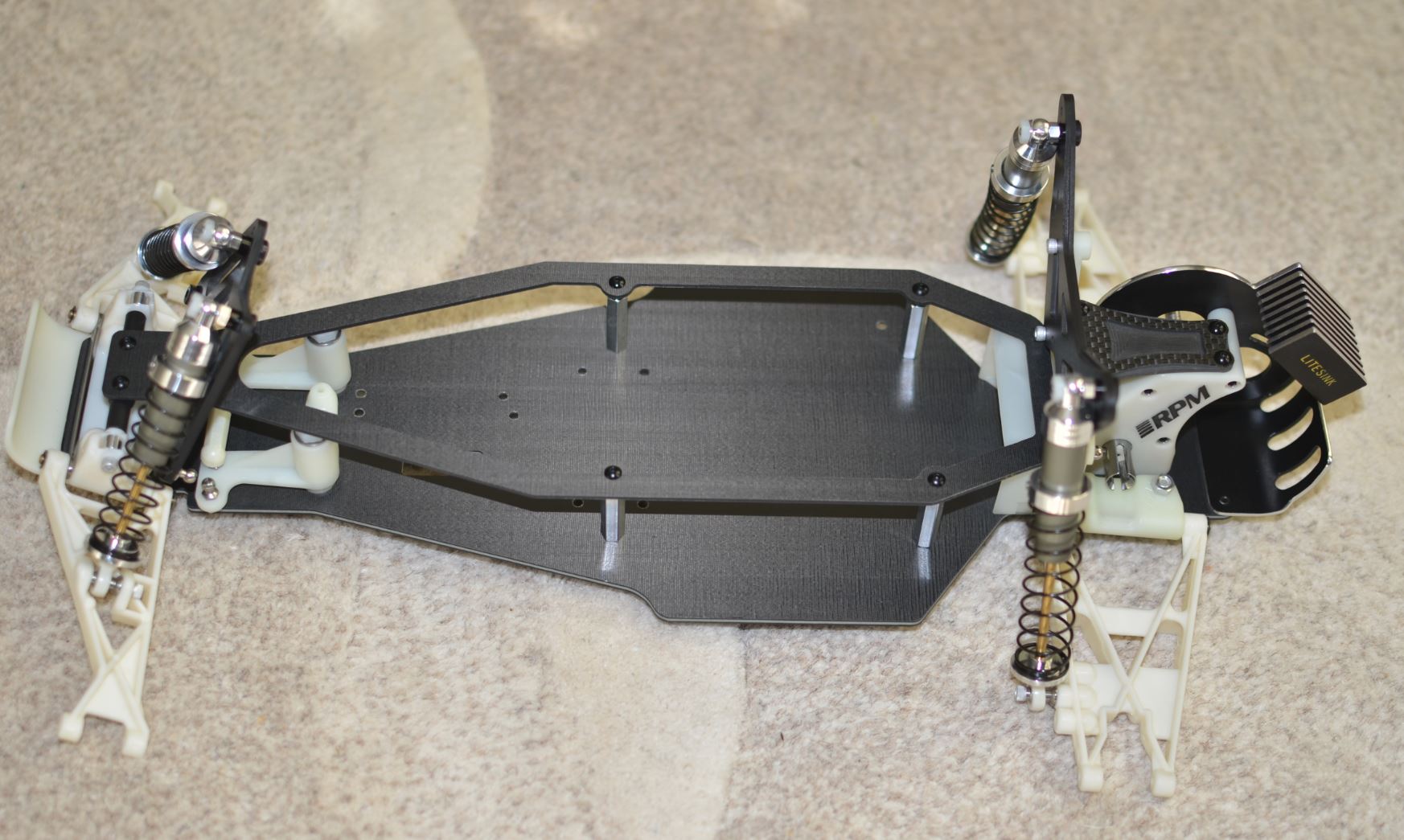

Some more progress pictures. Some people may not like the "modern" Jconcepts towers (and transmission brace yet to be installed) on a vintage build, but I think they fit the build great. I am a big fan of Jconcepts. The CF and details in their parts is second to none.
I spent a lot of time on the front aluminum arm brace. I sanded down the rough edges, and polished it. It's a small piece, but a nice touch. It's hard to show in pictures. I will be swapping out the black Composite Craft plastic front cross mount for an aluminum unit.

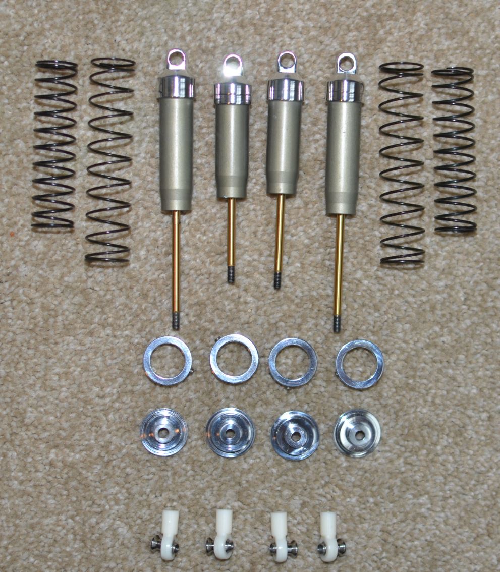

More progress. I ended up spending a lot of time on the shocks. I machined a set of hard anodized bodies, so the cap and body sit flush to another. I added gold TiN shafts. I'm also using aluminum spring retainers top and bottom. I even found set screws with small hard plastic ends, so they do not scratch the shock bodies. I may still make some changes to the shocks, but they are good for now.
I also did some machine work to the rear RPM aluminum motor guard. The pictures do not show it well. I also brought down the height to remove the 2 screw holes I will not be using. I polished both the guard and motor plate edges to a high shine.
Rear RPM hubs are here, as are the RPM 3.5mm rod ends to fit the large diameter 6-40 Technacraft TiRods.

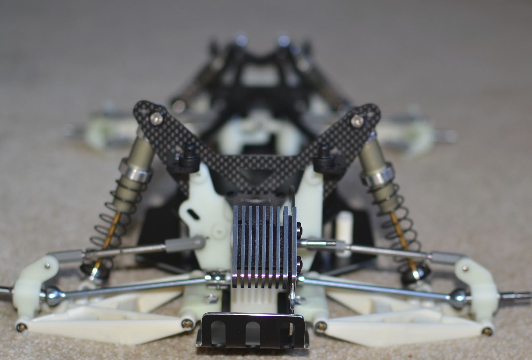

Post by Lavigna »
More progress pictures.

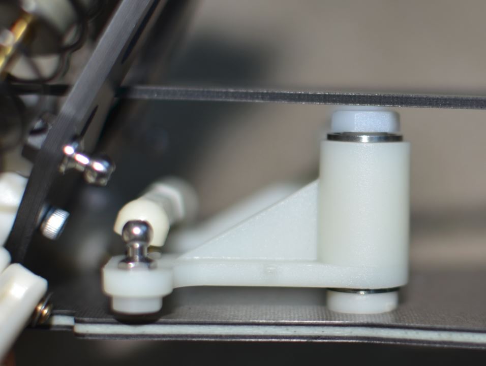

The clearance to the top of the RPM steering belcranks is very tight. This is after I machined down the 2 large vertical screws, and replaced the top nuts with thin versions. This top deck seems to sit a little higher than my other CC truck. It may have to do with the different front mount. I used a custom made aluminum piece on my other truck, and am temporarily using the stock CC plastic piece on this build.

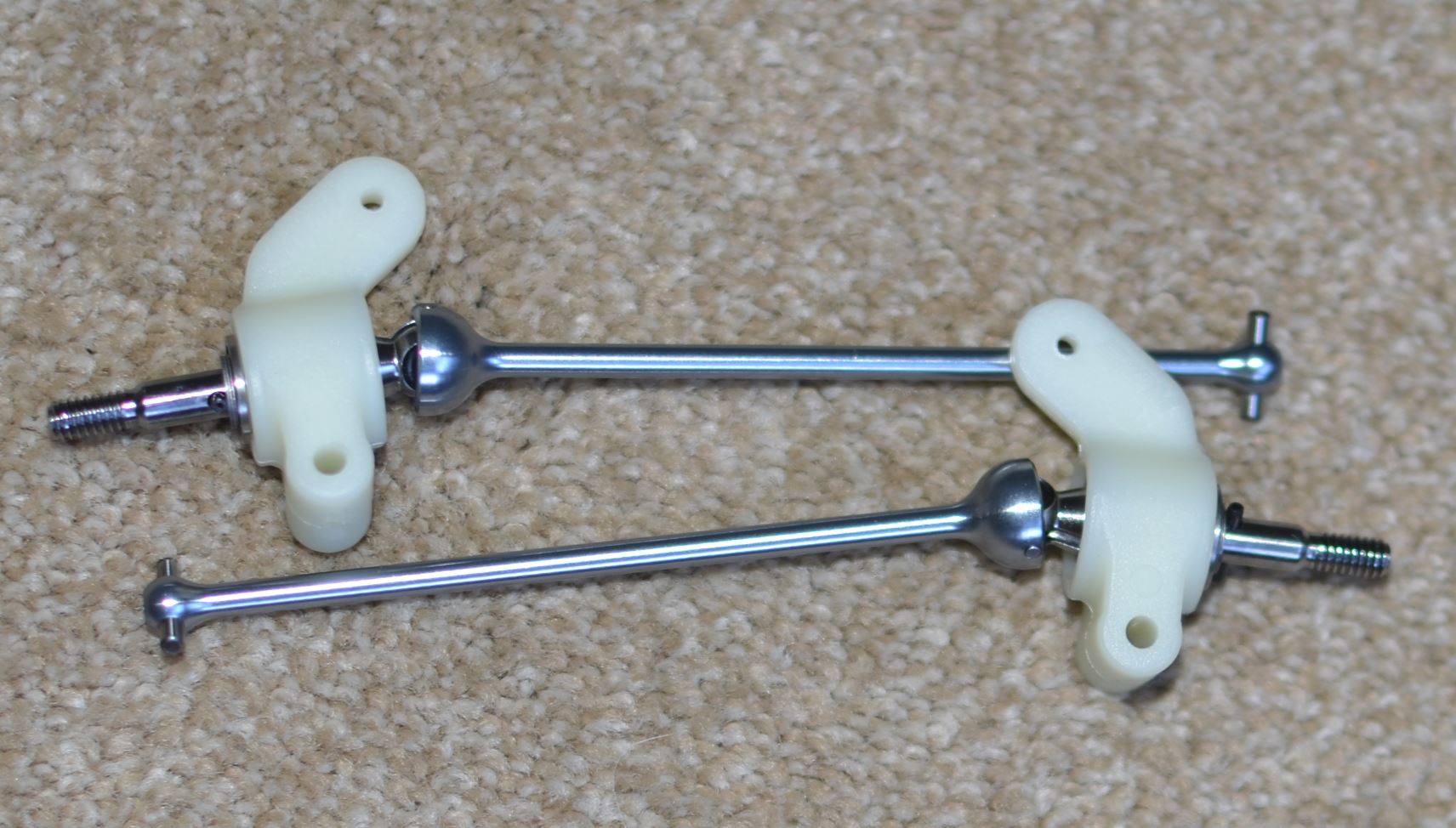

I polished the rear cvd axles. Couldn't resist. I have a NIP set of complete MIP aluminum CVD's that I wanted to keep sealed. I wanted to use the 2 NIP separate bones, combined with a loose (but still new) set of axles and pieces. However, I noticed the color of the finish on the drives in the full set is lighter and bluer than the individual pieces. I prefer this color, so I held my breath and opened the full set. Such nice pieces.
