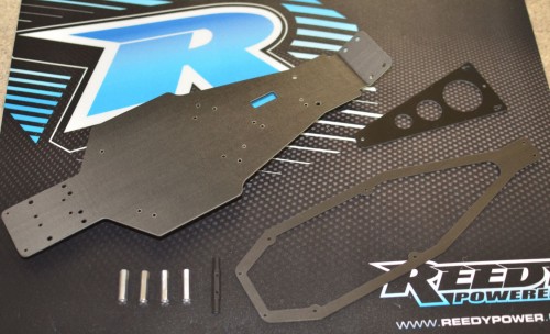

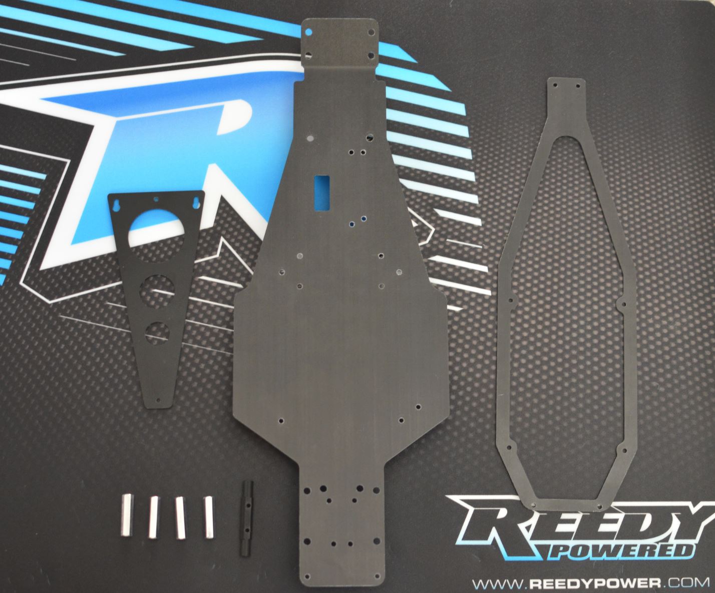

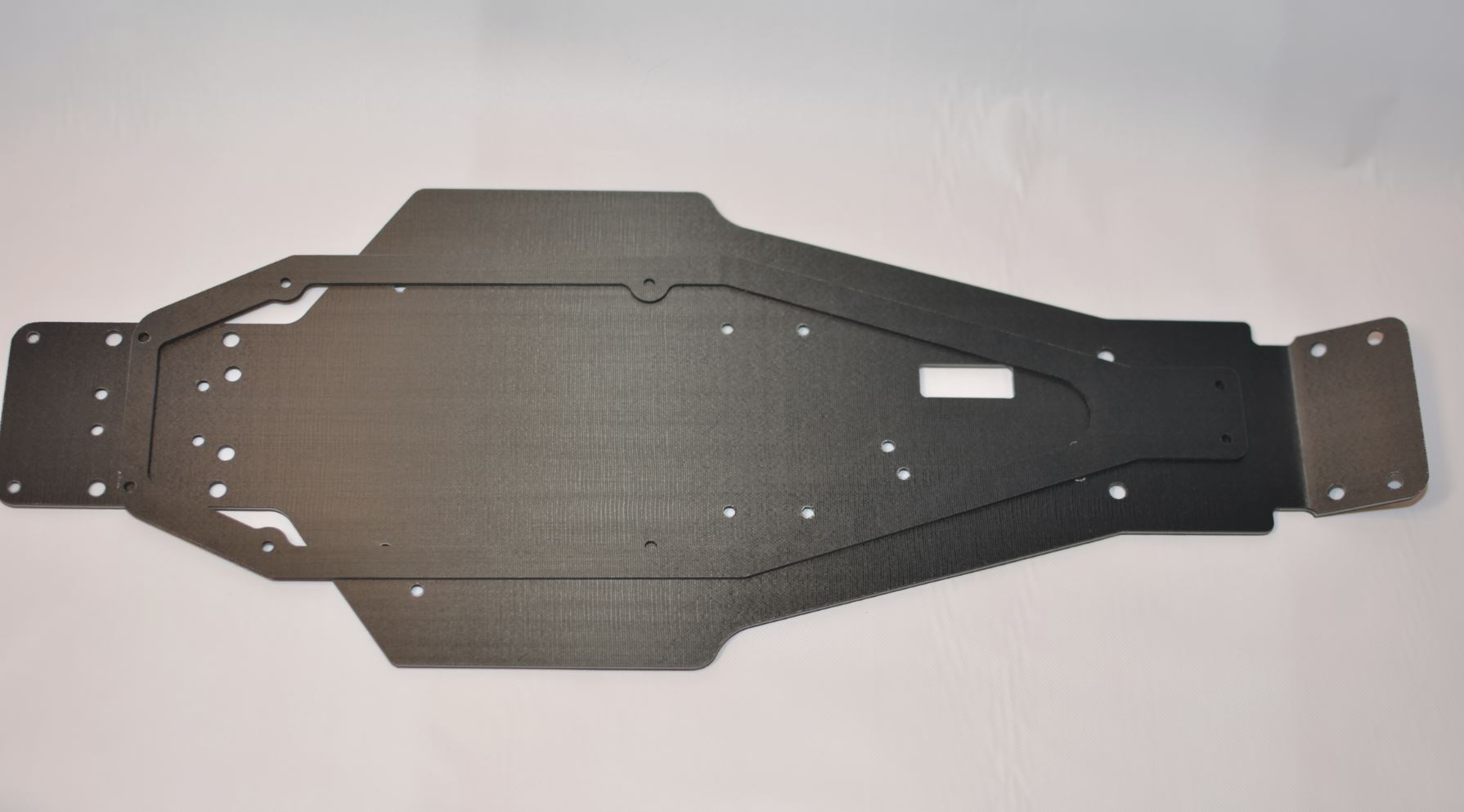

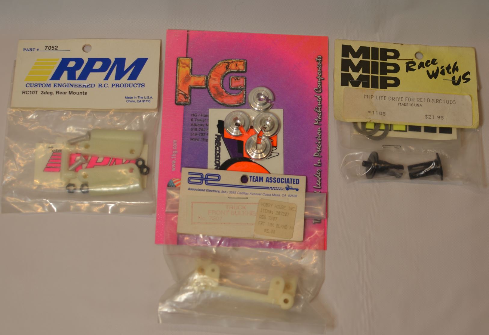

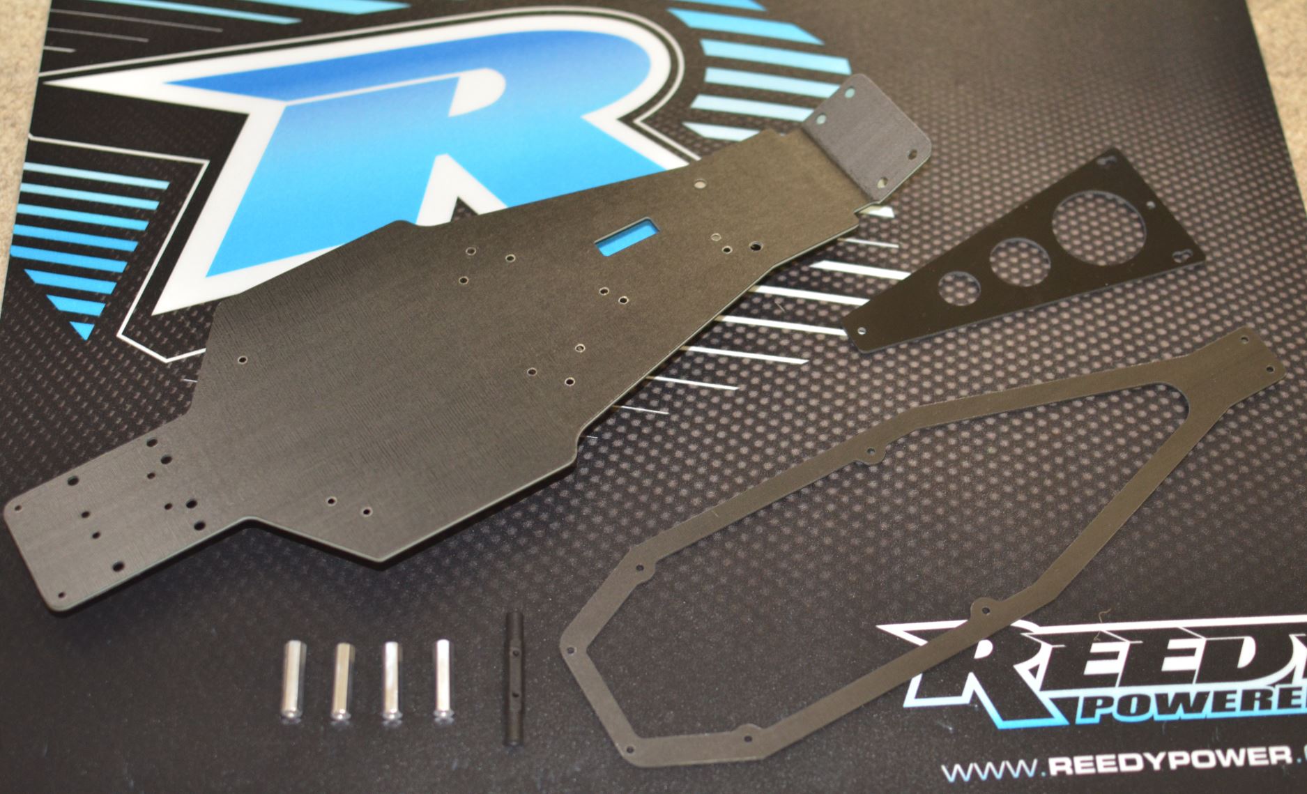

I still can't believe it! I was fortunate enough to acquire a second, new Composite Craft RC10T chassis.
My other CC RC10T build is one of the jewels of my RC collection. I built it with a murdered out (black) theme, and I love it. For this second chassis, I figure I should go in the opposite direction. White Knight style.

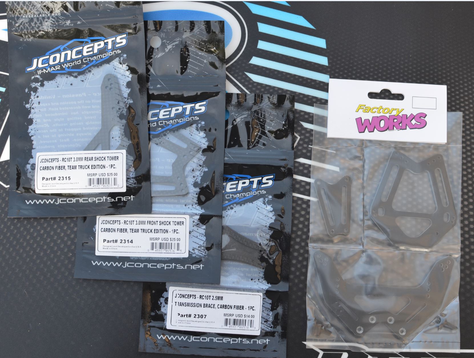

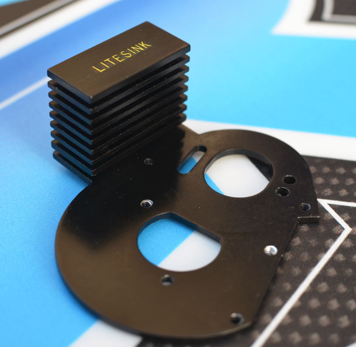

For the last few years I have been hunting down RC10T parts which I had intended on using on a (modified) Cliff Lett themed build, but that will need to be put on hold now, lol. I am not sure which direction to go on a few areas, like stock vs RPM transmission, shock towers, motor plate, and shocks. Decisions, decisions...
Here are some pictures of the chassis, and some of the parts that may or may not be going into it. Suggestions are always welcome. Thanks for reading.

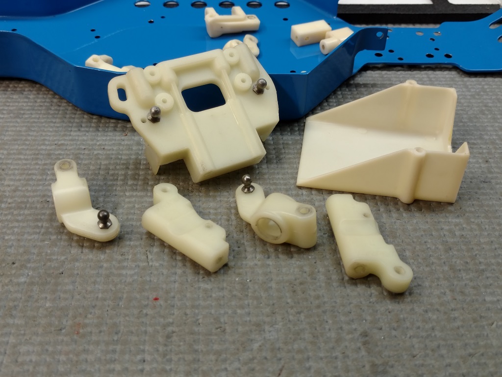

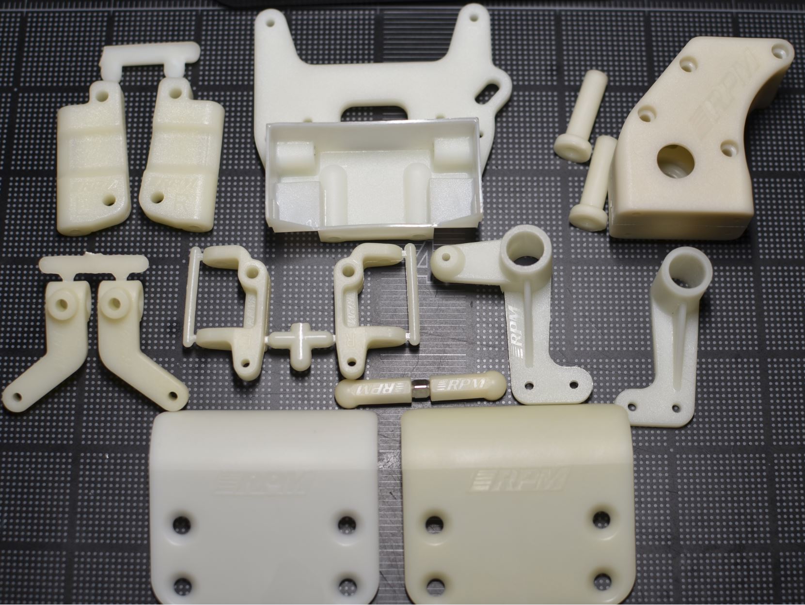

Even though the RPM parts are new, some of them have yellowed. Does anyone have any suggestions for whitening RPM parts? I know peroxide is a big NO NO for them. If anyone has any proven techniques, please let me know. Thanks!

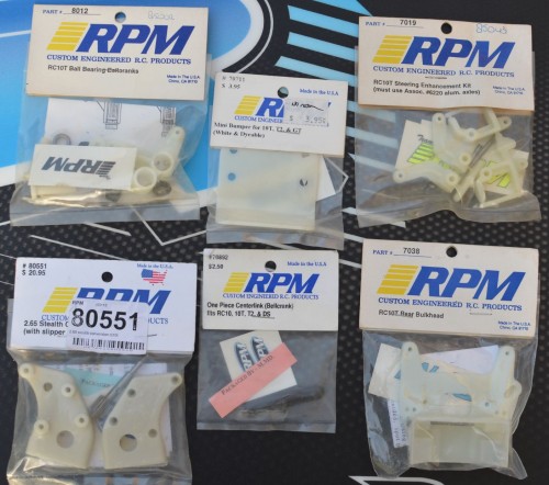

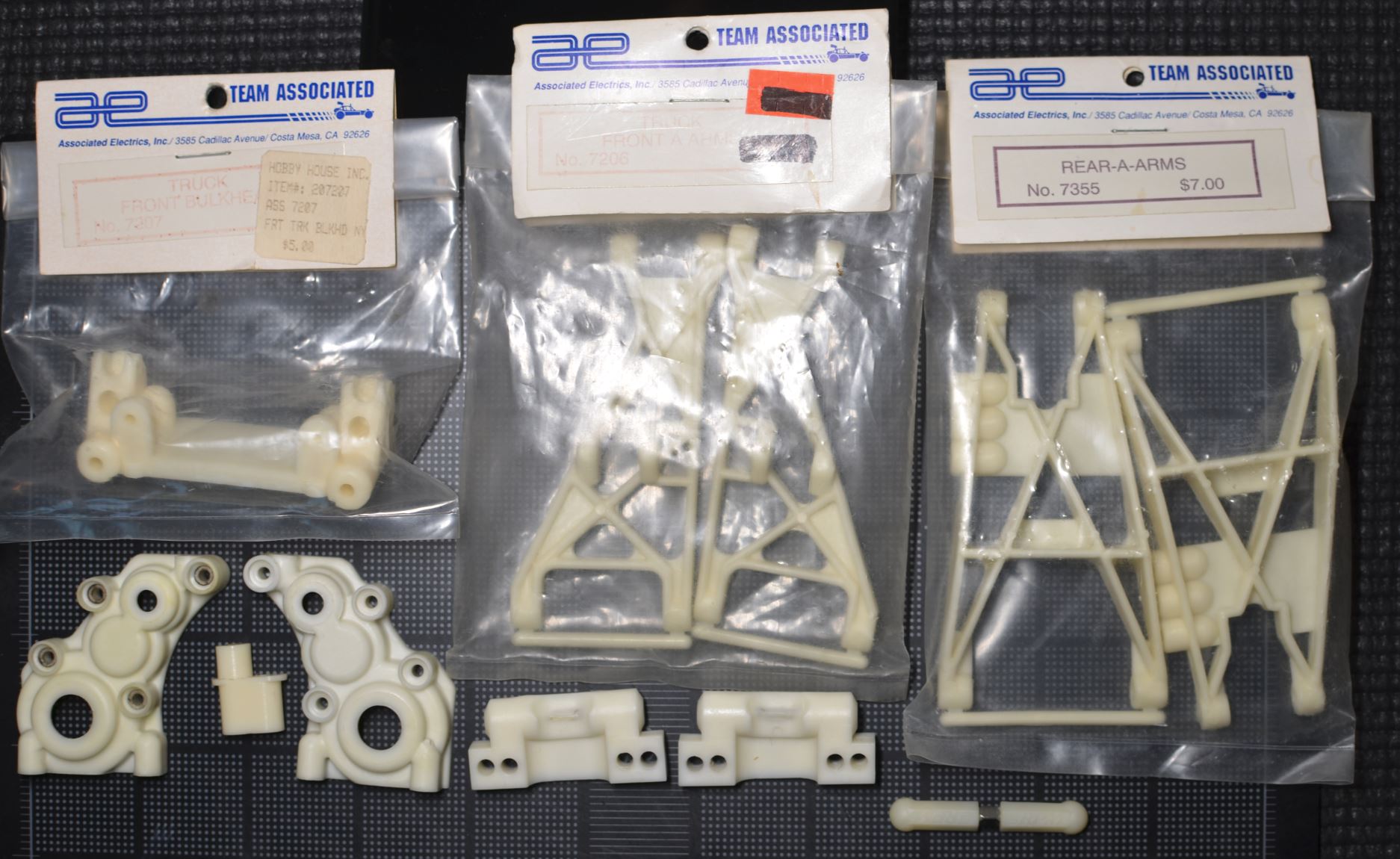

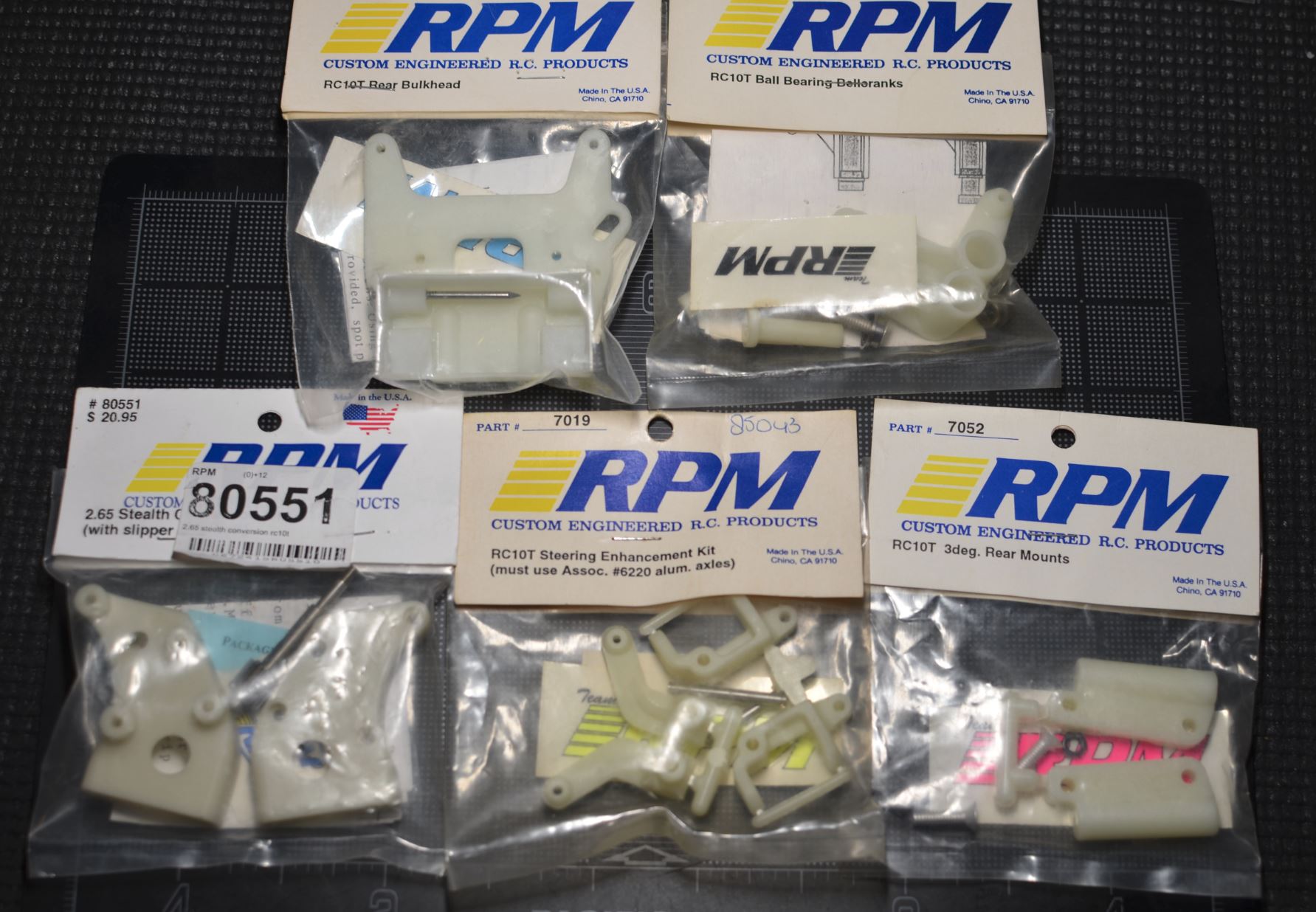

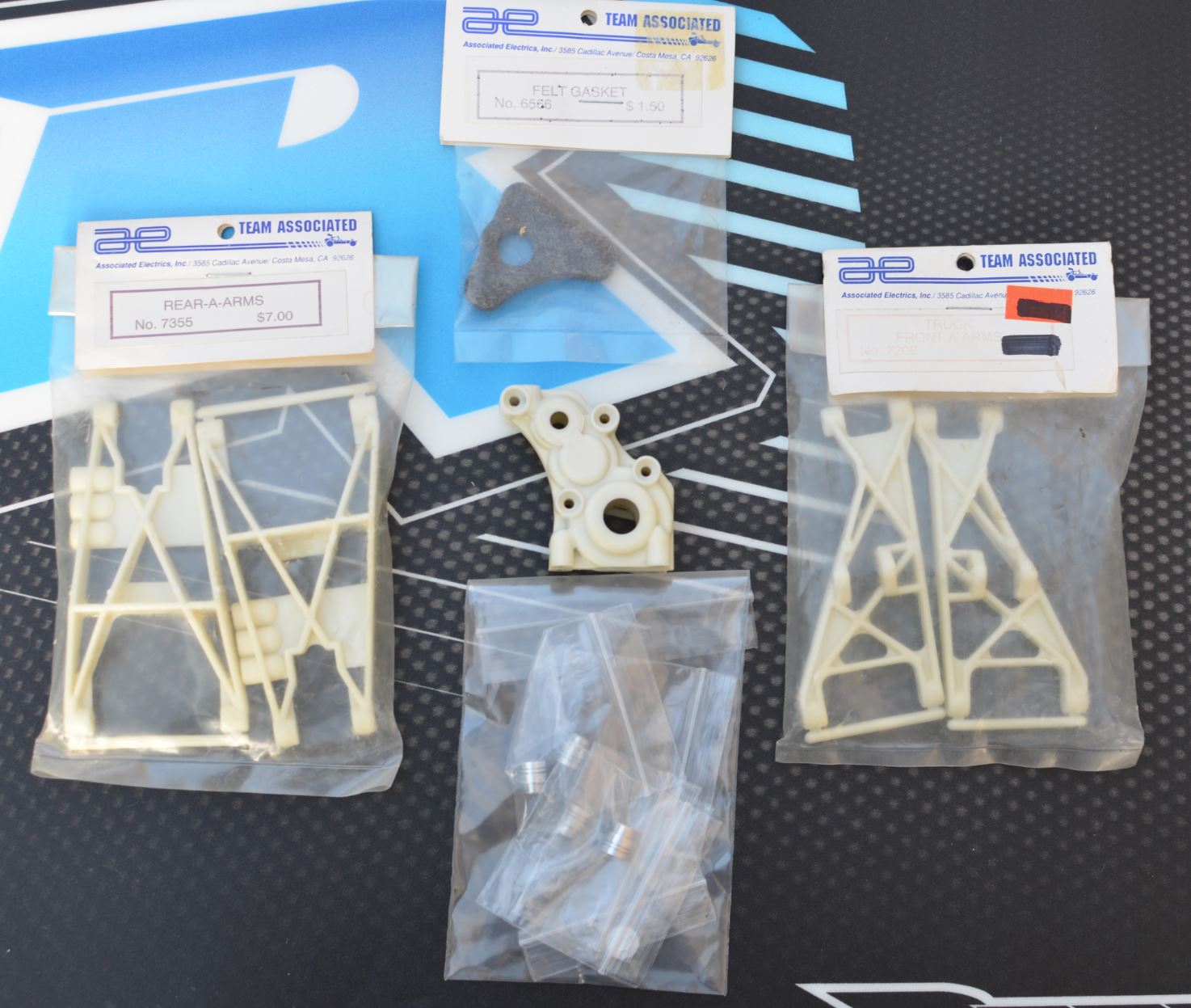

The parts collecting continues. Thanks to SofaKing for most of these latest choice items.
I need to begin my parts whitening campaign, and build the courage to open the vintage packages of Unicorn white pieces. Stock pieces will take a quick Peroxide bath, followed by some thorough cleaning in boiling water.

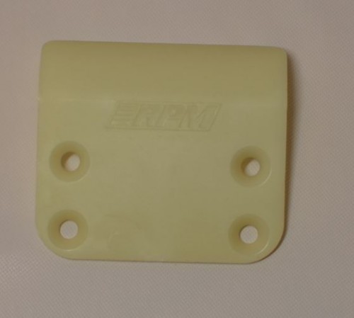

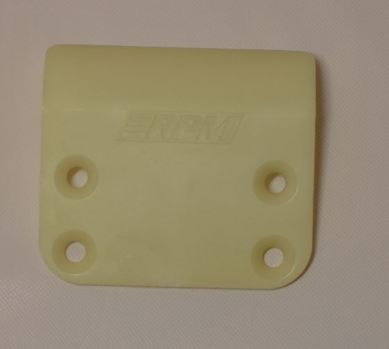

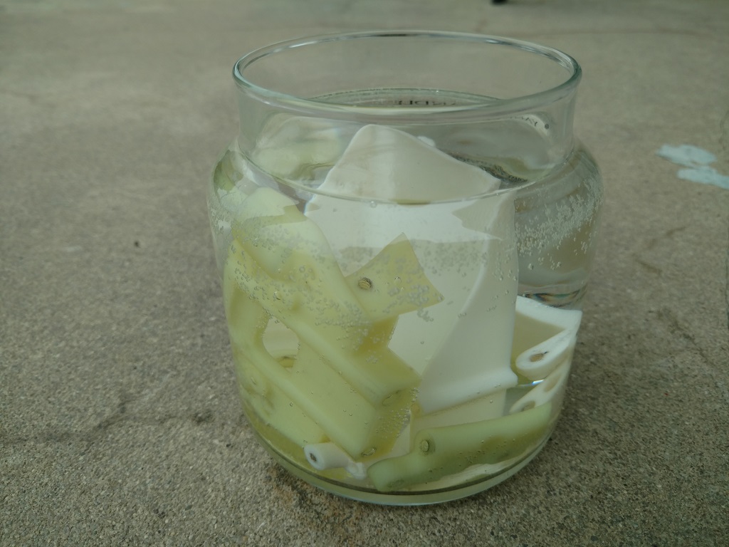

RPM White pieces - Although new, most of my RPM white parts could use some whitening. I have a loose front bumper (it's much more yellowed than my other NIP bumper) that I used as my tester. I followed the directions of LTO_Dave. I did NOT use distilled water, as I didn't have any at the time. My mixture of bleach was also probably low, as I was using my inside stove. My results were minimal (pictured below). I do think the piece whitened up, but it is still far from where I want it to be. I also let it soak in Simple Green, to see if that would help. I think the Simple Green actually turned it slightly green, shocking lol. This weekend, I am going to try again with distilled water, a true 25% bleach mix, and my outside barbecue.
Although this truck will have nearly all the Unicorn RPM pieces, I am going to use stock arms. I have always preferred the look/shape of them over the RPM units, especially in the white color.

I just did a batch of old RPM stuff. Put the parts in peroxide with AE parts and just let them turn their wonderful color. Took them right from the peroxide to a pot of boiling water. Wonderful color left right away and this is what i ended up with.
That being said, use at your own risk.

Awhile back I accidentally peroxided a white RPM part. It turned green. I had heard that boiling it would help remove the green. It did, but not completely. This is why I am resistant to try this method.
I bought what is needed to try the distilled H2O & bleach method tomorrow, with correct ratios. I am hoping it helps. In the least, I know it will not harm the pieces.
Some of the RPM parts are already a nice clear white, and do not need any whitening, like the bulkhead, steering rack, and front bumper (left). The other RPM pieces are not drastically darker, but I am hoping I can brighten them to match the others.
