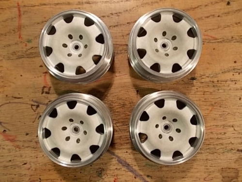

Will these wheels fit a Mid or an early Lazer? They are 12mm hex drive and back spacing is 27mm (1-1/16" as measured from base of hex socket to rim of wheel) and total width is 38.2mm (~1.5"). I think I received these by mistake; they arrived a big box of stuff that I ordered from someone a while back. Anyone know the hex size and back spacing of the stock Kyosho wheels? Thanks!

The problem with modern wheels is they're all "high positive offset" backspacing. There's no depth to the wheels, all the wheel width goes inwards. The wheels will possibly be obstructed by the shocks or body, at least with an Optima Mid. The only way to tell is to mount one. The wheels back in the day had a more neutral offset, with equal width on either side of the wheel centers.

Thanks Coelacanth, I was afraid that might be the case. I've held one of these cars in my hands but that was decades ago and I don't recall how much the wheels are offset and it's difficult to see this in photos. Anyway, I'm shopping for a Mid or Lazer to make a runner so I'll want a wheel that will hold a modern 2.0 or 2.2 tire. Of course, if it were a shelfer, I would have a set of these; I think they are awesome wheels. I believe they are 1.9's. Thanks again for your very helpful post.Coelacanth wrote: ↑Mon Nov 27, 2017 1:42 pm The problem with modern wheels is they're all "high positive offset" backspacing. There's no depth to the wheels, all the wheel width goes inwards. The wheels will possibly be obstructed by the shocks or body, at least with an Optima Mid. The only way to tell is to mount one. The wheels back in the day had a more neutral offset, with equal width on either side of the wheel centers.

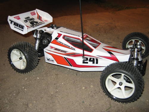

Thanks Welshy. Are these the wheels you've referenced? If not, do you know anything about these?

Vintage HPI 5-Star wheels would work, I have a set of those that fit a regular Optima.

Trish at TBG has confirmed today that the wheels on the TOMS in the photo from this post are "hpi super rs4 superstar wheels". That's a lota "super".
