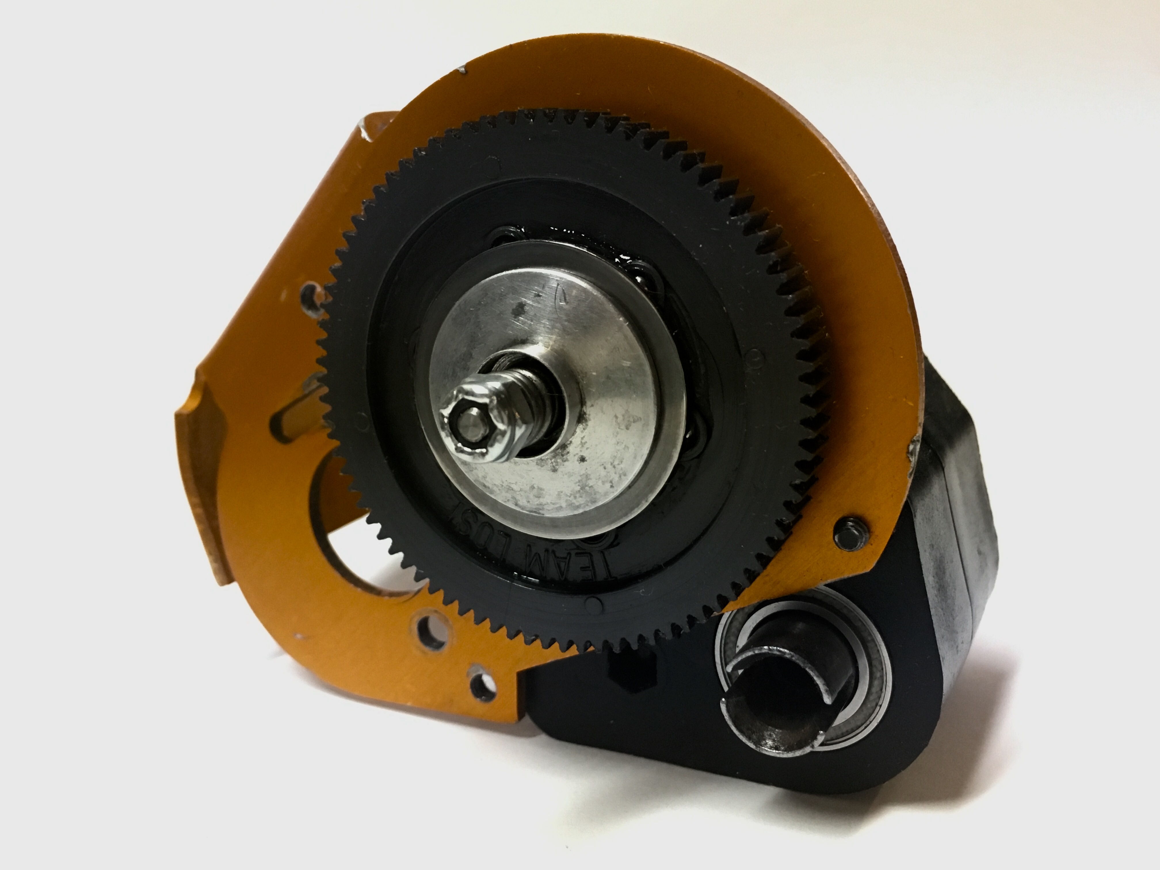

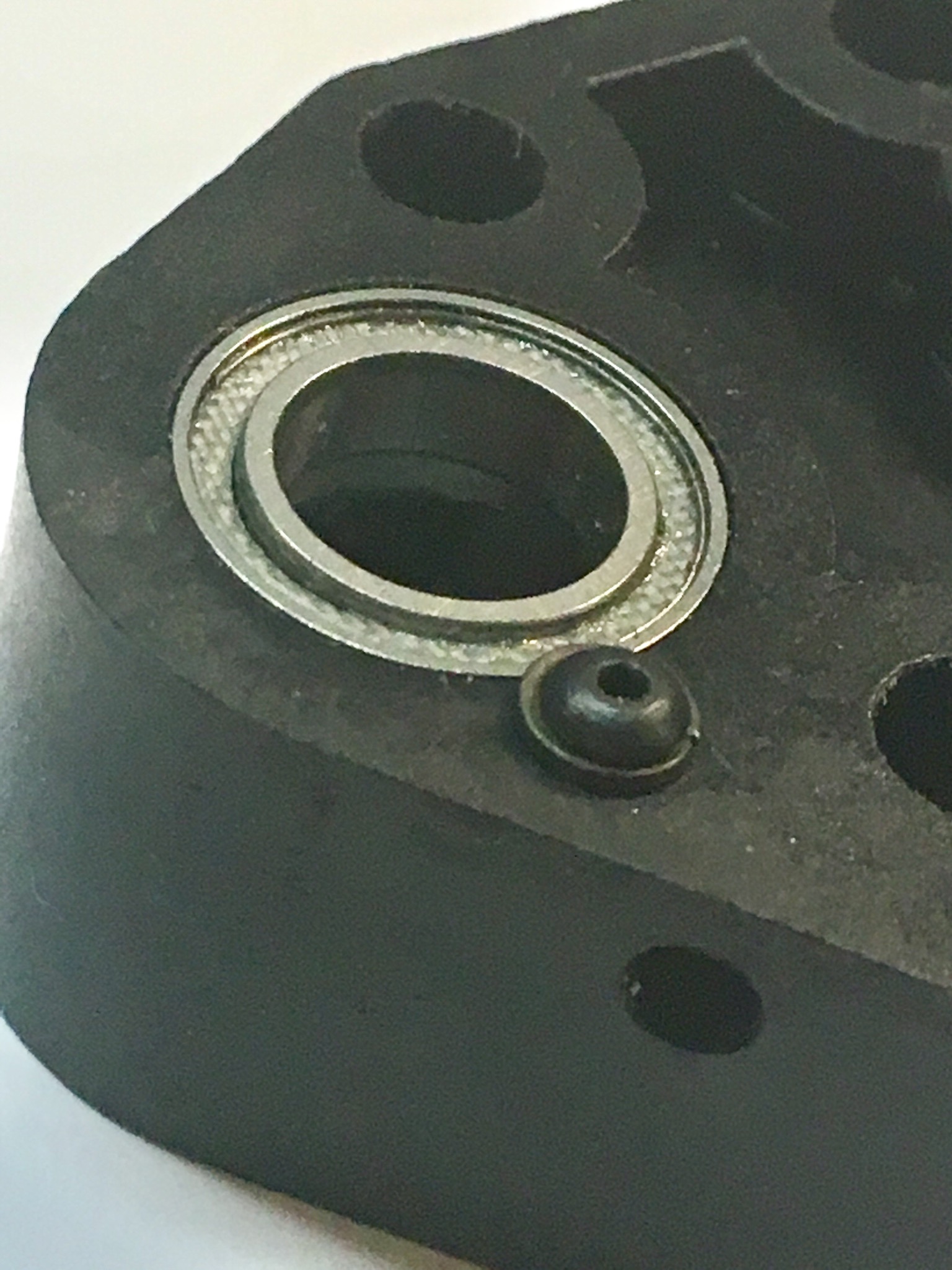

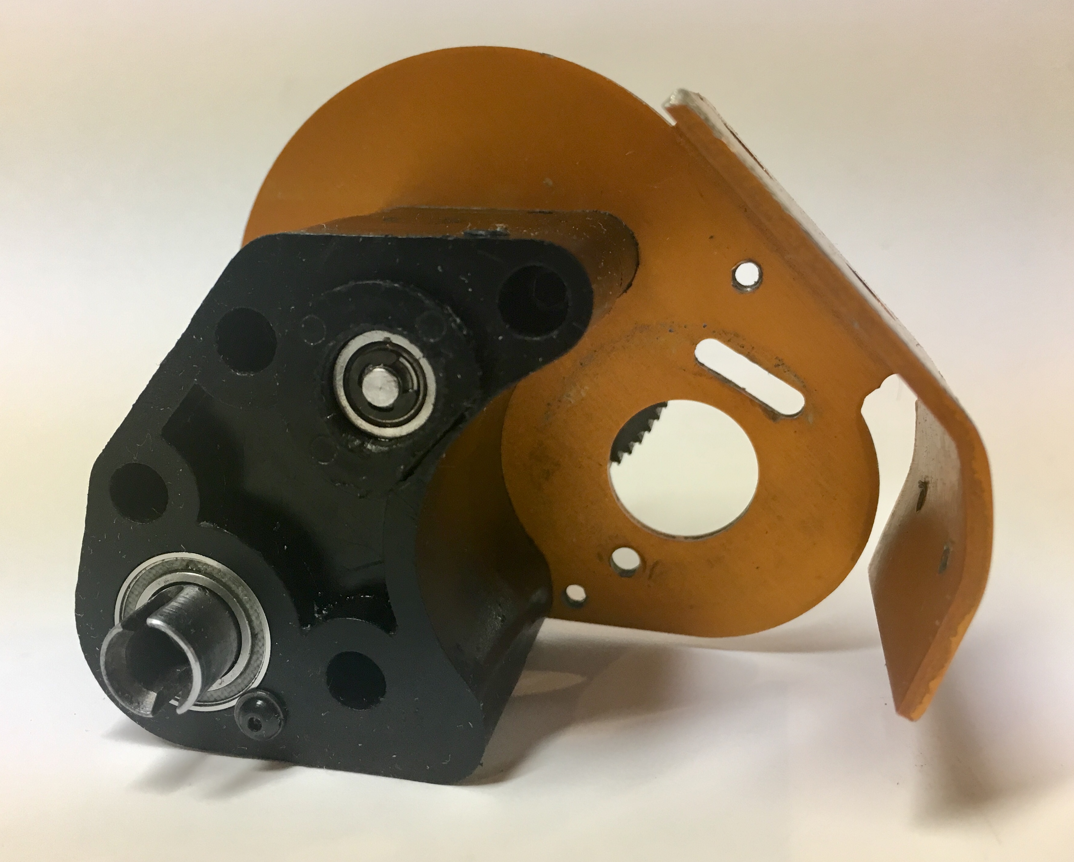

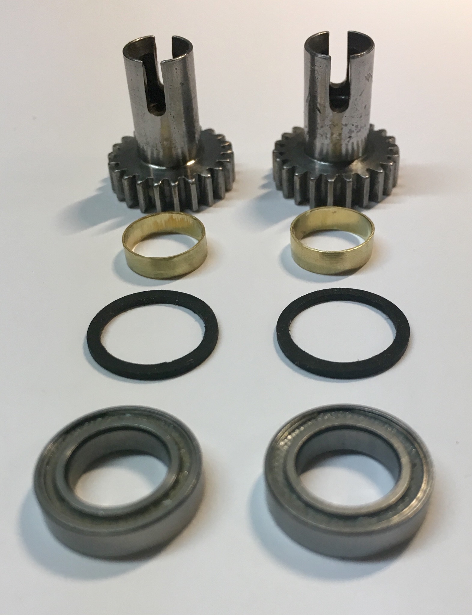

Just finished up rebuilding a six gear transmission following recommendations from the board. Spent a lot of time filing, polishing and adding the outdrive bearings. My bearings must have been a little narrow, I added a nylon spacer I made to get the bearings flush with the outside of the case.
What a difference, this thing is silky smooth!!!!
Thanks for the help!

Apart from the obvious benefits, the outdrive bearings also create a more effective dirt seal than the felt washers. I still have a six gear in one of my daily runners and it's very smooth and reliable.

So do you just remove the felt seals and plastic bits, file the bearings to fit, and pop the out drives in? Any modifications to the spine plate at all?

You can actually reduce the amount of modifications necessary, rather than drill out the case for the brass sleeve, you use a gutted bearing inner race Or drill out a bushing oversize in the small 5/16x3/16 non flanged position.

Your bearings are probably 5/32 of an inch wide. The nylon spacers you made to fit the outdrive bearings flush with the outside of the case is a good idea. I did the mod to my classic and was lucky enough to source bearings that were 10/51 of an inch or 5mm wide. They are an odd width but fit the case exactly without any spacers.
You'll see many people fit outdrive bearings but they don't sit flush with the case, which can allow them to move sideways out to the screw or motorplate which still retains them but allows the outdrive to have a massive amount of sideplay.
