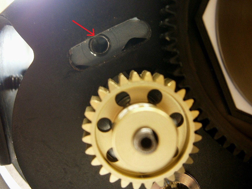

I opted to file the entire length of the upper top slot, it was quicker that way. Please note, this is my own experience. You may find, with other motors, that the mod is not needed. I have one motor, a Novak Ballistic 17.5 (hard to find now) that lines up perfectly in the motor plate slot.

Re: Brushless thoughts?
This is so very disappointing. We wouldn't need to modify our motor plates if the motor manufacturers would adhere to the established design norms. I seem to recall that the screw holes are meant to be on a 25mm bolt circle. Reedy, of all manufacturers, should know better.
Ok, I'll admit, I was ready to cal b.s. on this one since I have had many different brushless setups in my goldpan test car. I have never attempted to put a reedy in it. So I grabbed up a few brushless motors and 4 vintage gold ano motor plates and did some testing. Nomad Racer is correct. All other motors, ebay el cheapo, gool rc, novak ballistic, traxxas velineon----all fit right up, but the reedy mach 3 has a slightly bigger bolt hole pattern. I love Reedy motors and use them exclusively in my B6 turf racer. All I can say to stick up for them, is maybe they were not thinking about the vintage market when designing these motors. All newer cars have 2 horizontal slots so the hole pattern is not as critical.
Thanks for posting that pic. I too would have thought a motor from reedy would have just fit right in.

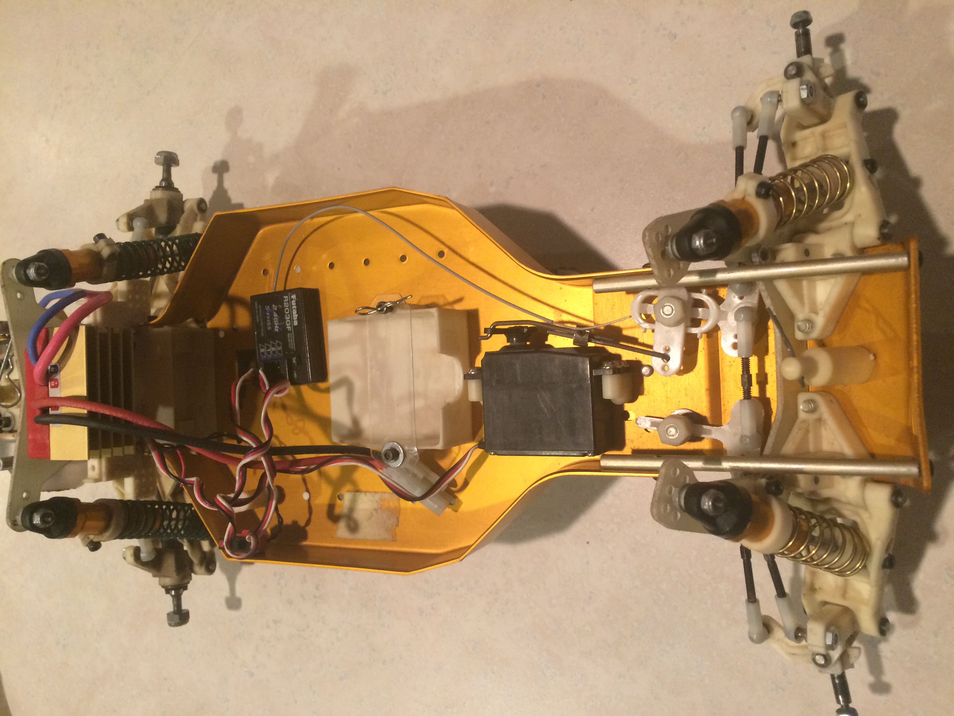

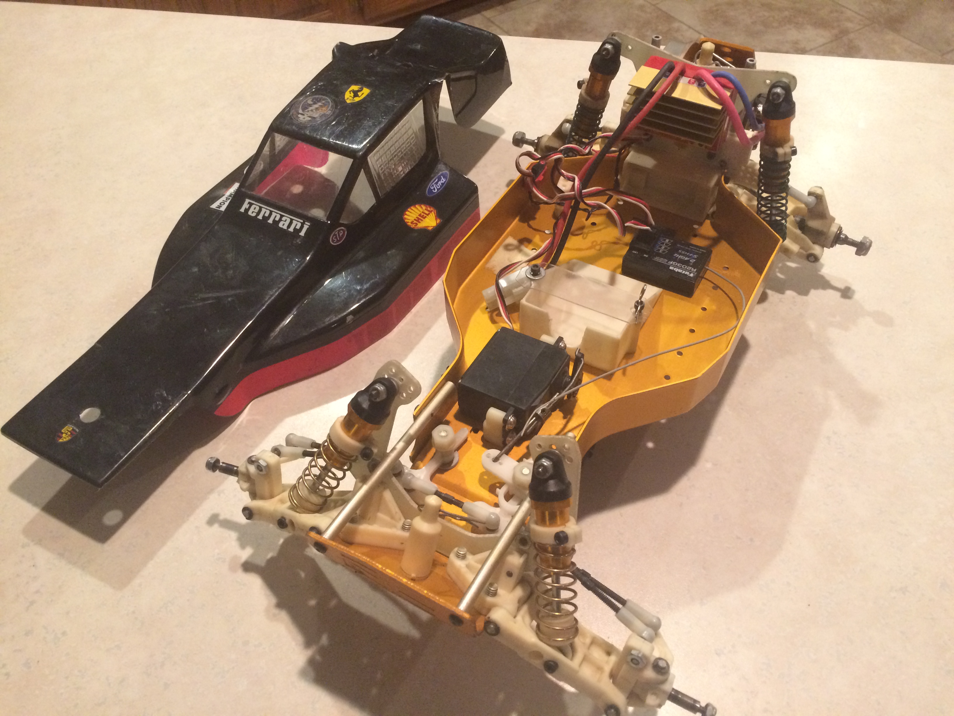

Are you setting up this car for a vintage race class or just bashing around? While I'm at it, how about some pics of it? We love pics around here.
oh im just having fun with this. it's a backyard basher. although i recently found a carpet offroad style track about 30 min from the house. its tempting but they dont have a vintage class. said they don't have enough interest in vintage yet. their biggest class right now is stock 2wd buggies so it would be fun to race with this. although im afraid i still wouldnt stand much of a chance. We went on an open track night, rented a sc truck and played around. that was fun. but last weekend they had their biggest event of the year and we went for bit to watch. i was really impressed with the buggies.
anyway heres my restore thread. as much as i want it done now it'll be a slow process for me. dont really have a plan of what i want to do. car has been sitting for some time. starting with general maintenance, rebuilding shocks, id like to tear down the transmission and rebuild with bearings. id also like to swap the bushings for bearings. maybe update the steering mechanism. and of course i need more power so i will be installing a brushless esc/motor. I'm sure theres more but thats all i can think at the moment.
https://www.rc10talk.com/viewtopic.php?f=35&t=43182
